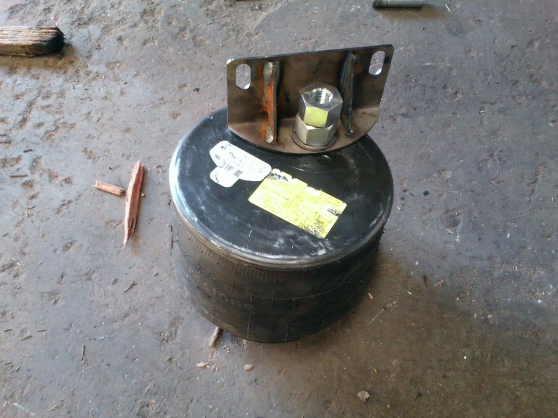

    Some more 12 gauge products it looks like :)

    :) Actually, we measured this out and had the local metal supply shop cut it and bend it. They did a nice job.

    That's nice job they did. Looks like the 12 gauge one.
    You made it out of aluminum?

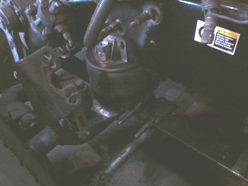

    I bet that rides really smooth with the bags up front! Was it all bolt in? Did you have to drill holes?

    I hear the front air ride system rides very good. I guess I'll find out when I drive the truck. I will have to drill two holes in the frame to mount the top air bag bracket to the frame. I will also have to drill the frame for the second upper shock mount. This kit uses two stock shocks on each side.
