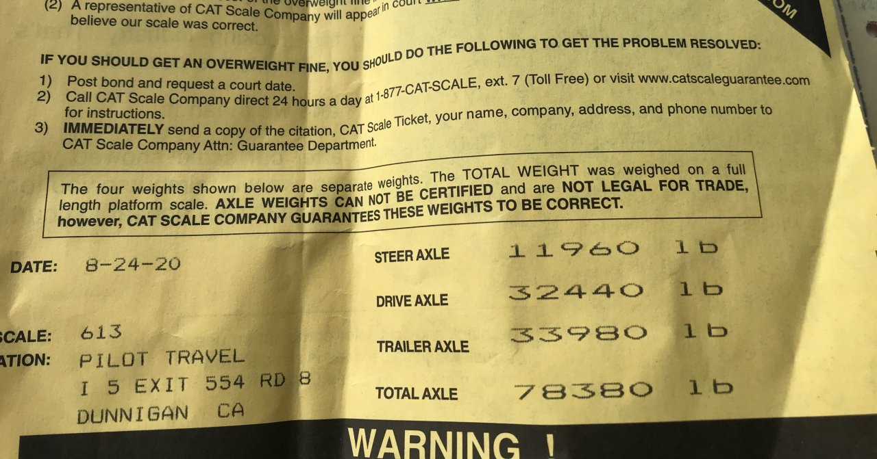

    C788D64B-715E-4CA2-A0F1-28D99926EDD1.jpeg Pin is on the 10th hole. How do we fix this to run legally? What’s anyone strategy? Had to roll early mornin’ to the Nevada border while them DOT dudes still sleeping.

    My fuel is on the 3/4 level mark and reefer fuel is half level mark.

    Guessing your load gross is 45000ish?

    Mar 24, 2020
    a little less than that

    Looks perfect to me.
    Or is it the trailer pin to tandem wheel base that's the issue?
    If so, I've fixed it by hopping in the back and moved a few cases of product up to the front of the trailer.

    Mar 21, 2020
    As a general rule 6th hole is safe, and each hole is 250-400lbs you could have potentially been able to move forward 4 holes.

    Coal Town
    Looks good to me but, if your scared run half fuel tanks.

    Mar 24, 2020
    yeah, trailer pin to tandem wheel base distance posed a problem when you’re in California. Trailer had already sealed, only way to hop in the back is to take it back to the shipper and reposition and re seal

    Mar 24, 2020
    im more concerned of the distance between kingpin and center of rear axle assembly on trailer. Was told that in Ca, I can only go as far back on the 6th hole

    Coal Town
    Do you know how to measure your trailer to find the right hole. Some trailers have a 40' marker with an arrow. Does your trailer have that on it?
