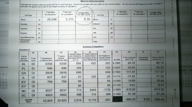

    I installed the MicroBlue Wheel Bearings on my tractor in June 29th, 2011, did both rear ends with MicroBlue in July 30th, 2011, did motor main and rod bearings December 7th, 2011 and replaced tranny with MicroBlue treated one December 28th, 2011.
    Here is the gains from each change and I do alot of dedicated runs too.
    MicroBlue Wheel Bearings (tractor 3 axle only) = +4/10ths mpg
    MicroBlue Rear Ends (x2) = +8/10ths mpg
    MicroBlue Tranny (13 spd) = +1/2 mpg
    mygauges.com under "Dice.s Truck" and "Dice.struck2012" has detailed results.
    Here is my 2012 first quarter IFTA that is up to 9.16 mpg compared to January 2011 my fuel mileage was 6.33 mpg that is not all MB, but I did a couple of other mechanical adds that helped out too.
    More on those other adds in this thread: http://www.thetruckersreport.com/tr...ers/93751-cat-mpg-opinions-and-advice-10.html
    Keep us posted.
    Note: The ECM is not the best way or a very accurate way to measure fuel mileage. Always use the odometer miles vs gallons of fuel used to fill up (all the way).
