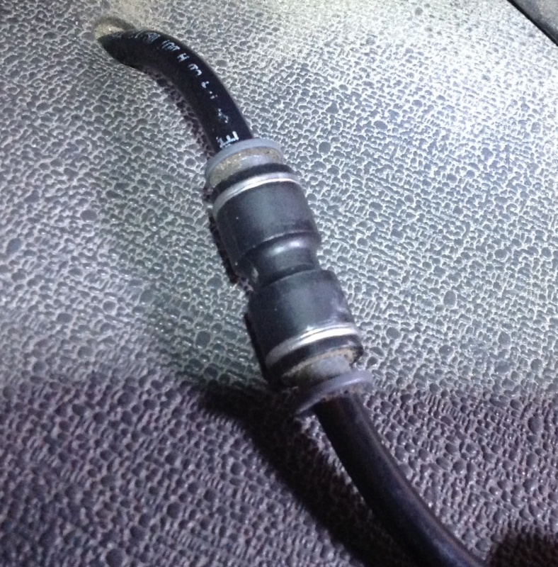

    I've got the seat all the way down and have been pushing and pulling on that connector, but nothing moves. Yet.

    Its like he said...chinese finger cuffs.....lol
    i always do one end at a time.....hold it in the middle and press in with your finger while pulling on the hose...
    When you accomplish this for the first time you will feel like an idiot since it is so simple...
    voice of experience talking

    Here is a better view of some other fittings. Youll want to push the grey ring in towards the fitting to let the line come out.
    FL uses these all over and they can leak so it's an easy fix to pull the line out and put it back in to get a better seal.
    Edit: pump the brakes or something to let some air pressure out of the system if they won't budge.

    Heres a a better photo of the connector behind each of the two seats. It's a 1-piece unit and nothing is moving, even with no air in the lines.

    You have to bleed the whole system, that hose supplies the seat with air. Until the tanks are bled down, there is still pressure in that hose.

    And, of course, just as soon as I write that, I try it again and success. I now have a blow gun installed. Performing leak test!
