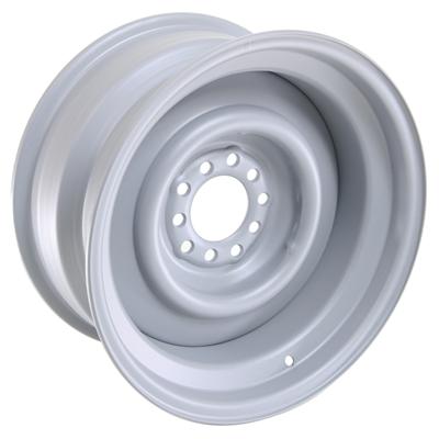

    I am only using my phone to view the pics, but for some reason the passenger (ditch) side wheels looks more like this too me. The top pic.. Solid, with no hand holes. It could just be the angle of the pic.? But is also what had me think you may be running a single 17.5" instead of duals..

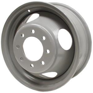

    Whereas the road (driver) side clearly looks more like this. The traditional 4 hand hole 16" dual wheel most of us hotshot hands are familiar with..

    Now I understand, they are 4 hand hole rims all around, just a bad camera angle.
