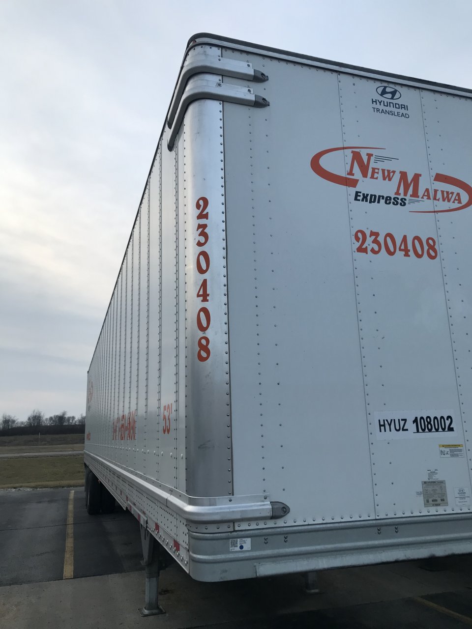

    If one is ordering a new trailer, spec upper and lower rub rails. They’ll save the skin. This is the best setup I’ve ever seen. Though, I’d do a full-length upper rail, too. And, these guys haul car parts.

    those are slick, i ain't never seen them..would be costly however for a large company, but right in line for an o/o to spec out.
    yes.. apply them all the way along the side of the trailer at the top, makes very good sense.

    Not costly at all versus the amount of damage. You can’t imagine how much damage repair our shops perform. Yet, we don’t have this rub rail system; we only have a lower rail. This means the shops are constantly repairing/replacing front corners, where they wouldn’t have to. It’s silly.

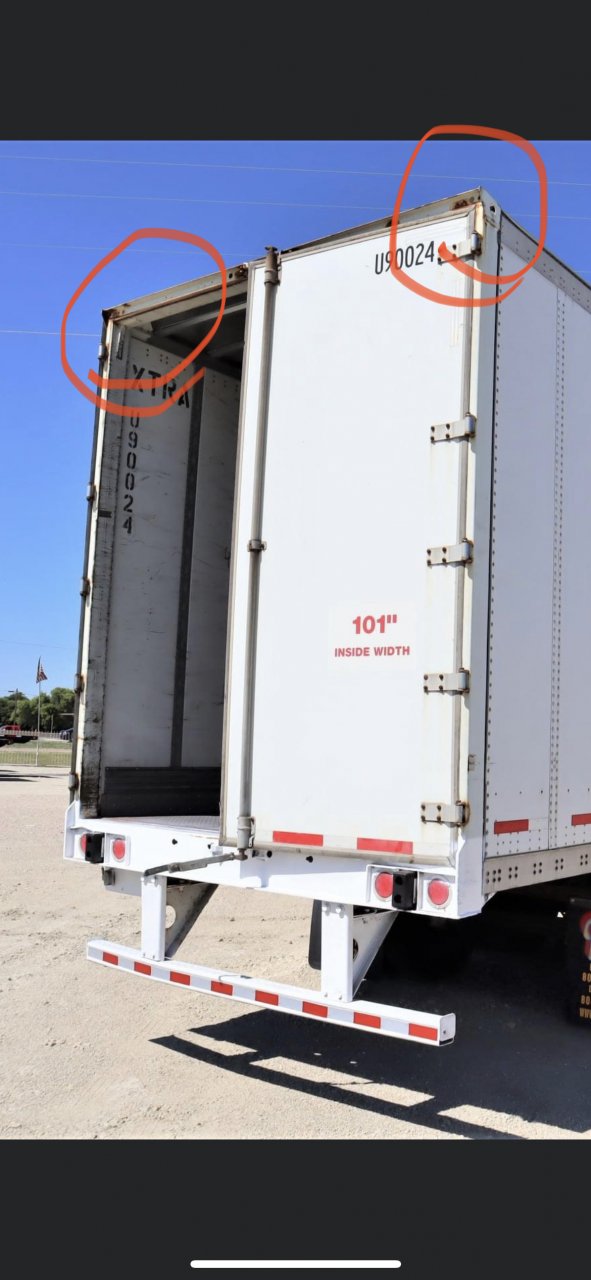

    See those corners that stick out? Those poke holes right into the top corner of an adjacent trailer. That’s the most frequent damage we see and a PITA to repair. Unfortunately, most drivers never look up there, during their pre-trip, which means water intrusion and rust/corrosion of raw parts.

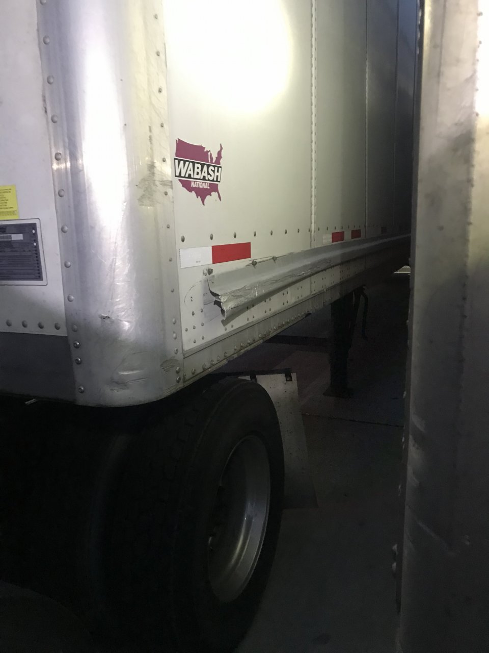

    The clowns would catch it from the end and peel it right off. See that lower protrusion in the above pic? This is what that piece does to rub rails. Like a can opener. The bullnose casting is lying somewhere around the property. I didn’t see it.
