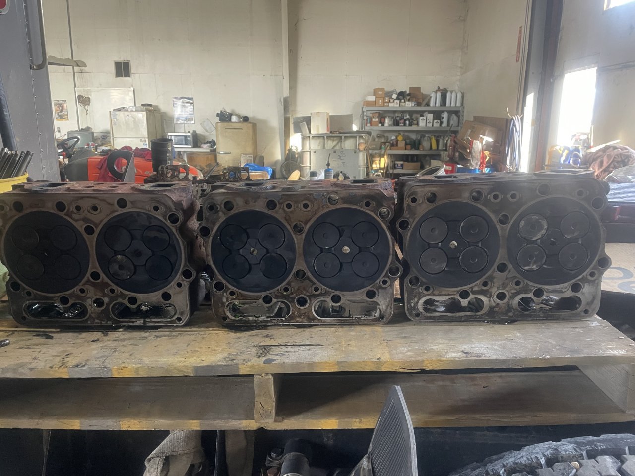

    1,3,5 and 6 are scoured down into the rings. Liners don’t look near as rough as the pistons. Rod bearing don’t look as bad as I thought. Pulled 3 main caps and they look and feel ok. I didn’t see anything indicative on the head gaskets but I’m not necessarily the mechanic y’all are. Nothing looks damaged at the valves. I’ll try and get the liners pulled this week.

    Those pistons look like ###
    Bearings look surprisingly good for how much junk has probably been floating around in the oil
    Did it get hot?? Seems odd to have that many pistons looking that bad. Also thought they had gone to 2 part steel top pistons on all n14s above?370? Hp
    I think I remember you saying this on was 460?
    Just judging by the soot on the bottom of the heads it looks like it was relatively healthy and I would be pretty certain the water wasn’t coming in above the pistons
