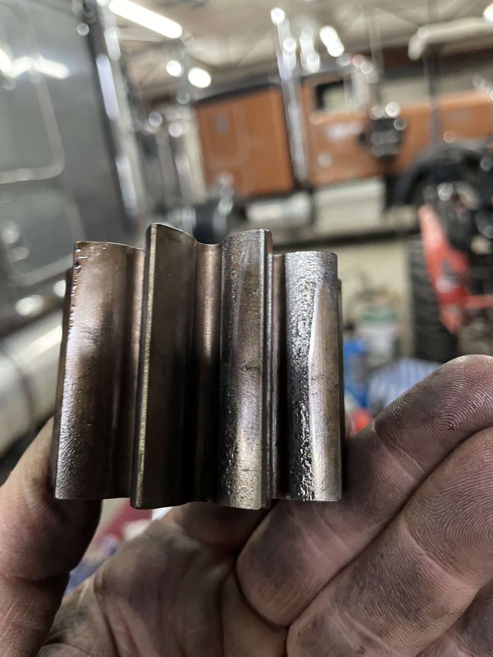

    Would you post some pics of the wear on the pump gears…i believe they had a bunch from the celect years that something on the fixtures was off based on the way they wear. It’s really not important one way or the other just a curiosity

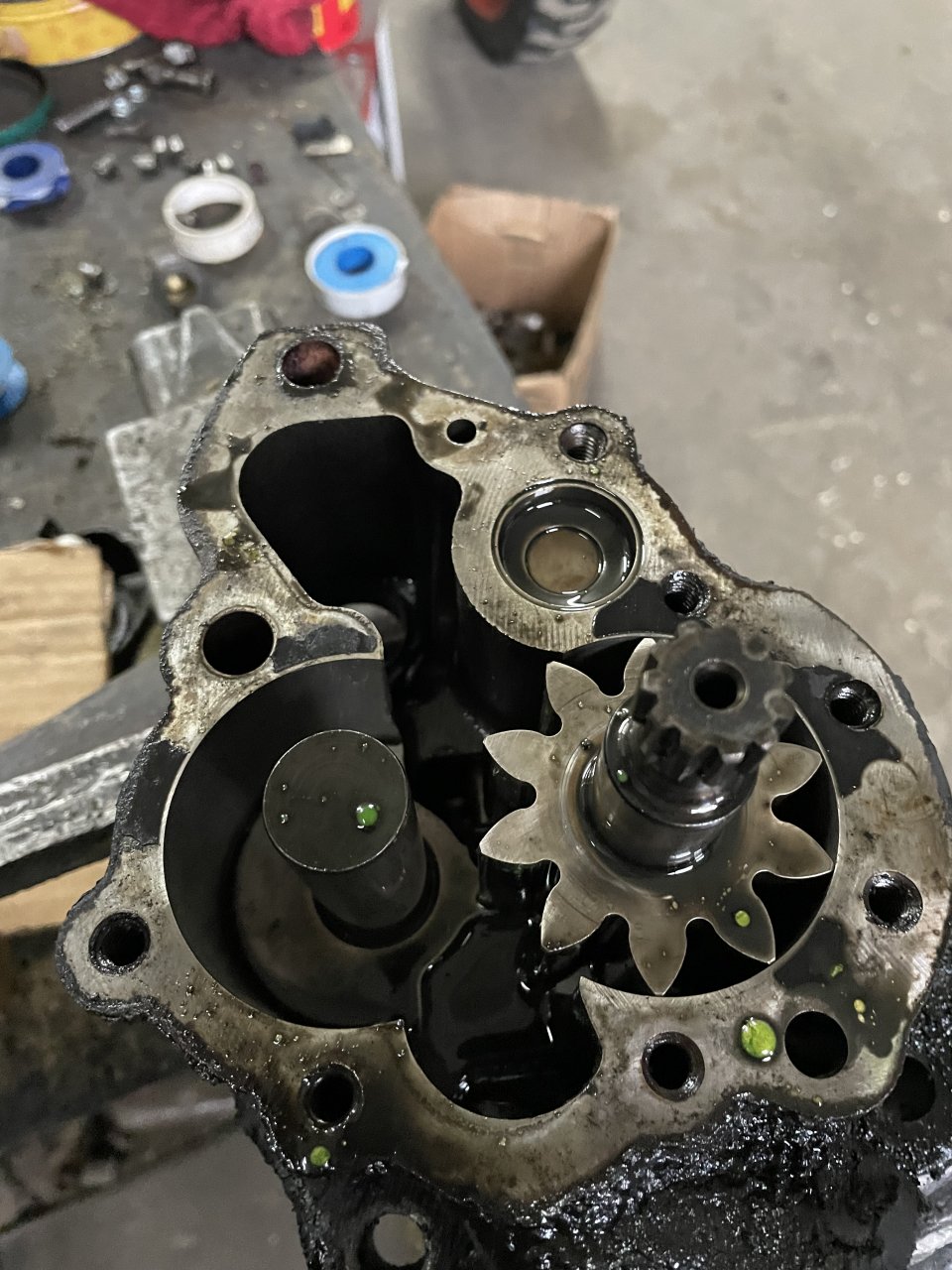

    There was a period where the oil pump shafts were walking forward and the first symptom was loss of P/S usually.

    I will but it’ll be this afternoon when I get back to the shop. It was mainly at the bottom of each tooth. As far as end play I didn’t have a magnetic dial to check it but just putting it in a vice and prying the gear with a screwdriver, it had to still be in tolerance .03-.05. Was really surprised at the lack of end play. I’d bet money, that this is the original oil pump. I’m gonna try and get the oil cooler/housing off too.

  10. mile marker 27
    mile marker 27 Road Train Member
    1,419
    1,739
    Dec 4, 2019
