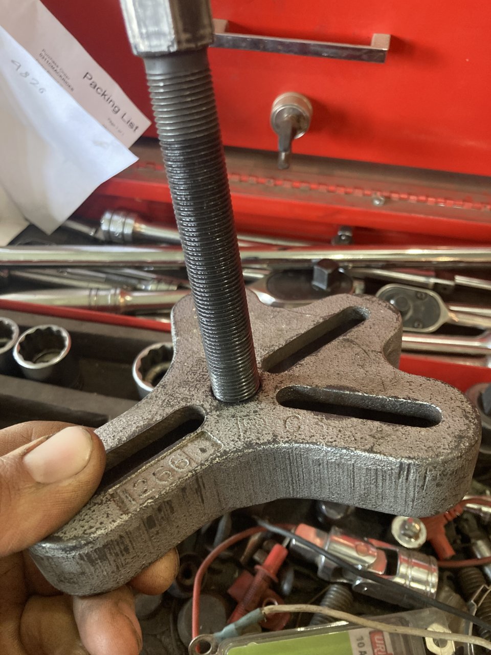

    Ok, took the hood off by myself this morning. Dam that things alot bigger than it looks, once you’re trying to softly put it on a pallet. Removed the crusty arse radiator and charge air cooler. A/C compressor is off, crank damper off. Now accessory pulley. I’ve got a puller I made for the small cam I did, if I can find it. I’m planning on replacing the front main and accessory drive seal, while I’m here. What kind or style of puller do y’all use for the accessory drive pulley?
    hasn't failed yet…been close a few times though occasionally the round key gets worn into the side of the slot and makes it a real pita to get off…seems to be most common on ih truck…no idea why though
    mile marker 27 Thanks this.

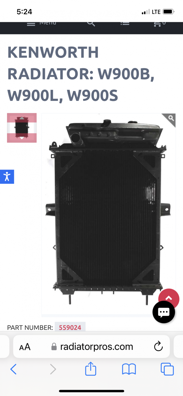

    IMG_5251.png Radiator is junk. Found some that look and measure similar but they are claiming, “No oil cooler”. Are they referring to the transmission cooler, that was mounted in front of my existing radiator or are they referring to an outlet to the engine oil cooler?

    If you can make the logistics work there’s a shop in west burlington ia that can fix yours…don’t want to put words in his mouth but pretty sure it will be a 5 year warranty. It probably won’t be any cheaper than other sources but I would almost guarantee it’s better quality. I send a lot of radiators to him usually farm and construction honestly don’t even price anything else just send it there…everything that’s come back has been absolutely perfect as far as craftsmanship and never any problems

    Yeah, that’s waay out of my way but good to hear someone can still rebuild them, that you can trust. Mine needs a new core, stands it sits on and the bolts that hold it down.
