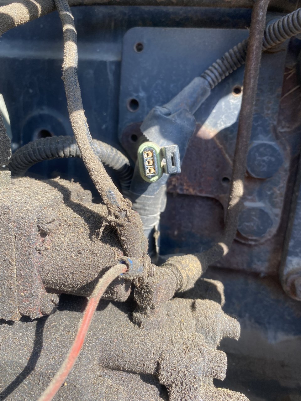

    So now I see what Pup was saying, I was looking for another round 9 pin type plug as that’s what I was told it would be. The weather pack above the fuel filter on mine has three pins for some reason

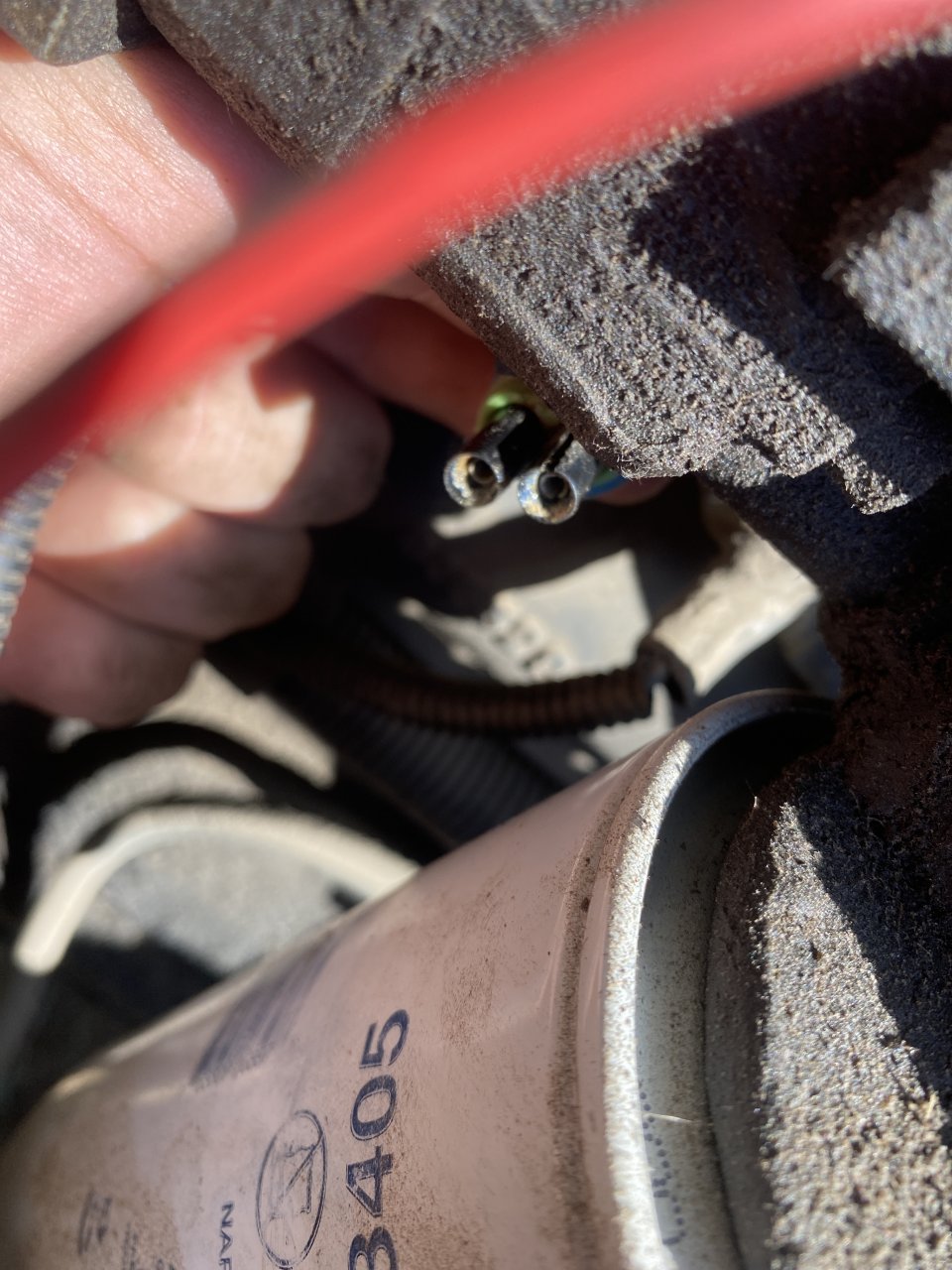

    Found this back behind the pump in a weather pack too

    The weather pack connector in your last photo is the one you want. The 3 wire connector would go to an ambient air pressure sensor if the engine had one.

    Bingo, found it. That other one was a Metri-pack 150 connector. Listen to @pup, he very knowledgeable.
