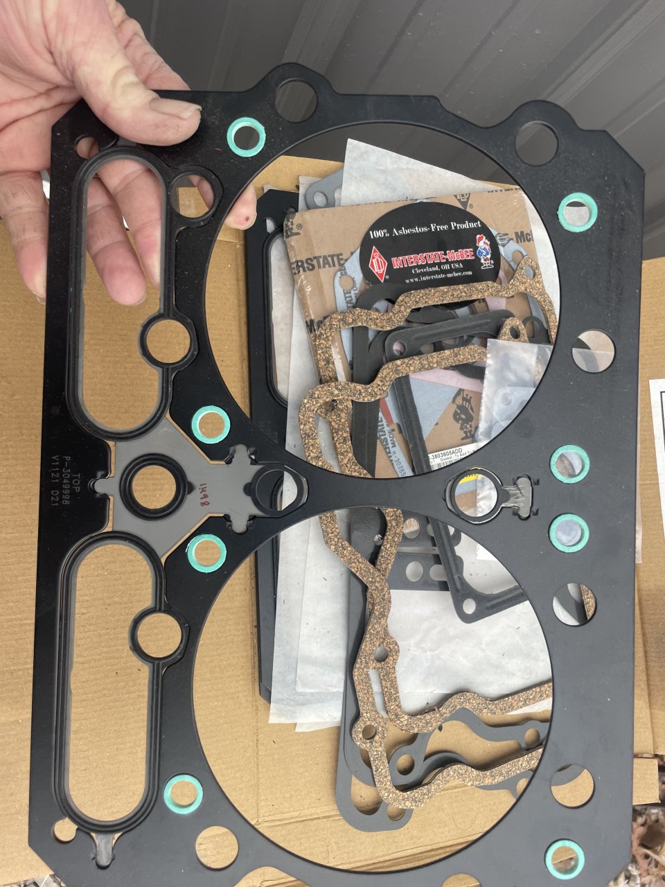

    I’ve used McBee and PAI, these gaskets that came in the PAI kit are the least desirable to me.
    If you don’t know the history of the engine make sure you look at the head gasket on the engine carefully, if the block has been decked it should have thicker head gaskets and the gaskets will be marked 0.010 with the part number. Gasket in the picture is a standard gasket….

    Last Call and mile marker 27 Thank this.

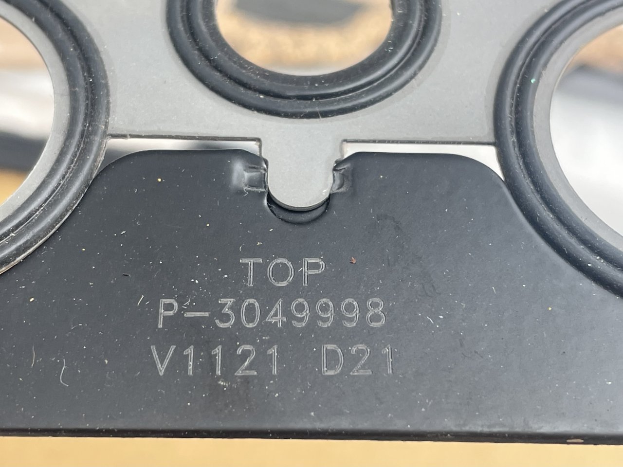

    If anyone would need the part number for the 0.010 head gasket here ya go…
