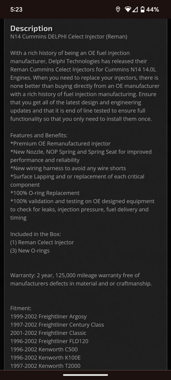

    I went with Lincoln Diesel Specialists I read a lot of good stuff about them and their reputation with injectors after a lot of reading and looking around. I think they are better known for Duramax injectors. However they offer N14 remans. I will attach a screen shot of what their website says. I like everything I have read and heard. Also price was like $380 something per injector all said and done with tax etc. They didn't charge or core or want my injector returned. I will give my final thoughts after installing.
