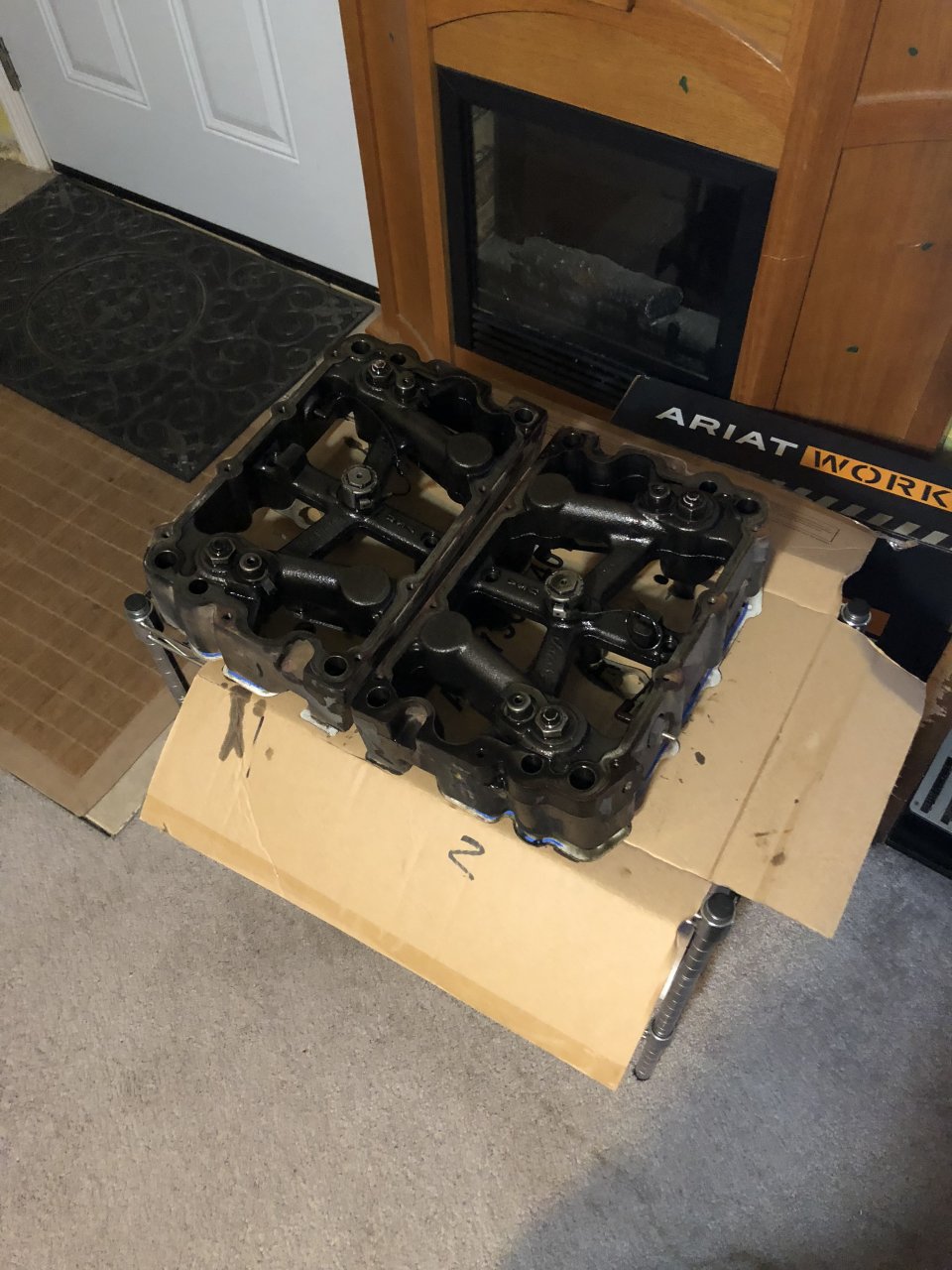

    View attachment 223639 988A0963-7BE5-41AF-8B84-ADD2C87A29C1.jpeg 988A0963-7BE5-41AF-8B84-ADD2C87A29C1.jpeg Ok so I finally got the gaskets. Had to go on a scavenger hunt today to find them. Need a 7/16 12 point socket to get the jakes off. Got them off, more tomorrow hopefully. Ran out of sunlight today. Ended up using a pipe wrench to bar the motor over.

  10. Dave_in_AZ
    61,498
    432,308
    Are the Jakes in the living room?

  11. HopeOverMope
    HopeOverMope Road Train Member
    1,801
    3,211
    Feb 25, 2016
    I-20 LOUISIANA
    Yes indeed.
