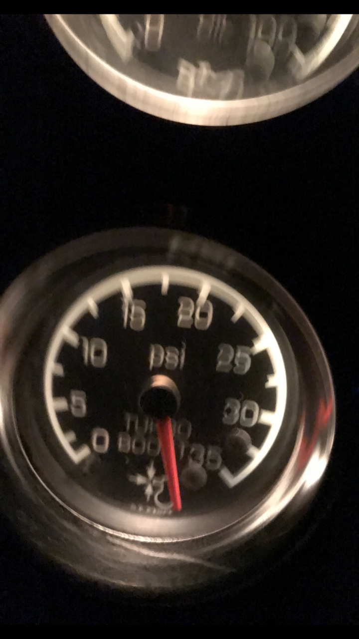

    On my n14 boost goes to 28, 2001 Volvo

    My ‘99 N14 500 horse will boost almost 40 PSI on a cool day.

    Yeah,my N-14 500 would do 40 psi easy,that's under a hard pull,you can't check it sitting still.
    If my boost was down,usually needed a fuel filter,and it would come right back up.

    Mine shows 22 psi under wot and sometimes it will go up to 25 but thats it.

    Black top? My Red head will pull 35 psi.

    Check all your intake manifold hoses and clamps first,if ok pressure test your intercooler.

    Can’t really compare the M11 on a pull it probably has a different rear gear. Used to have a 1995 460 red top with a 3.90 currently have a 1998 370/400 M11 with 4.33
