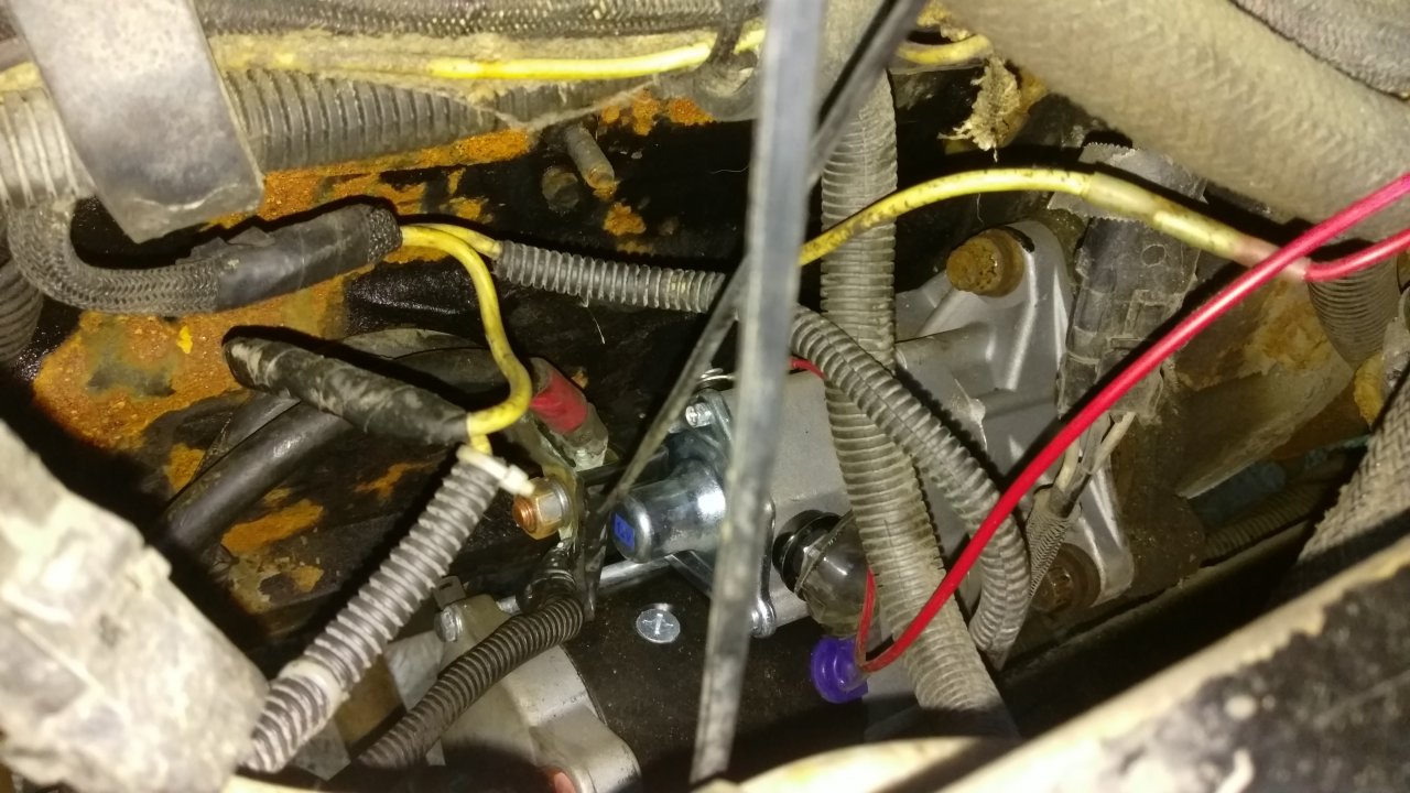

    I have an N14 Celect in a '91 Pete. Bought a brand new starter, get it installed and the bloody thing won't engage the flywheel. I can hear it slightly kissing the flywheel teeth but that's it.
    My question: Do all Cummins class 8 starters interchange? I was under the impression they're supposed to.
    Could my problem be a clocking issue? Three bolts total. IMAG4501.jpg IMAG4490.jpg

    For a reference here is the nose of the old starter.

    There is different teeth count on the starter.
    Make sure you got same one.

    New one is out.
    New one has 10 teeth
    Old one has 11 teeth
    Thanks Swan!!!

    When changing to the newer style starter, do you need to remove the spacer on the nose cone?
    I'm asking, I don't know.
    I remember when I changed mine. I had to install it twice because either I left the spacer out or I put it in and it wasn't needed. I forget which.

    The new style gear reduction starters go in as is. No swapping nose cones..
    The only thing you might have to do is clock it so the seliniod is on top or bottom, depending on how your old starter was wired.
