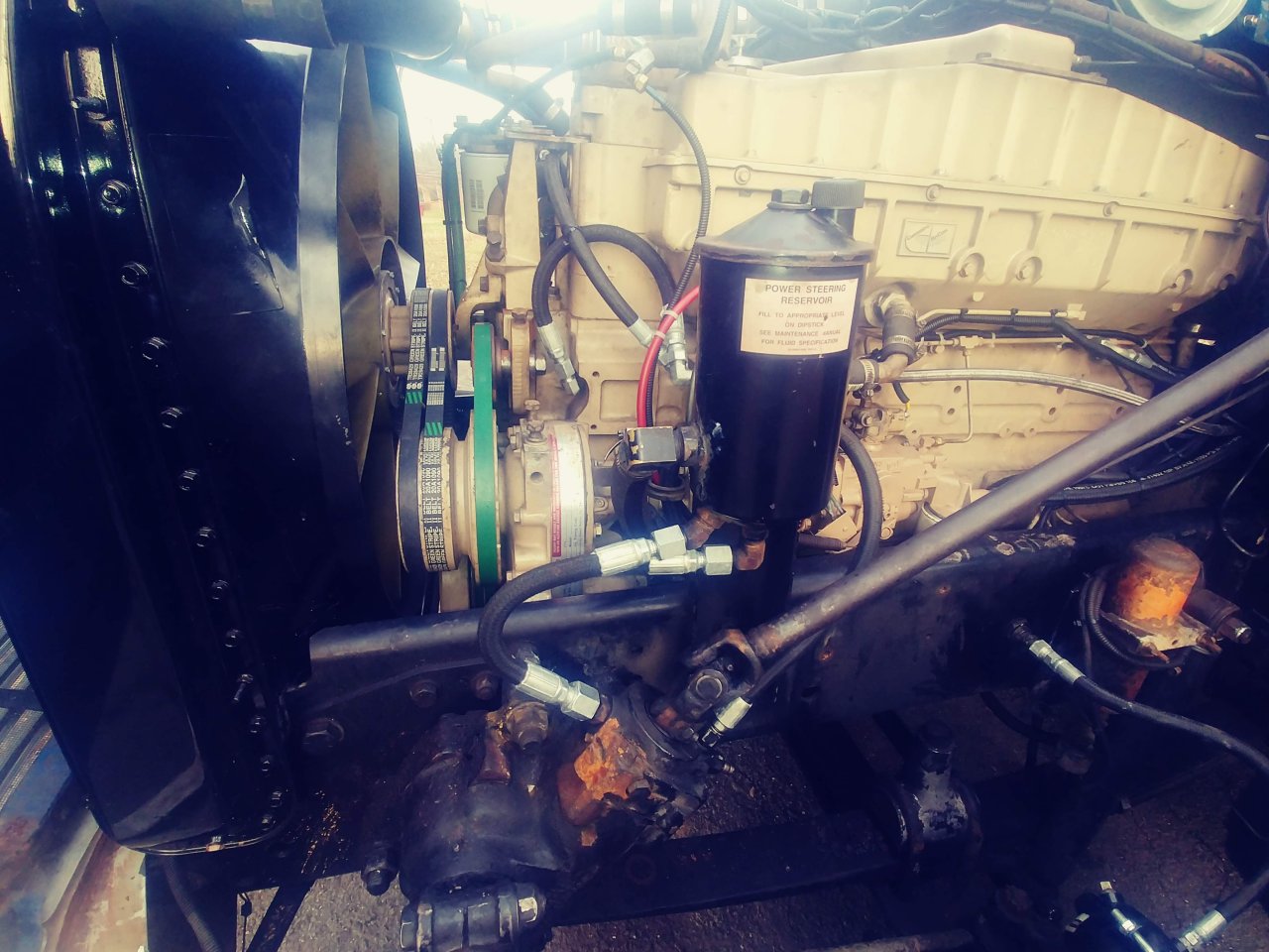

    Is the block the same on a big cam and it just looks different because it has a onepiece head instead of 3 piece.

    I think what your looking at is aftercooler? Instead of cmcac. Still has 3 heads
