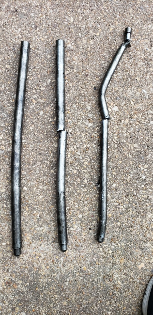

    Quick update, currently tailing the driver on the way to the shop. Holy crap the carnage, exhaust and injector push tubes for cylinder 2 were in pieces with the bottom of the exhaust suspected to be in the pan. Cylinder 1 injector pushtube was bent as well, removed and replaced. I suspect that this has been the cause if the knock all along as the cylinder 2 knock us gone and cylinder 3 has an apparent knock, push tubes all around I guess. Drivers limping it home the 150ish miles and I'm pulling the followers tommorow in the PM.
    Edit: Truck is in the shop with no new windows in the block or loud clanks. I've got a feeling the issue has been bent pushrods this whole time, I'll be pulling the rest tommorow to make sure as well as dropping the pan to find the missing piece.

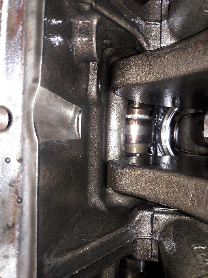

    Dropped the pan to see this on the number 3 injector lobe, looks like something got caught between the follower and cam. I cant see anything embedded in the cam and I dont think it's made it through the hardened layer because it isn't flaking, run it or replace it?

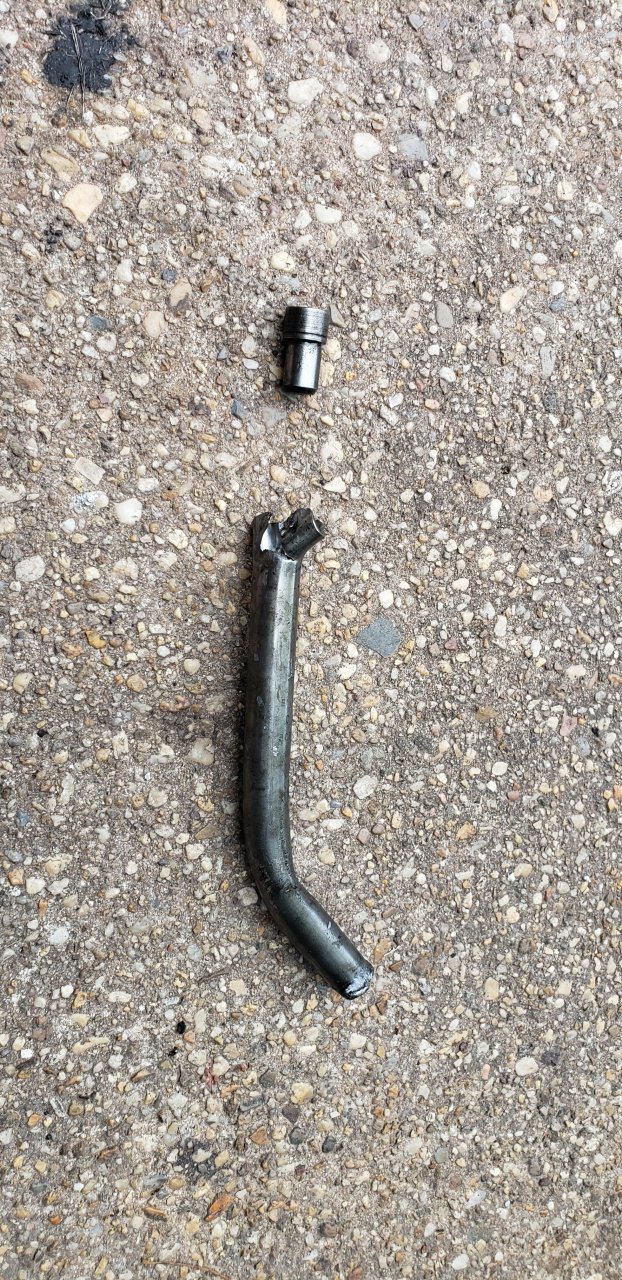

    As promised, pictures of the bent pushtube and ensuing carnage. 20190913_161051.jpg
    This little guy spent 200 miles in the oil pan after what looks like being sheared in two by the broken injectector push tube and then wriggling it's way behind the follower. Strangely enough, the rocker end of it is literally split in two. 20190913_161125.jpg

    Thanks for pictures and posts

    The tip of the cam is where are the cool stuff happens. It’s hard to tell from the glare on your photo. It may have just got scuffed a bit as the parts that wanted into the pan made their way that direction. But if theirs any damage to the tip of the lobe or any scratches on the cam follower roller. Your better off getting it replaced now. It won’t take long for a scratch on the roller to exponentially multiply!!!

    20190913_100414_1568383504418.jpg 20190913_095638_1568383014095.jpg 20190913_095545_1568382957953.jpg
    Since it's the injector lobe that's damaged, would I be looking for damage in the transition areas between the inner and outer base circles? Or would the tips be the bases of each respective circle. Its not missing any metal from what I can tell, didn't catch a nail when I tried it, rotated it a few times to get a good feel for it as well. It mostly looks like it's been polished if that makes sense, no grooves from what I can tell either. I'll try to get some pics of the follower with the inspection cam tommorow. Thank you all for your help and patience with me.
