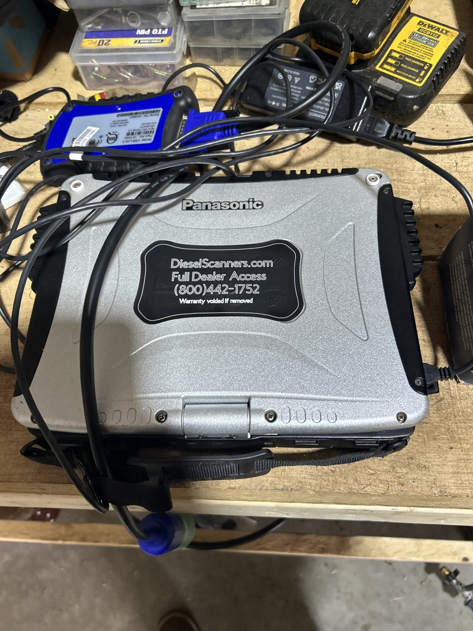

    IMG_3836.jpeg One and done no subscription fees. Address and phone number are in the pic. Full dealer access

    You don’t need yearly updates unless you plan on opening a shop and plan on working on trucks that are new model years. The draw back to mine is 27 and forward it won’t be compatible if they change software. On a 12.7 or 14L that’s not going to happen. As far as pirated software, well DD can gfym

    Diesel Scanners seems to be one of the easiest ones to understand. So it can work on older(my 96) as well as newer...newer to me is like 2004-2016?

    It will do everything from 2026 and down. Cat, Cummins, Detroit. As we as several equipment manufacturers. Also does ford,gm,dodge. Also has Jpro. So you can diagnose many others.
