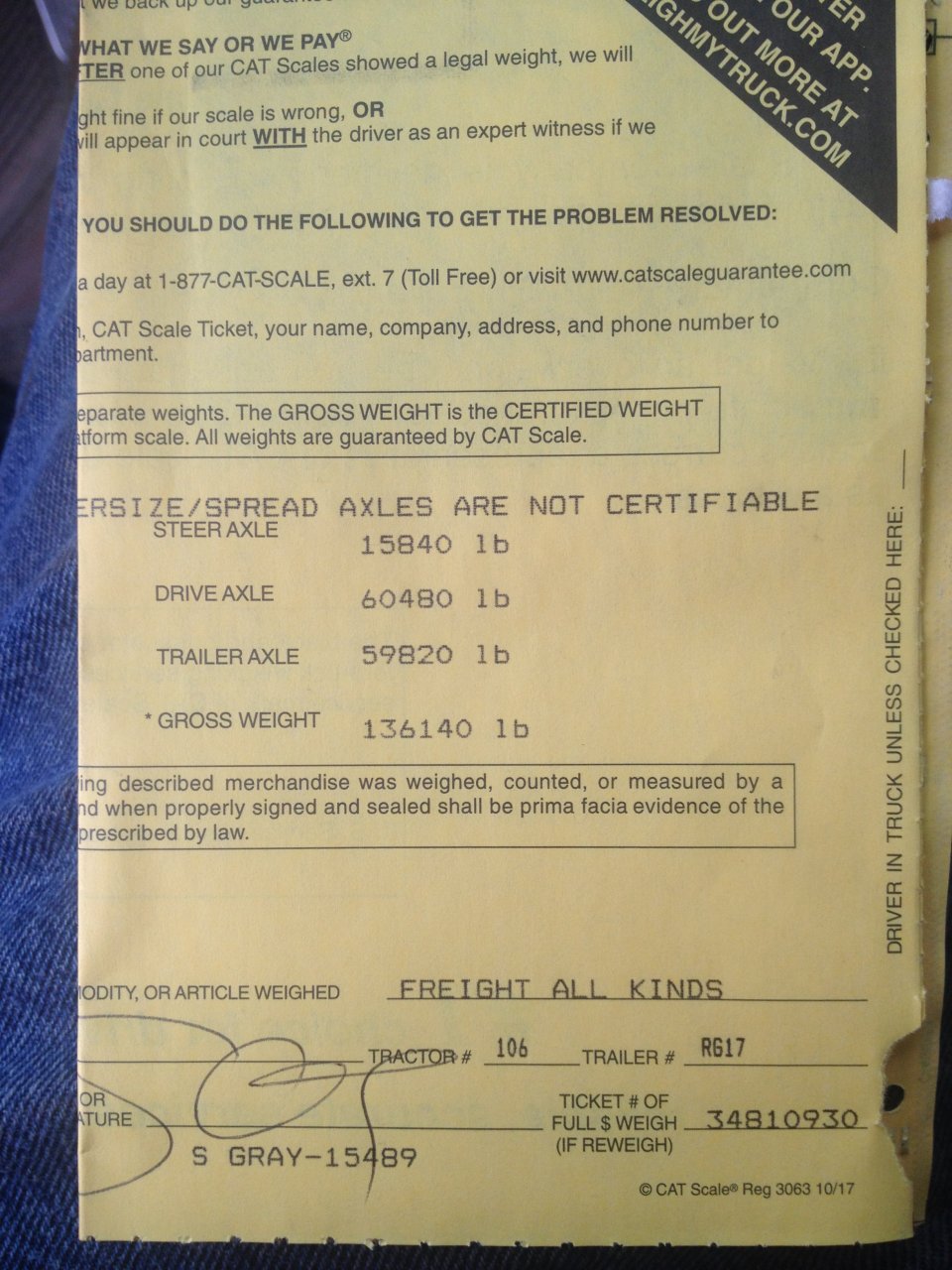

    I have an overweight permit for Texas so I loaded it up tonight.

    FFCEB7D2-CA2C-4DB5-AECD-866B7F3D2030.jpeg How do I fix this one?

    Same thing that fixes everything-
    Darkness
    Or
    More axles....

    You'll burn it off in fuel.
    Slide 5th wheel up 2 notches. Take your steers up over 12 and not worry about drives.
    It'll also make both axles more even on weights. And you'll be able to load a little more if you can and want.
    Rockdoctor Thanks this.

    This is a screwed up load.
    So if I slide my trailer axles that will take the weight off the steer,right?????????????????????
    Or should I go back and get the load re-worked? ????????????
    This trucking is hard work. Lol

    Roll with it driver. You're under gross.

    You got a fat gal with ya? Kinda heavy on the steer. Tell her to slide the seat back two notches
