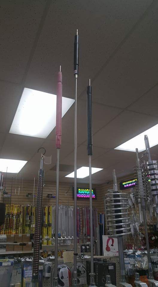

    The funny thing is Bob wouldn't know a decent antenna if it smacked him in the face and he's got several in his shop he just doesn't recognize their potential
