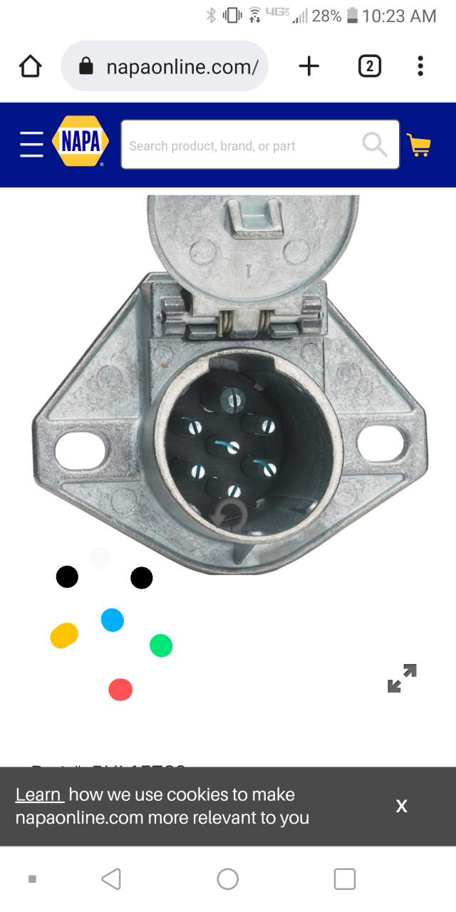

    Ive never used the 7 way tester before so i cant comment on how it works... You can do the same thing as that tester , with the test light.. Just clamp to a good ground. Like the shock bolt or fuel tank straps bolt. and then stick the probe into the truck plug brake light probe and see if it lights up.. The brake lights are on the bottom.. This how plug is routed. Brake lights are the red. Green and yellow is left and right turn signal.. Blue is abs. Black and black(should be brown on right but i dont have brown color of photo editor) is marker/clearence lights. White up top is ground....see picture below
    Use your test light to probe the bottom pin on the plug and if it lights up then the brake lights are working properly on your truck... If that is the case then plug in the cord to truck side of plug then use test light to probe the trailer side of cord... If this works then the cord is good... Plug into trailer and see if the brake lights work on trailer. If not then the problem is on trailer side .
