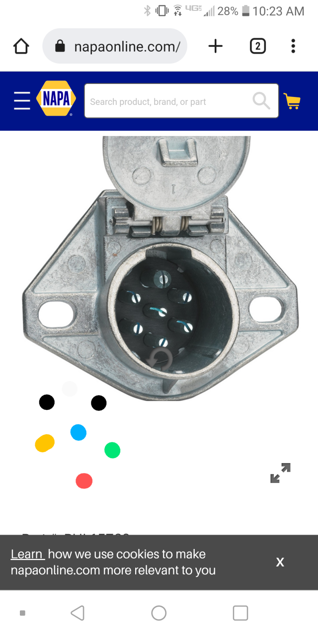

    The plug on the back of the tractor maybe? You replace the cord from there to inside the cab. What about the double male receptacle itself? Could have a broken prong. Wiggle them. Loose? Unplug both sides, using a small wire, insert into the pigtail red wire hole plug it in, do the same for other side. Jumping the whole receptacle.

    Replaced the recepticle when I swapped the cord.... And now I keep and extra one with me somewhere in this truck?
