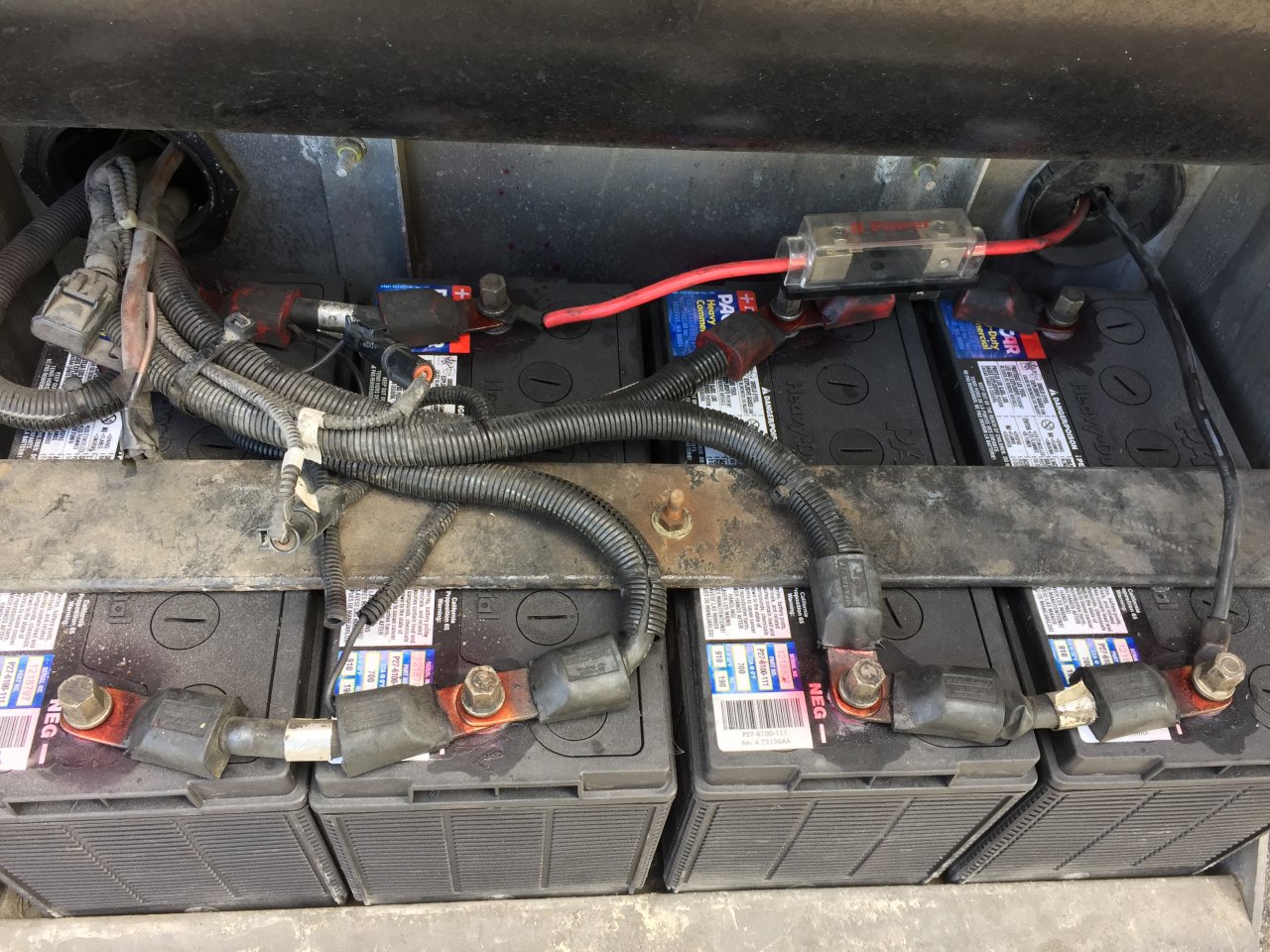

    Trying to get more juice when the truck is off. Seems like my fan and my 40qt cooler drains my batteries in the morning. They are all new. Can I run these in series? 2003 Pete 379

    Why would you want to run them in series for 24 volts or more ??

    No not for 24V I have a high output stereo in my truck and run 4 batteries but I'm still on a 12V system. Figured I can do the same here but not sure

    if you connect them in series you add the volts, so if you have 4 - 12 volt batteries connecting them in series you'll end up with 48 volts. So no you don't want to do that.
    If you are draining your batteries you may want to invest in a bigger generator(alternator), or perhaps an a.p.u. system ,that will come on if the batteries are getting low.

    Yea the APU will be bought. But can I do the 4 in parallel then?

    They should already be in parallel if they where factory installed. If they aren't yes you can.
    Till you get an A.P.U. you either have to idle your truck part of the night, or turn your cooler off when you turn your engine off.

    What you may want to look into is new batteries.
    What you should be looking for is a high reserve capacity battery

    Some other items you may want to look into is the battery cables.
    Corrosion on the terminal ends usually means that corrosion has also moved up into the cables. Battery connections have a few inherent problems. One is dissimilar metals, lead, steel, copper and aluminum all contribute to galvanic corrosion. Add that most battery terminals are not a gas tight seal, leading to vapor escape and chemical corrosion.
    May be a good time to replace them.
    The other thing to look into is your alternator. While it may be working, is it putting out the power your systems need to fully recharge the batteries. As brushes wear plus cycle time and heat on the diode bridge you may not be getting a solid output from the alternator. Most newer units have that and the voltage regulator built into the alternator.
    If you have low voltage feeding the alternator field, then you will get low output from the unit. It is not uncommon to put a volt meter to the system and see a good voltage reading. The problem is no force behind it, no amperage. That's what you need to get a battery charging.

    If you have good batteries, clean cables, and a properly functioning alternator. You won't have to fire up the truck.
    If you have to fire up the truck during a 10, You've got bad batteries, alternator not charging completely, or corroded/loose cables. OR, there's only 1 battery in the truck, or 2, or 3, instead of all 4.
    I can run the fridge for 24 hours in the middle of summer before having to fire up the truck. That's when the shutdown shuts down. Shutting down all electrical leaving enough juice to fire engine up.
