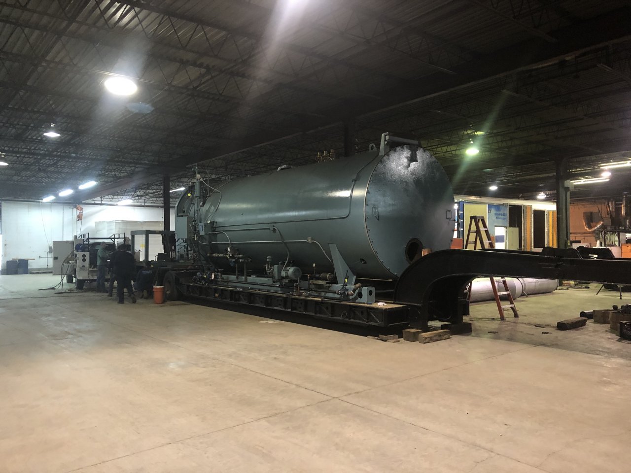

    Here is a picture of the trailer. I’ve done told them that if they keep on adding crap to it, we aren’t going to have enough axles. They’ve done tried to add a tank on the back that made it 15’ tall. I told them we could make it work, but we’d have to be routed everywhere we go and have to run a height pole.

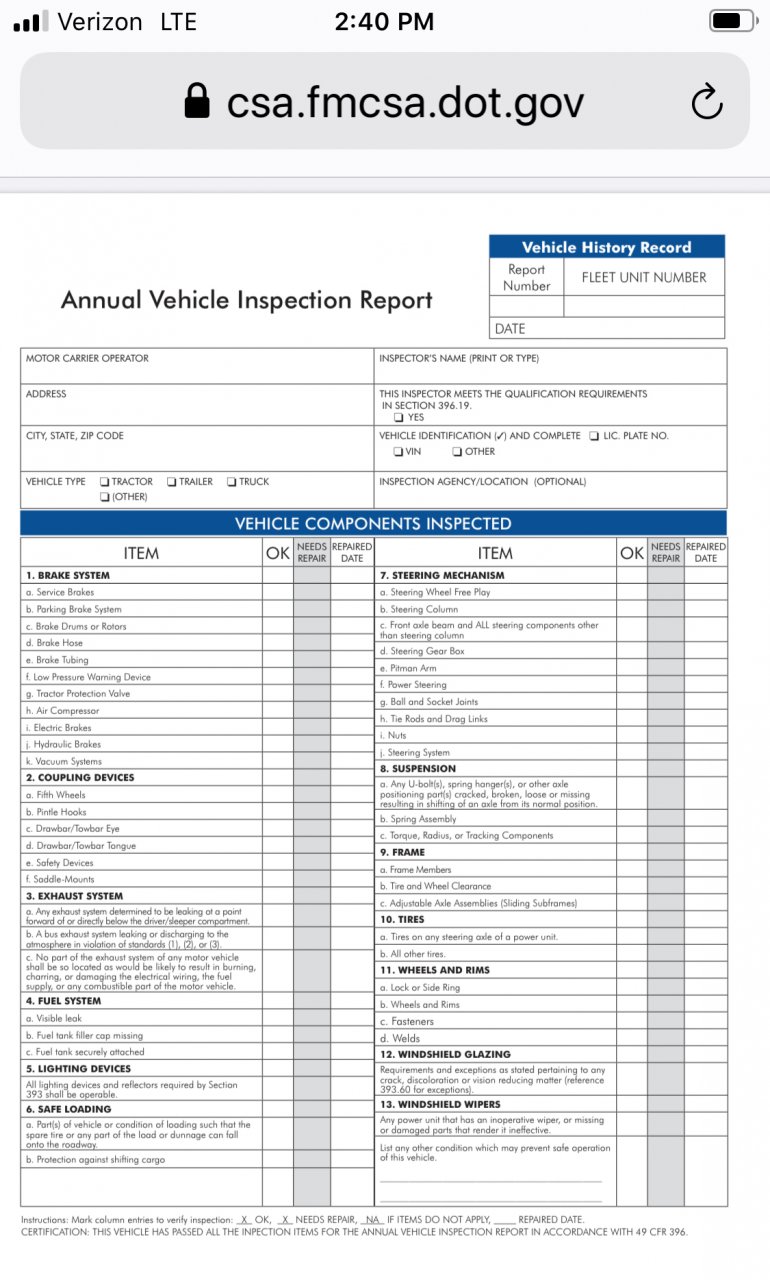

    Yes you need an annual inspection on a trailer.
    Notice on the FMCSA form where you would select TRAILER.

    That's a big boiler...
