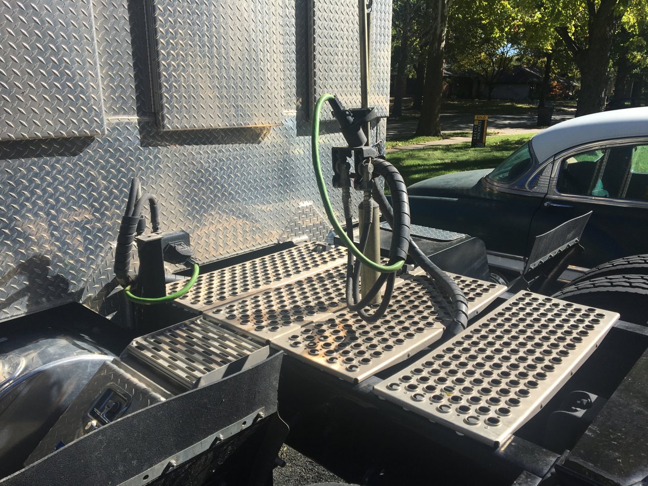

    Not a very good pic but it was pretty level and I may have a different catwalk?
    I also wrapped mine to match the trailer
    4 beers and a couple bucks worth of vinyl

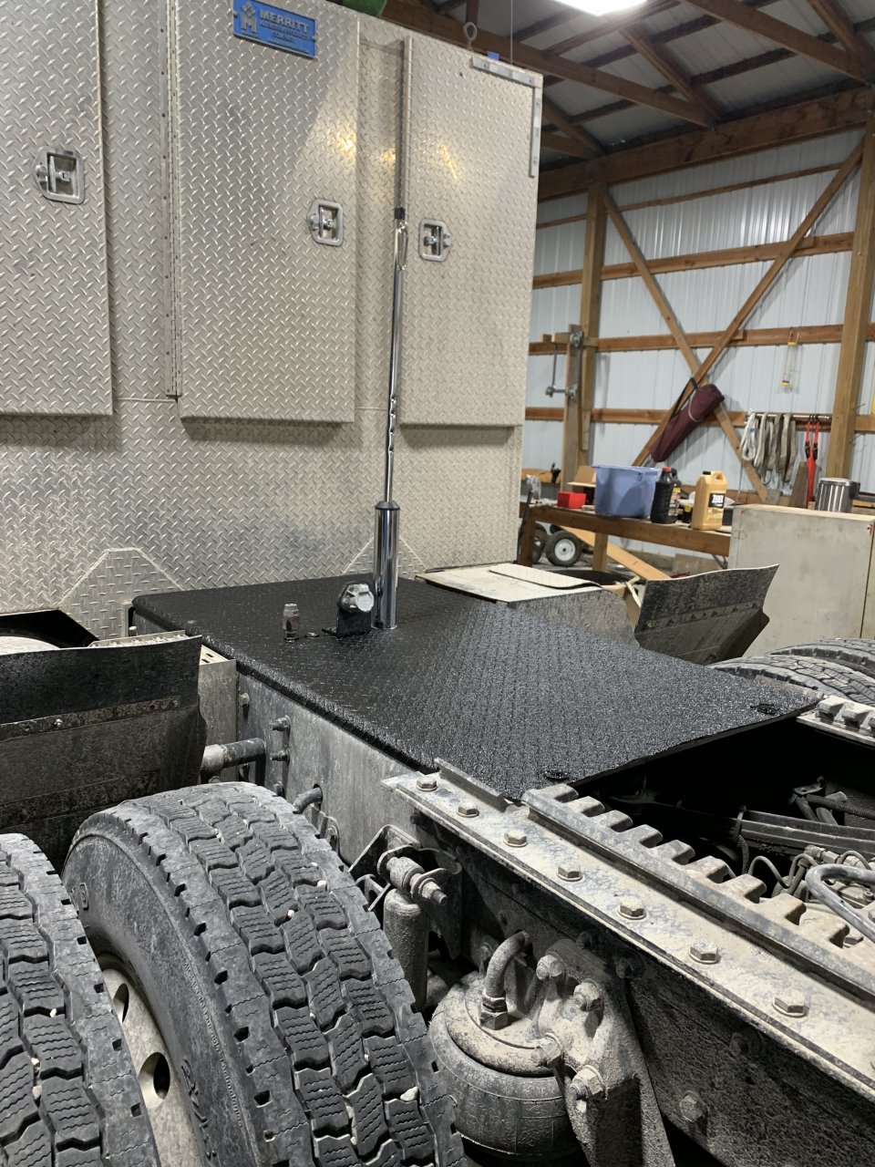

    the upfitter hacked big holes in the stock catwalk. I shaved the apu mounts down a bit and eventually the mounts rubbed through the new catwalk. Bed liner over everything took care of that issue.
    71207D7D-4953-400E-9A07-A9EBBD876692.jpeg F77494B9-A67A-49CD-B791-2F9402A5AF1A.jpeg 4A62CBA4-444B-48A5-8BE2-81699863E5D9.jpeg
    your only option is to drill holes in the frame. The back of the apu has bolt slots.

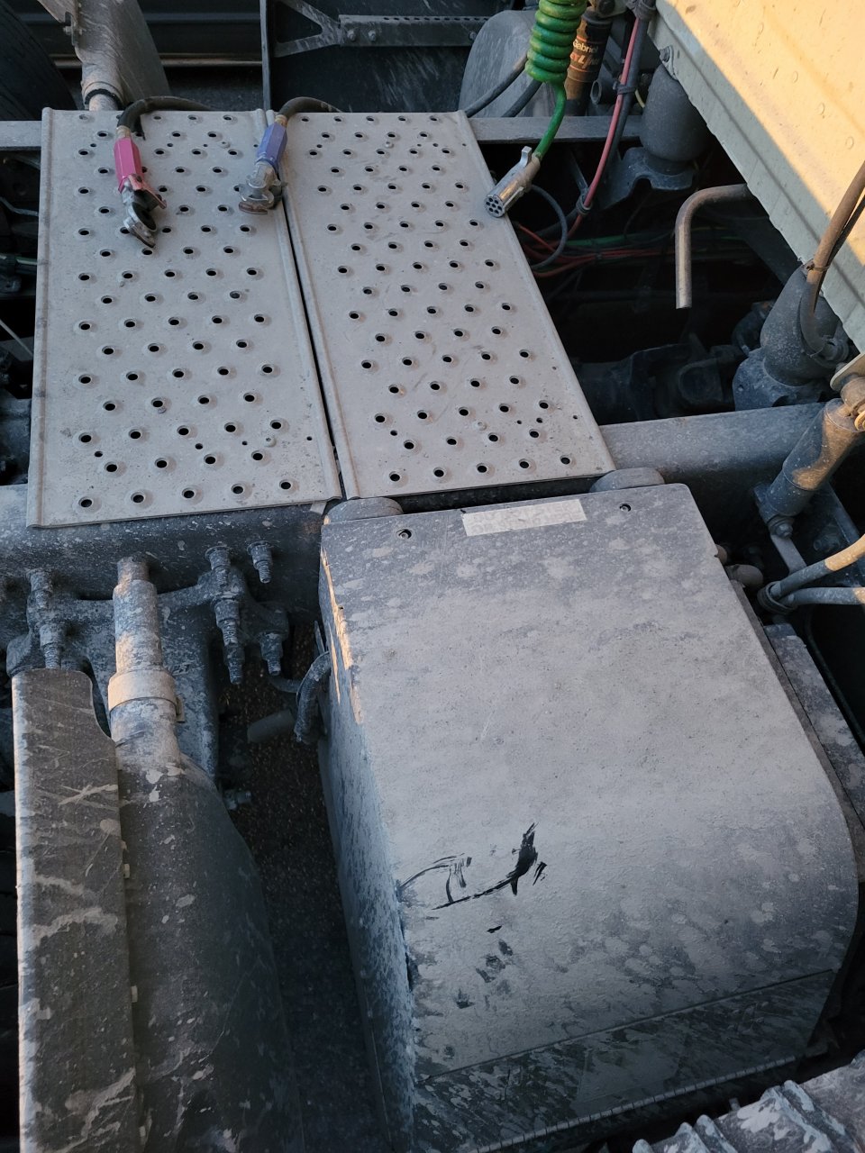

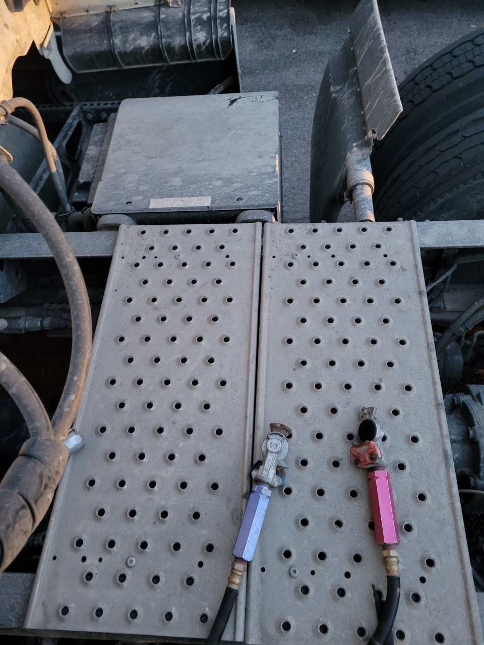

    This is what mine looks like on a factory installed cascadia. 20220510_192539.jpg 20220510_192552.jpg
