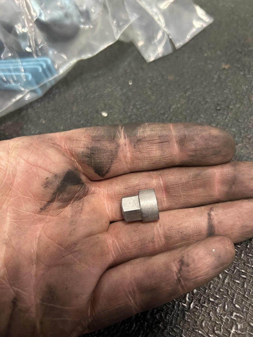

    I appreciate the help. I would've loved to add a photo, but I wasn't exactly sure how, I'm new to forums that don't support embedded pictures. But it seems I can actually upload a picture in the reply section. Odd.
  7. icodyonline
    icodyonline Bobtail Member
    4
    Apr 8, 2025
    I'm still new to this forum and posting so I'm still getting the hang of adding pictures. Here's a picture of the caliper and the adjuster screw. I am referring to.

    IMG_2073.jpeg Is this the piece that is breaking?

    May 2, 2021
    I think Bendix said if the tool breaks, the caliper is bad. Horseship, those are too easy to break. Shops and dealerships take advantage of it IMO
