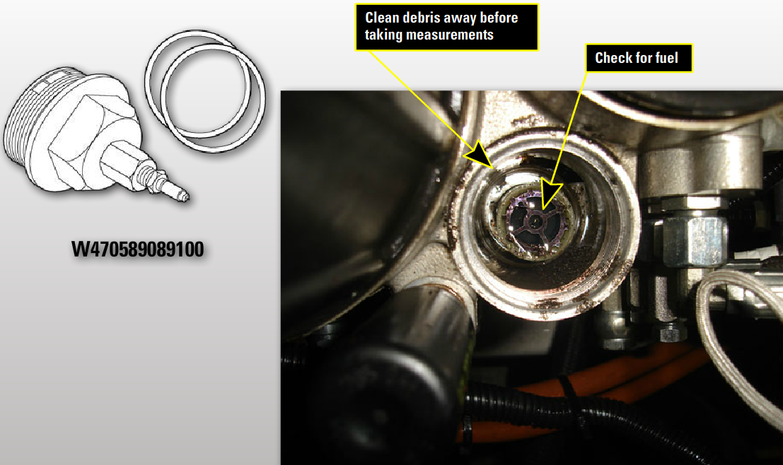

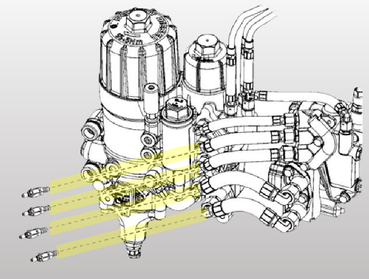

    This should be right next to your primer handle would be your prefilter.
    Your service ports should be here depending on what type of fuel module you have:
    driverdriver Thanks this.

    Checked it. Seems kind of dirty. So I will clean it. But I see fuel filled up to the top at the center as described in the picture. As for priming points. I don't have those. They are just bolts. The hole at the bottom of the filter housing seems to not be plugged and looks free of debris.
    I'll try to send a picture once I downsize it.

    I proceeded to clean housing, ensure the port at the bottom was not clogged and put it back together. Primed the living s#@& out of it. Still nothing. I thought that housing should be completely full of fuel when I take the cover off?
