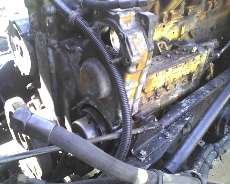

    Quick question. Ready to order a new set of injectors for this engine, which injectors are correct since it's got mechanical injection? Regular 3406B injectors?
  7. ironeagle2006
    ironeagle2006 Road Train Member
    The Only thing about that Fuel system at the time that WAS Electronic was the Fuel Control not the Injectors. Only the Fuel Pump had Electronic Controls on it. The Lines and all that were the same except for a couple boxes on the pump and that was it.
  8. zx150
    zx150 Medium Load Member
    343
    45
    Mar 30, 2012
    Gotcha, so regular factory spec 3406C injectors it is. Thanks!

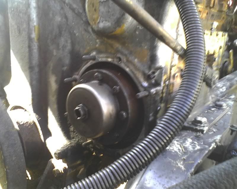

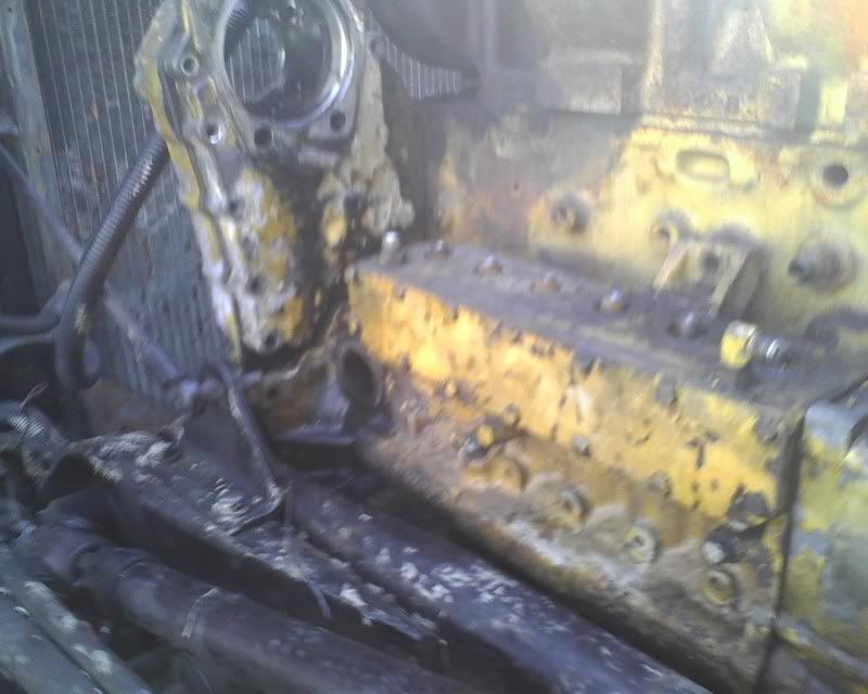

    Still working on the tear down and making great progress except for the 7W3906 fuel pump assembly.
    As far as I can tell I've got all of the bolts out of the pump that mate it to the block and the front cover of the engine. The pump will wiggle and move around but we can't seem to get it out by more than 1/4" or so.
    Does the hub on the front side of the assembly need to come off in order for the fuel pump to come out?
  10. Superhauler
    Superhauler TEACHER OF MEN
    12,209
    100,735
    Jan 30, 2010
    keep stroking.
    yep!......

    Is there a spring or anything under high tension that I need to be worried about before disassembling the hub?
