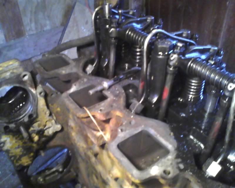

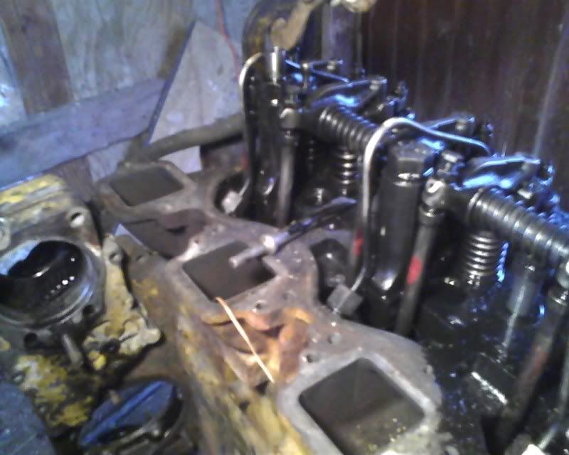

    Did you take out the 3/8" bolts on the intake side? The head isn't generally that hard to get off.

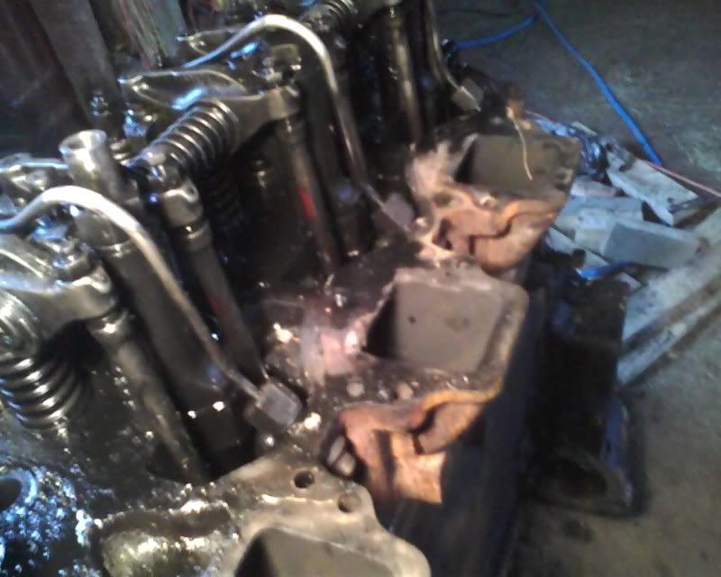

    You will have to remove the 3/4" bolts mounting rocker assembly to cylinder head, as shown in your picture.
    These bolts travel through rocker posts and also fasten head to block. Then count you have removed all 26 - 3/4" and 12 - 3/8" bolts.
  5. zx150

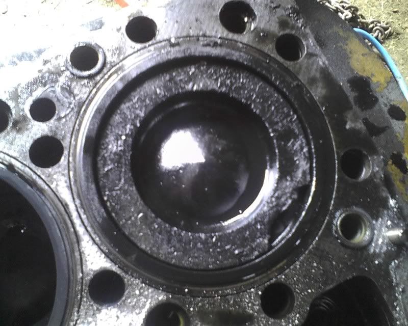

    THANKS! After removing the last 6 bolts that hold the rocker assembly in place the head popped right off. After popping the head off we immediately noticed that the #6 piston was shattered, the damage was definitely old damage. Guess that solved the mystery of why this motor had such bad blow by...LOL

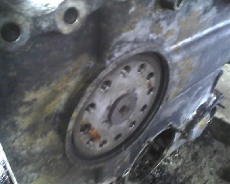

    My question for today is this, on the front and the rear of the crank there is a 'wheel' with 12 threaded holes where the flywheel bolts to one side and the harmonic damper to the other. I'd like to remove the front cover as well as the bellhousing adapter, do these 'wheels' need to be removed before the front cover and bellhousing adapters can come off? I have the front cover to the point where it will wiggle but I'm afraid to put a ton of pressure on it and crack the cast aluminum.

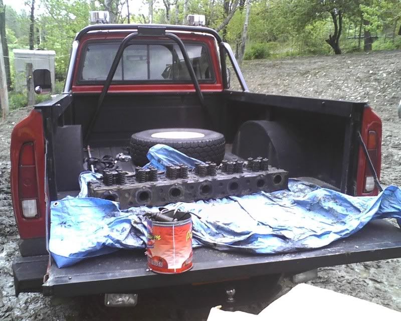

    Cylinder head finally off
    Broken piston
    Front cover

    Ended up answering my own question. The front cover and bellhousing adapter just slide off, the hubs on either end of the crank stay in place. The resistance I ran into while taking them off was the front and rear main seals. The rear main was blown out and the front main was starting to go.
