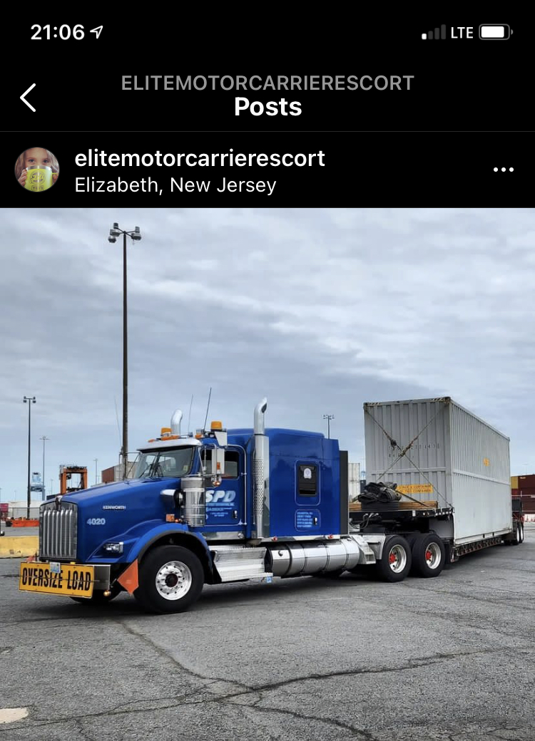

    You seem pretty sharp. Can you haul a highcube on a regular chassis? What about a regular can on a high cube chassis? I’ve always wondered. My container hauling experience is limited to OOG containers. 2B65ACD5-BFD1-4B97-85EF-2F94E90E75B2.jpeg

    Standard gooseneck chassis works for standard and high cube.
    40 and 45 ft boxes have a cutout that buries the 5th wheel plate in the floor and the front bolster has locks pointing to the rear.
    20's don't have the gooseneck feature and the front bolster has locks pointing up, same as the rear.
    kylefitzy Thanks this.
