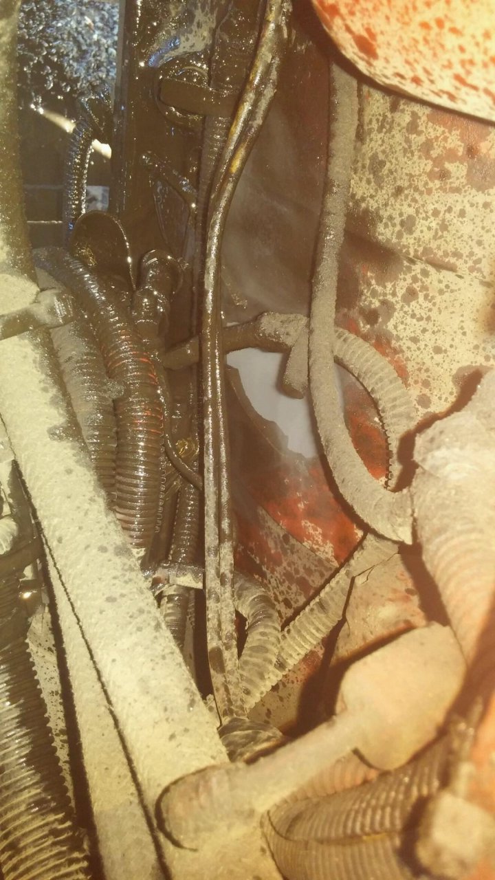

    how much oil did you lose? and where exactly are you taking the picture from?

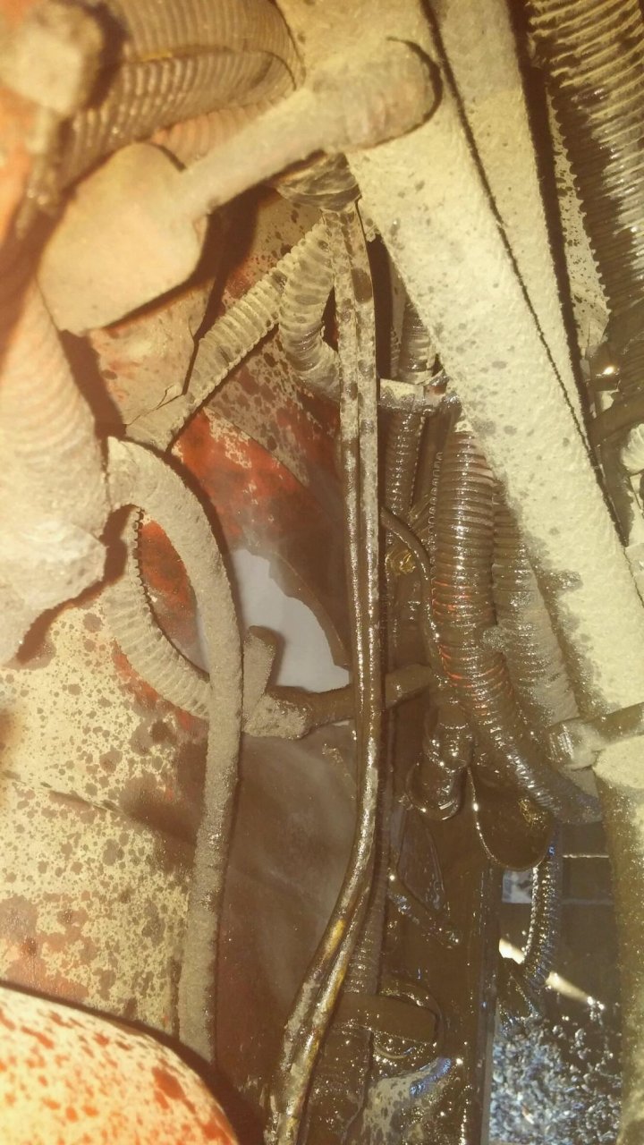

    Hurst, here It is right way round (I think)..

    No amount of JB Weld is going to fix that one. That is a way better pic then the first one. Good job enhancing the pic haycarter.

    Is that from the rod breaking? Or from the rod bearings being worn, which causes rod to break?

    Actually It's the OP's pic but just rotated around to what I think is the correct orientation..(Pretty sure my 2nd one is right way up)......

    Yeah,.. I see it now. I was using my phone last time I looked at it. On my laptop now. Completely see that. Ouch. That looks expensive.
    I feel your pain,.. I'm in the middle of getting motor rebuilt in my truck. Except yours looks a little beyond the damage mine saw. Wow,.. what happened,.. rod poke open a window? Thats like the worst thing possible.

    I had that happen, piston knocked a hole in the bloc, same deal, heard a pop, pulled over, oil under engine.
