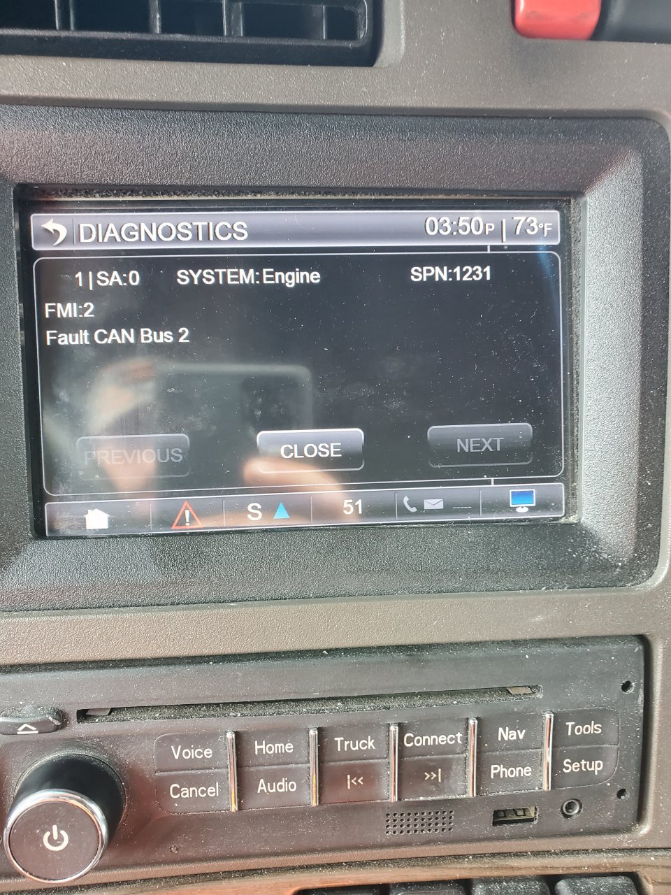

    Hey I kno this is years late but; a fault can bus 2 is an electrical short that is intermittent until complete failure. Resolution is unbelievably a good shake test. Good luck

    I just got the same issue yesterday if anyone can help it would be greatly appreciated. We just got back on the road Saturday after having some suspension issues.

    Your fault code is U1011 or a CAN communication fault Hardware or software malfunction CAN 2 or aftertreatment. You most likely have deeper issues and I would recommend getting hooked up with Davie for a full printout.
    This fault is most often logged due to low battery voltage or a jump start event. It can be set active but will most likely have a companion P code to go along with it.
