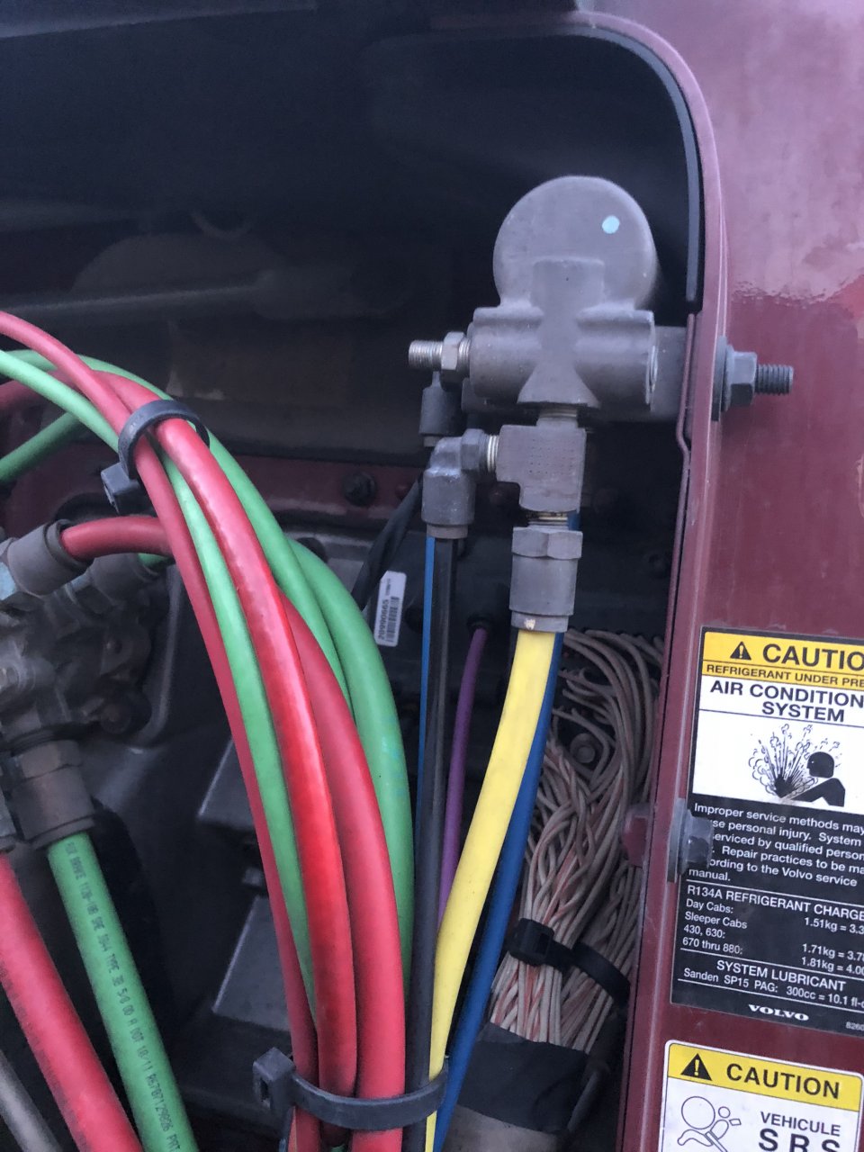

    Have a leak trying to find where this black line goes or comes from just found out it’s leaking thx in advance

    Wich line? More then likely its one of the fitting that is leaking. Get some soapy water and track it down.

    It’s a quick connector. If you can get the rubber oring (when they age, they get stone hard and start leaking air), you can pop the line and replace just that. If you don’t have orings, just get the new L shapped fitting at Volvo.
    Doesn’f natter where is it going, those quick connectors all start leaking at some point.

    It’s the black line just trying to see if anybody knows where it goes

    Yes I will reconnect any idea what the black line is connected to

    In the picture it’s an air governor.
    If you’re asking what’s on the other end... well, just trace it down and post a pic.

    Hey, I looked at mine, and that hose goes just one feet down to an engine fan activator.

    Black is for fan clutch yellow is governor supply from wet tank
