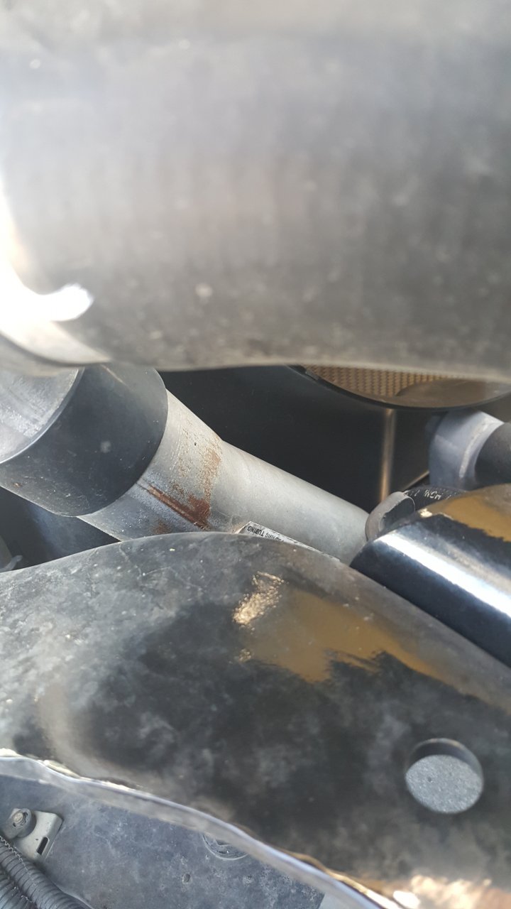

    I took this picture earlier today. Didn't think anything of it until I was doing my pretrip this morning and it finally dawned on me how much the truck moves when I saw the scrape marks on this metal coolant pipe. Not sure if that is normal, but thought I would ask.

    There was one freightliner shop that mentioned possible cab mounts, but I never made it back to them to check. Every other shop I mention it to, they say no way not possible and won't even check for me.
