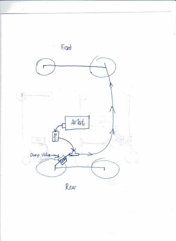

    AirBags1.jpg ok this is what Ive come up with, maybe this will work like I think

    That won't work. You have to keep each side separate or it will turn you over in a curve.

    ok well the way it was originally then I just need to adjust from there....Bent Wrench when you said plug one rear feed at the front, where did you mean at.

    I suppose that might be possible on paper but, only with really large hoses and no anti-roll bars on the suspension.
    I am not a guru but, I have never seen a large hose system that did not have anti-roll bars.
    Actually the only large hose systems I have seen are on the back of a tractor and they use short bags and have anti-roll bars.
    The HCV does not keep the sides separate all 4 are tied together, so what keeps it from rolling over then?

    That looks good.
    My only concern would be that the HCV (it appears) is not on the axle being pressurized and could lead to some funky behavior, especially when on uneven ground.
    Keep in mind that the DOT bumper may drag on steep inclines (driveways) with the rear axle dumped.

    Hahaha, y'all can tell I probably didn't get an A in art class, Wrench the HCV is on the rear axle. I was thinking the whole flipping when going into a curve didn't make too much sense cause they are all ran off one HCV now, what's y'all's opinion on the solenoid I've got, do you think it'll do the job or should I go with something different. It's pouring rain here in GA and seems to never end cause Mother Nature hates anyone who is trying to get stuff done outside and particularly me cause I try to keep my truck clean. You all have been a great help and if there is anything I can help you all with let me know, I was a diesel mechanic long before I started driving and obviously other than dump valve installs on a trailer I'm pretty good with other stuff.

    The valve has a line for each side. They are isolated inside the valve.
