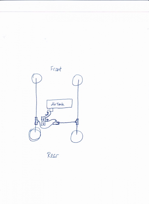

    ROLL TIDE brother!!! Nice picture, that's exactly what I'm gonna do. I'm gonna get all new lines and fix it up right when I do it, I really wanna use the air line I already got in the cab for the 5th wheel but to keep it hidden I might should use the electric method, will the solenoid I have work, its originally used for a fan clutch and I'm not sure how fast it'll dump off.

    Thanks two lane ill get the haldex quick dump valve if I go electric if not ill get the other quick dump

    I'm not sure how well that will work. Most trailer dealers will have a "dump valve" in stock and they are not very expensive. I look at it this way, if you are going to do it, do it right the 1st time. You are already going to re-plumb the hoses so why not just get the right part and go with new as well..... granted the fan clutch valve might work, I have no idea how fast it will allow the bags to dump.

    Great Amercan over here in GA has the rapid dump for about $35, the fan solenoid won't work cause it won't blow it off fast enough. But ill have it right by this weekend, it would be done already if it wasnt for the holiday and the #### rain.
