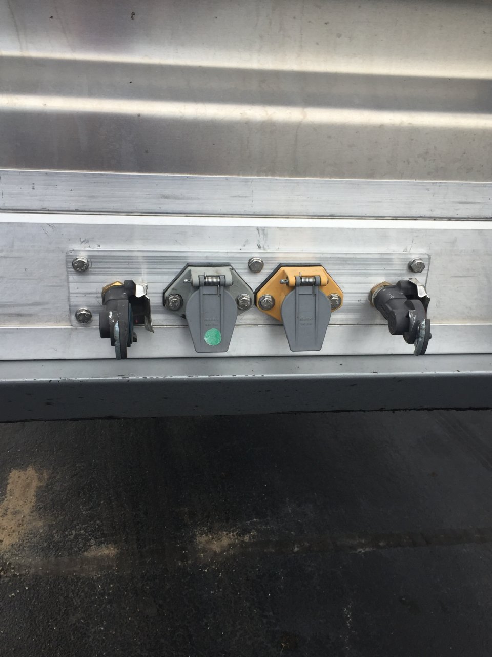

    We use yellow 7-way ISO cords and sockets to power the dump valve and accessory lights E71EFE4B-47F8-4209-AB41-CD3B035CFCA3.jpeg 61881F29-F07D-44B7-BF85-BBACEBA6A715.jpeg
    cke Thanks this.
