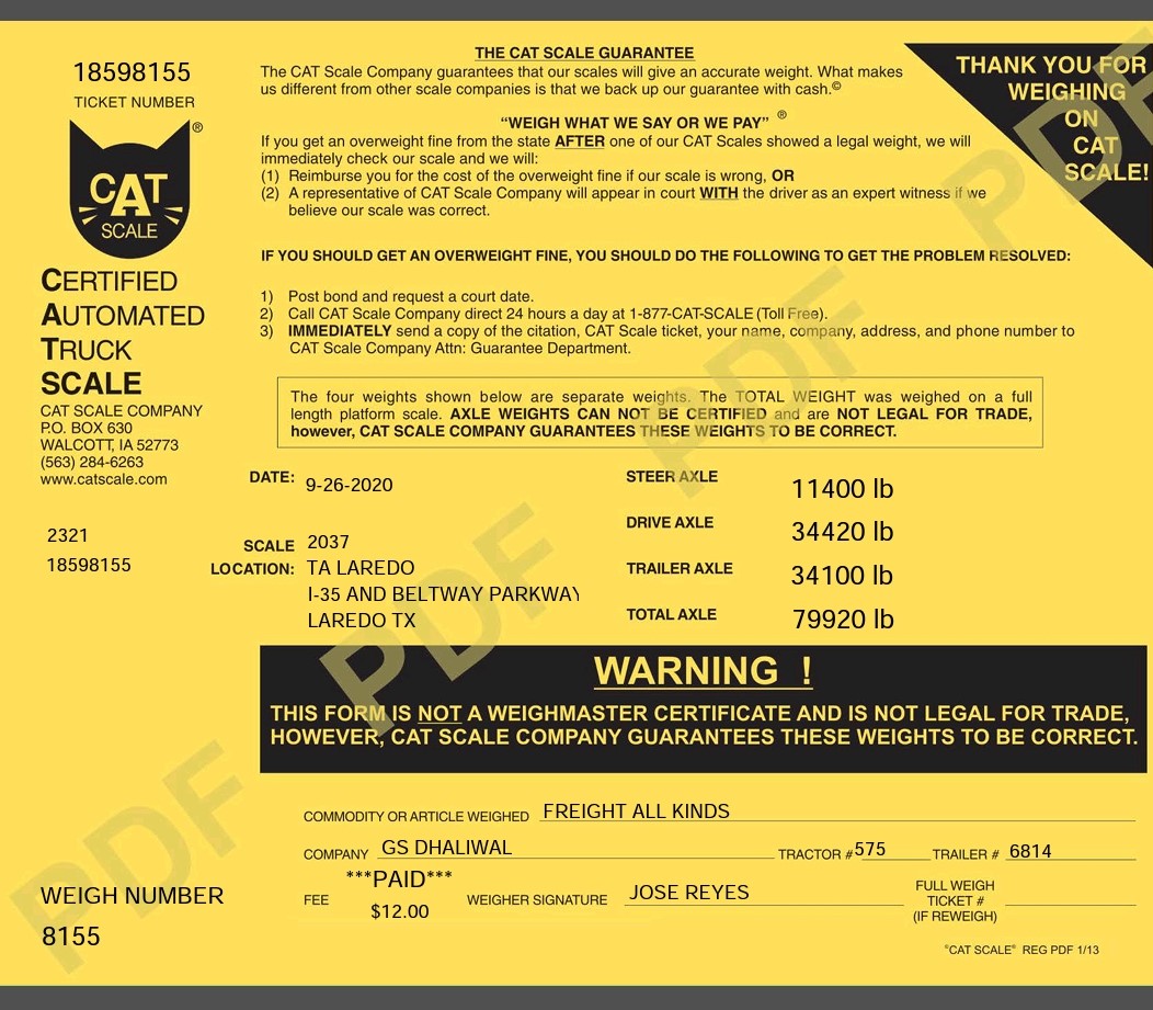

    Regardless of how much fuel he has or where he’s going, today, he’s gonna have to move his fifth wheel If he wants the rest of his life to go easier. 11,400 on steers with 34,400 on drives??

    The OP stated he needed help and posted a scale ticket, and he mentioned the driver did not fuel yet. So I can only assume that the truck needed fuel. The run was from Larrdo, Texas to Toughkenamon, pa. Which is about 1800 miles. A smart driver would know the max he could haul and scale out, and would find out how much the load weighed before picking it up, but obviously he didn't do that. So... Could he scale it out and run it, and go around scales, absolutely. But why would a driver do that on a 1800 mile load if he didn't have full tanks? Why make extra work and cause yourself extra time if you could have the trailer reworked? Thats my point....

    That drivers gonna spend 2 hours moving the 5th wheel two holes, and another hour reweighing and sending more messages asking questions.
    OR, he could just
    Get rolling, and burn off the fuel. If he gets caught, whats it gonna cost - $50??? It's called tuition, junior.

    Always arrive at a shipper fully fueled when possible. Cut a pallet, I say.
