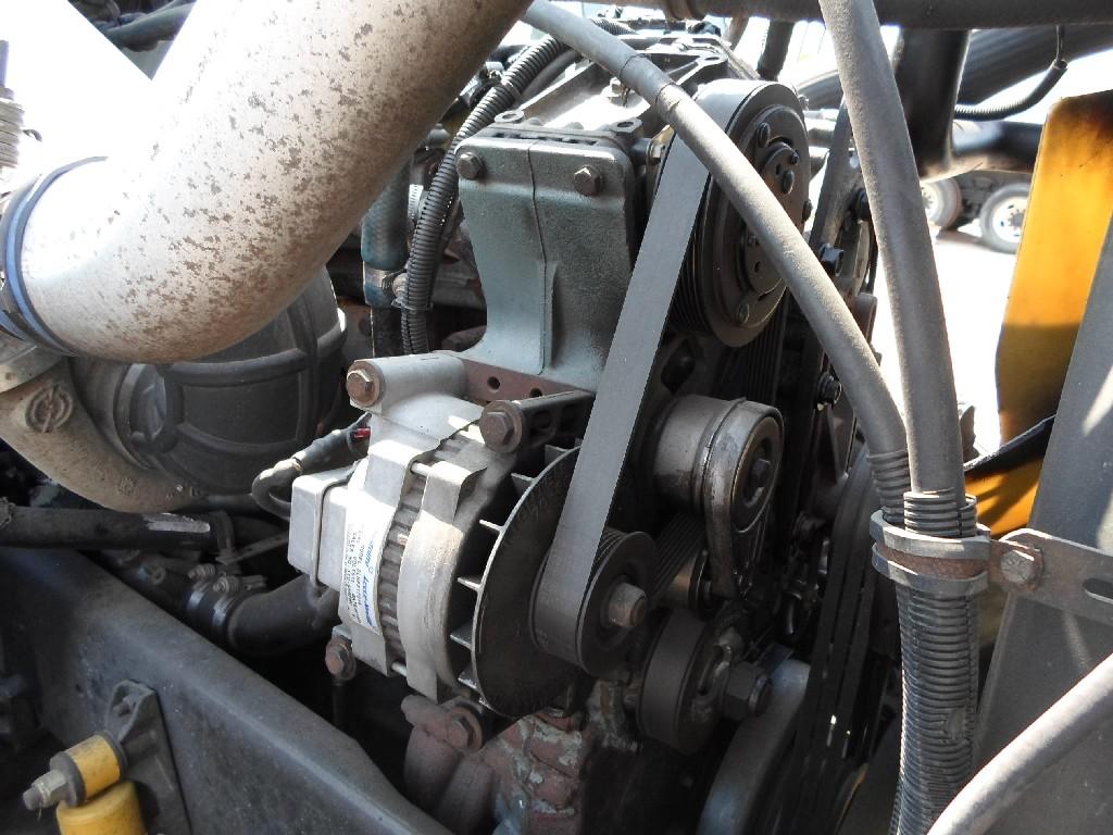

    All you need to tell parts people is if your compressor is pad mount or block mounted.

    Take a pic of the bolt heads.

    Different style compressors yes but they all bolt through the top of compressor or the front of compressor.

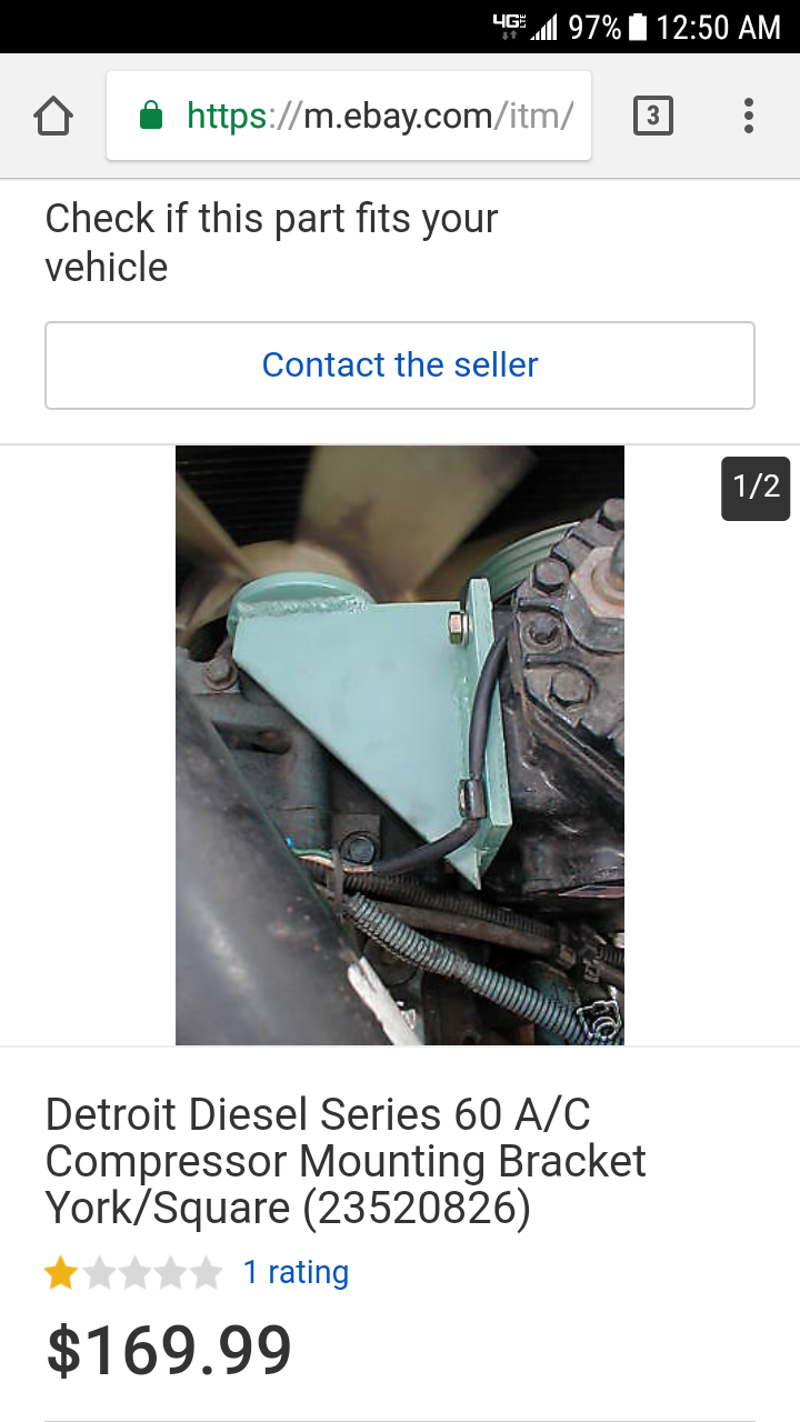

    phpThumb_generated_thumbnail.jpg Screenshot_20180711-005055.png 2006-FREIGHTLINER-CST120-CENTURY-A-C-Compressors-Ok1R9NaN5FVV_b.jpg 2006-FREIGHTLINER-CST120-CENTURY-A-C-Compressors-Ok1R9NaN5FVV_b.jpg you should have top or bottom style.

    So I think you have the older style compressor mounting. Called block mount I think.
    I believe the compressor is called a York compressor, or kysor?

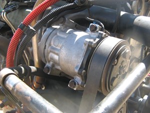

    My friend has a 2001 Freightliner FLD120 with a 12.7 Series 60 that had a York to Sanden conversion kit installed a month ago.
    It was done using a Mastercool Parts branded York to a Sanden A/C compressor conversion bracket kit and he couldn't be happier, (especially after going through four York compressors that burned up in the last five years.)
    It cost him $530 shipped which included a genuine Sanden A/C compressor, (not a Made in China copy) a York to Sanden compressor conversion bracket, all mounting hardware and wiring harness adapter.
    Also Sanden compressors are the best out there compared to a York.
    The Sanden compressor I have on my Volvo VNL has been on there for 1O years, and it's still going strong.
    When you do your conversion, it's strongly recommended to replace your receiver/dryer and orifice tube/expansion valve to avoid any warranty issues later.
    Also with this kit, you will use the original A/C pressure lines, no need to change them or make up new lines.
    You will need to call them up before ordering, as you will need to take a picture of your current setup and email it to them so they can match the right sized compressor and pulley to your application.
