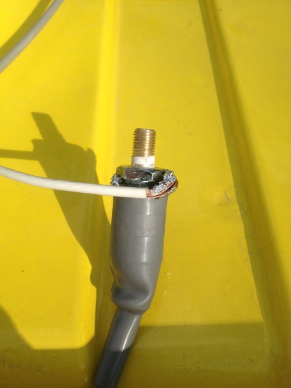

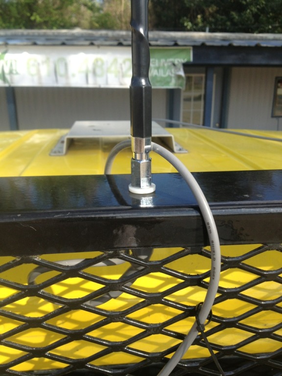

    One other thing...
    I didn't use an antenna "mount."
    I simply drilled a hole in my steel headboard, attached the coax connector to the "connector", placed the connector through the hole, put the teflon washer on, then screwed the firestick on.
    As I mentioned, I soldered a 10 ga wire to the piece where you screw the attenna connector to.... (and ran to battery, which I will change tomorrow to chassis somewhere.)

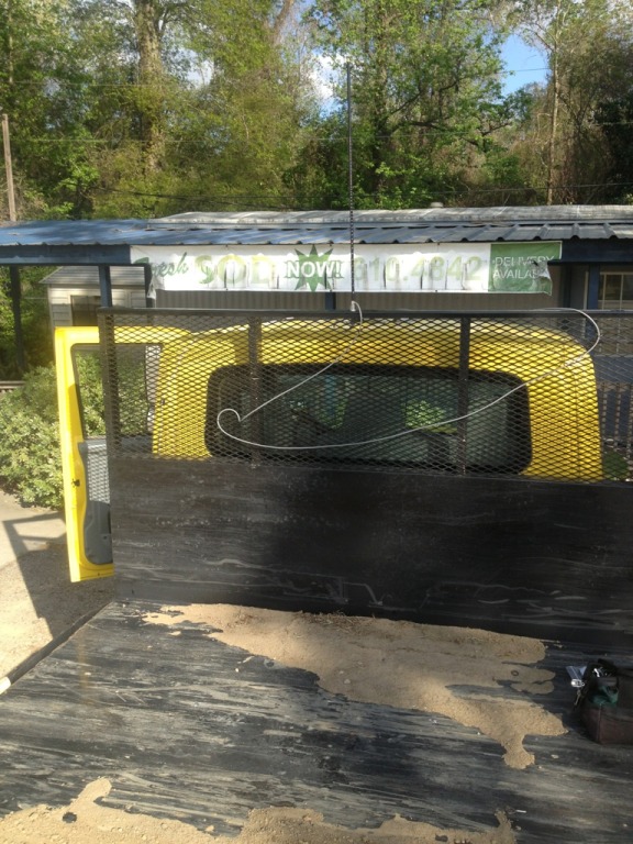

    thanks for the answer, but I didn't explain well...
    I have a wilson 5000, but the whip is hitting every darn limb in this town, and I drive in town all day long and just cant take that.
    I'm trying to mount this firestick on the headboard of the flatbed (right behind the cab, and about 3" taller than the top of the cab.)

    get rid of that solder "ground wire"
    You should be fine using just the steel header board
    Did you drill a half inch hole?
    The nylon shoulder spacer spacer on top?
    Look here
    http://www.firestik.com/Instl-Art/te-k-4a.gif
    The bottom part called the Housing in the picture should be making metal to metal contact with your header board, that is where you sanded the paint right? the bottom?
    With a header board of steel you should not need that "extra ground wire"

    I've used this before, but I left the plastic cover on and just soldered the center conductor in with the braid when I soldered the connector on.......mistake?????
