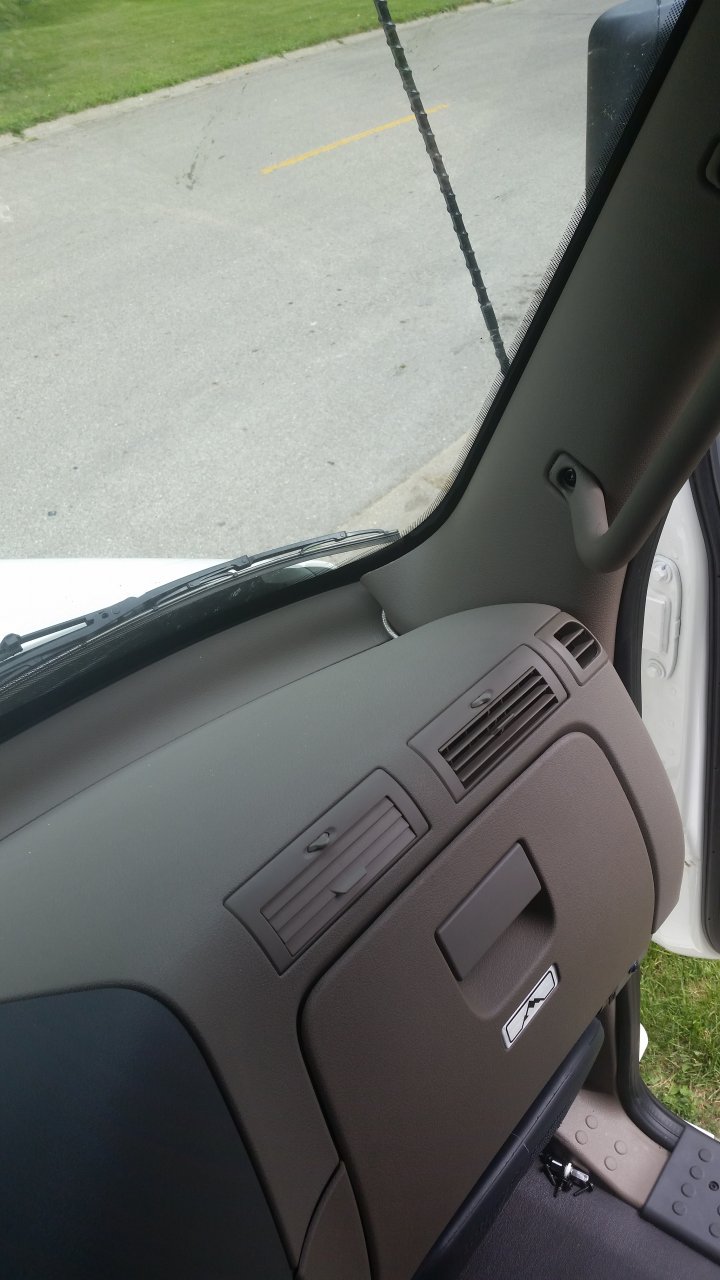

    My budget only allowed me to use points at Loves, so sorry to say I didn't find any miracle cure for mediocre SWR. However I was able to document a few short cuts, while keeping the install pretty clean (and most important, not violating the lease agreement).

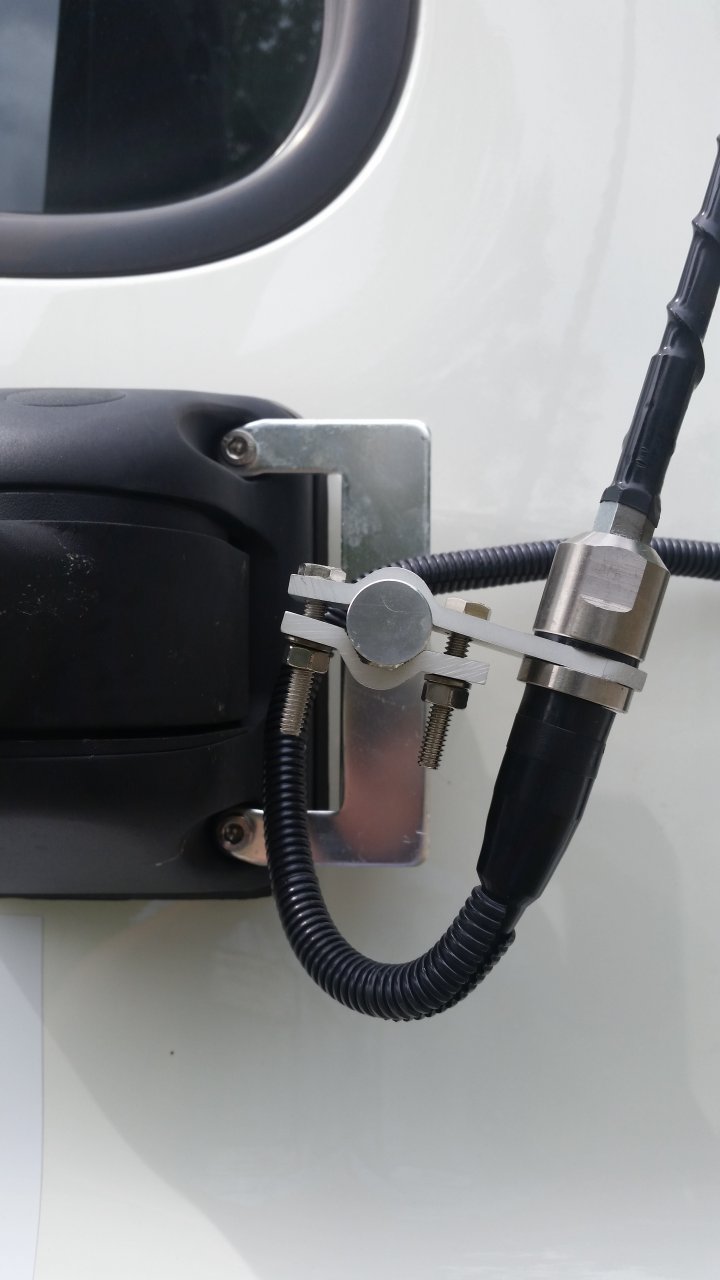

    Items: Wilson (Cascadia only) mirror mount, Wilson RG8x coax with Fme mini connector, RoadPro perch mount, Wilson HD SS antenna stud/lug, and K-40 4' fibreglass antenna.
    Tools: Ratchet w/ T40, T25, T20 bits; 6mm hex key, razor blade, and a few wrenches.
    Start with removing the two T40 torx bolts (passenger side), and install the new bracket using the new bolts w/ 6mm Hex key. Install the perch mount, stud/lug, antenna, and coax (PL259 end, NOT Fme).

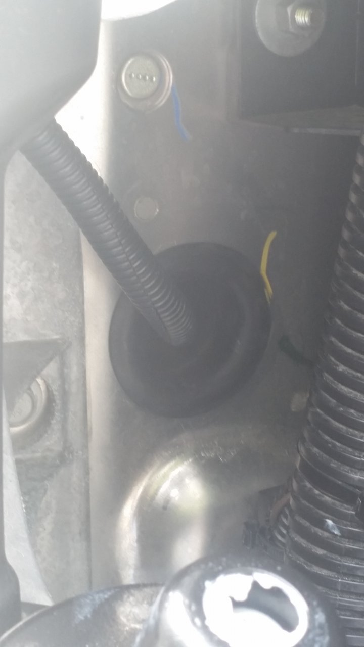

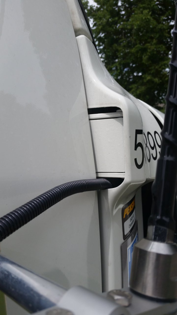

    Feed your coax into the engine compartment
    Open the hood, and find the single unused rubber grommet located passenger side of lower right firewall. Cut a small slit to push through the coax.

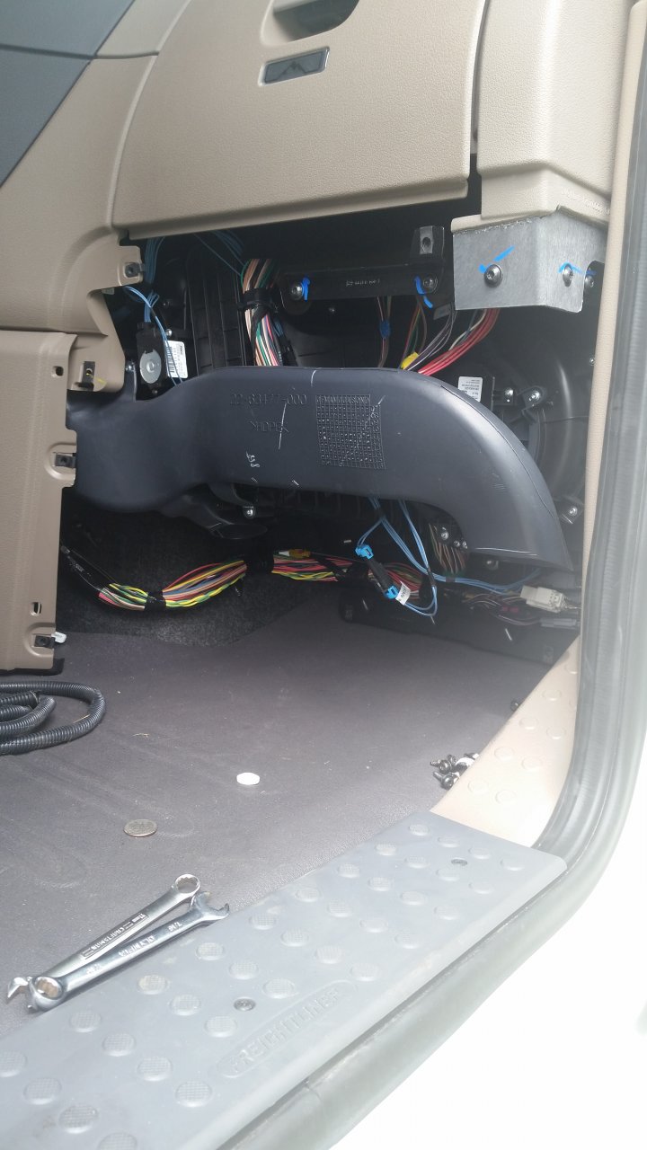

    Next remove the 6 or 8 (I forget how many?) T25 passenger lower kick panel screws. If you push 6" through the grommet, you'll see it. Back it out if needed and route it under all other wiring. Then pull it all the way through.

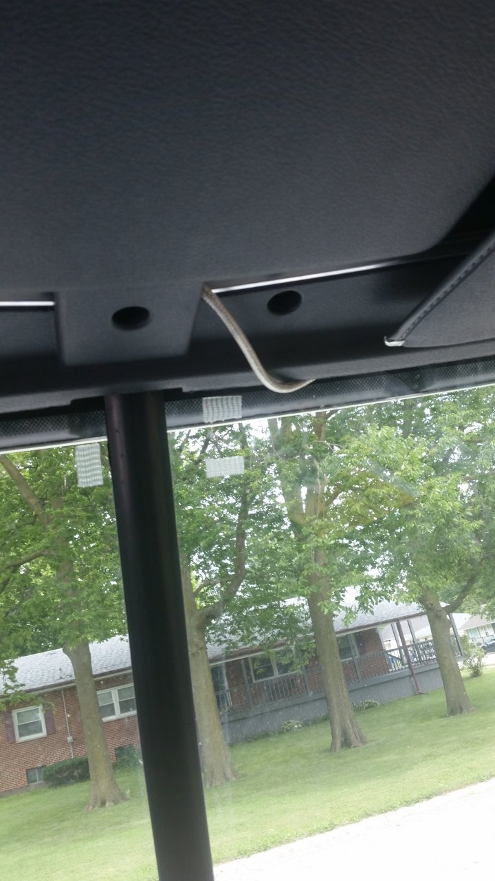

    Leave 3"-6" for redo's or errors, then throw the entire length atop the dash and stuff the length along the passenger side into the gap running vertically along the dash. I continued stuffing it into the window column all the way up, and over with only 2" visible at the dash and another 4" near the centre windshield column. I slid the Fme connector side into the metal track and took just a min to fish it into the cb compartment.
    This entire install may be 30 min tops. And scored 1.5 SWR.
    Good luck!
