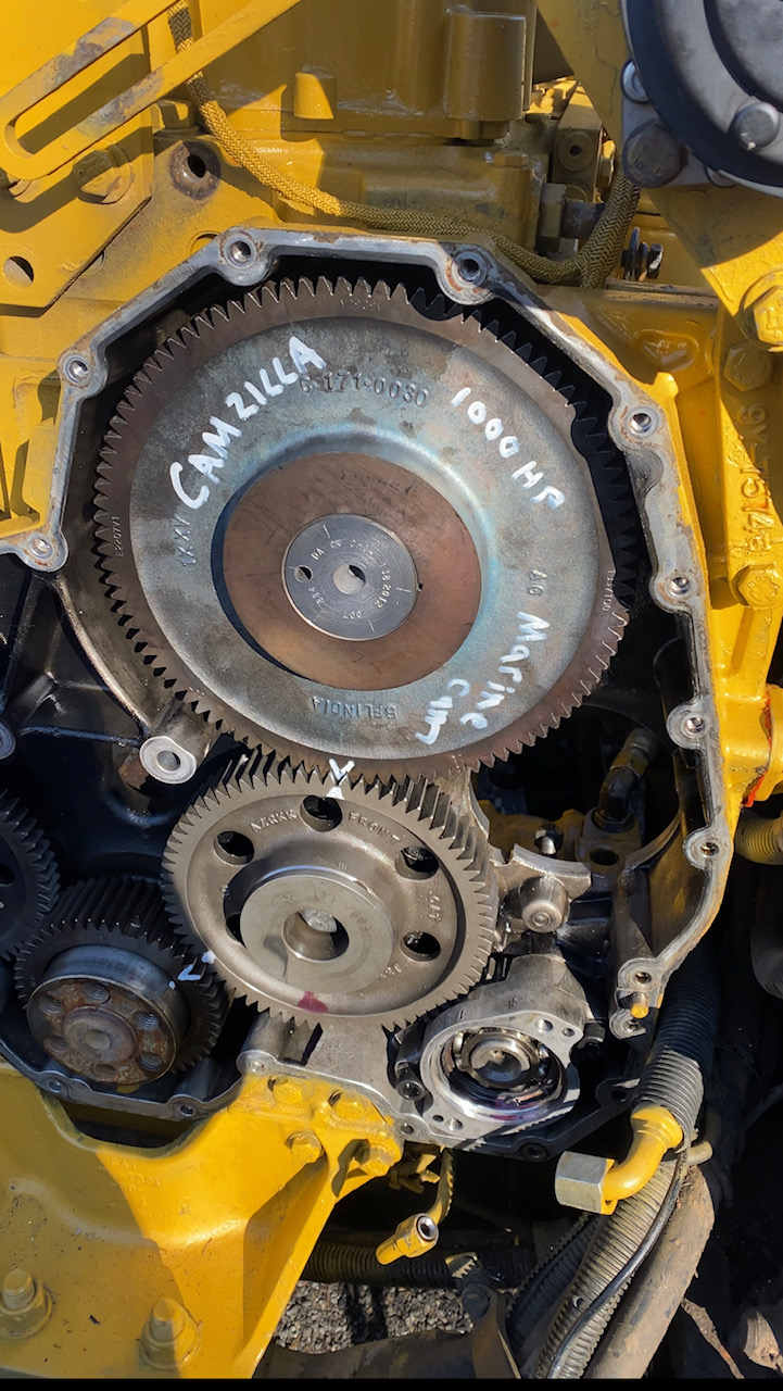

    You definitely made the right choice doing them all. There could be hairline cracks in the remaining teeth, which would eventually spall and come apart.
    Looks like you have SIS access? Take a read through Cat's Reuse & Salvage guidlines. Those gears would definitely fail their criteria. However, some of the stuff they'll allow during a rebuild would boggle your mind.

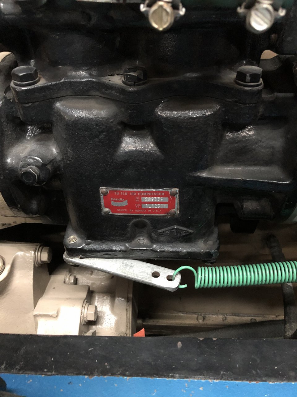

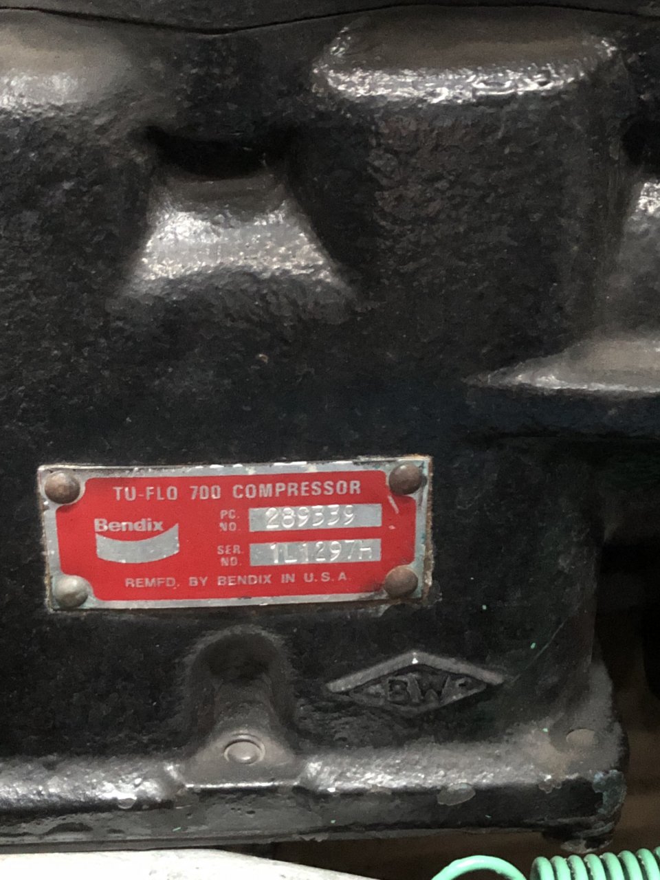

  5. SmallPackage
    5,920
    19,008
    Dec 20, 2019
    Marion Texas
    0BEAE7A2-C9B7-4D3A-8928-21B1E9072ED4.jpeg B0603665-79ED-467E-A91B-5E172260A682.jpeg
    1951 DiamondT. Original 72 year old. Tu-Flo 500
    Feedman, pushbroom and AModelCat Thank this.

    Those 700s don't play around when they produce air. I love them. Gauges shoots up FAST.

    When to use injector height tool? Only when replacing injector? Cat says to set injector to zero lash and then turn adjuster 180 degrees and lock it. No mention of height tool for rocker shaft reassemble and overhead adjustment. Still waiting on parts but just asking ahead of time.
    Thanks
  11. Don379
    Don379 Heavy Load Member
    714
    1,286
    Jan 7, 2021
    Rest of my parts came in last night. So most of the morning was spent pushing setting up everything. HAd to push bushings/bearings into new idlers, put bearings on new accesorie drive gear, heat the crank gear and cam gear to slide into their prospective places. Then by afternoon, i got it all back together. NEw idlers, new cam gear, new crank gear, new accesorie drive gear. Also have new air compressor gear but peterbilt told me that cat will take almost a month to get me a new compressor under warranty. So ill have to wait. Tomorrow, ill install the rocker shafts and adjust valves and injectors as well as jake brakes and lash settings. If i have time, ill get front cover on and start it. but im in no rush. Again, thanks for the help in this matter.ill follow up as i go along
