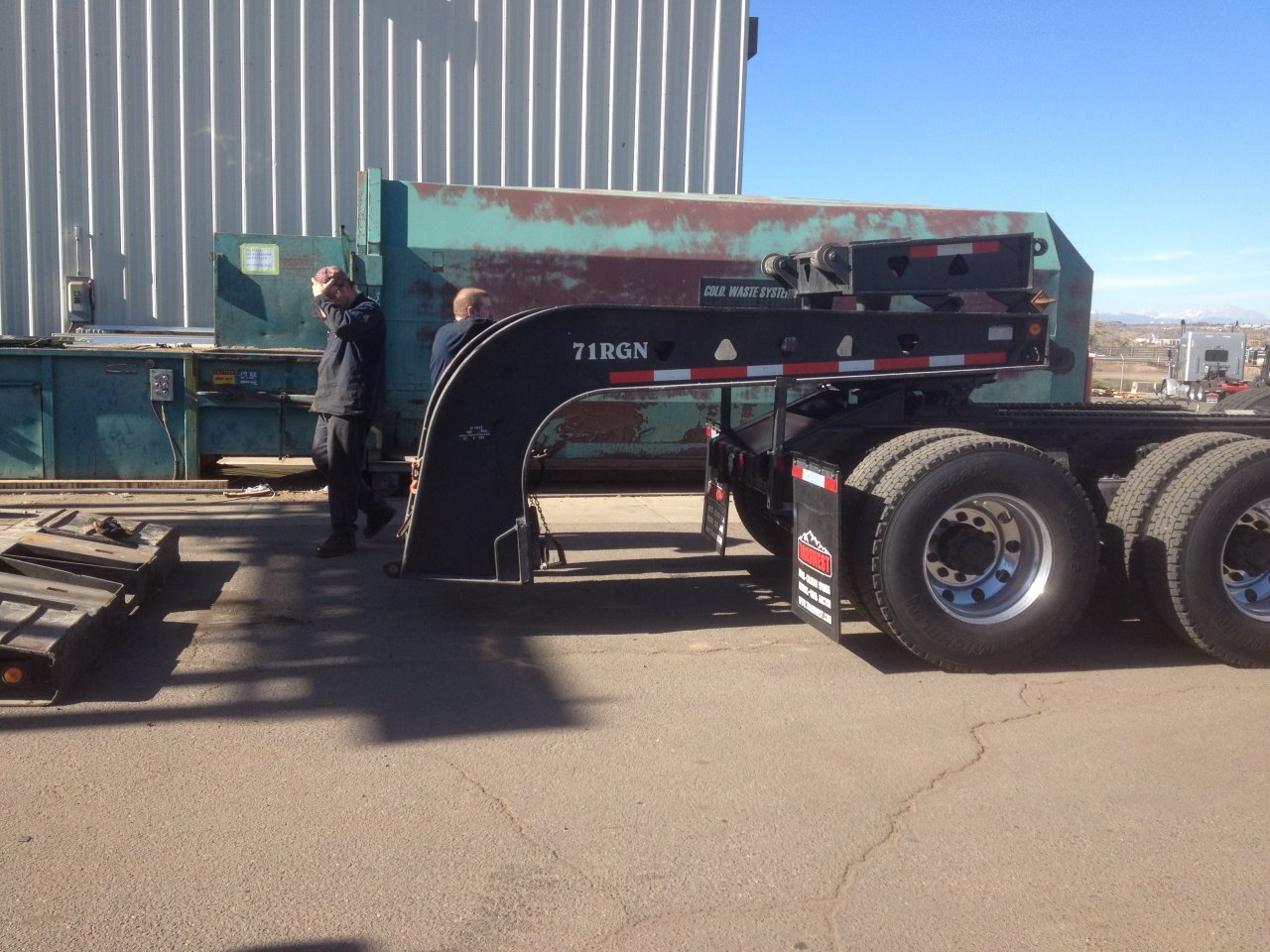

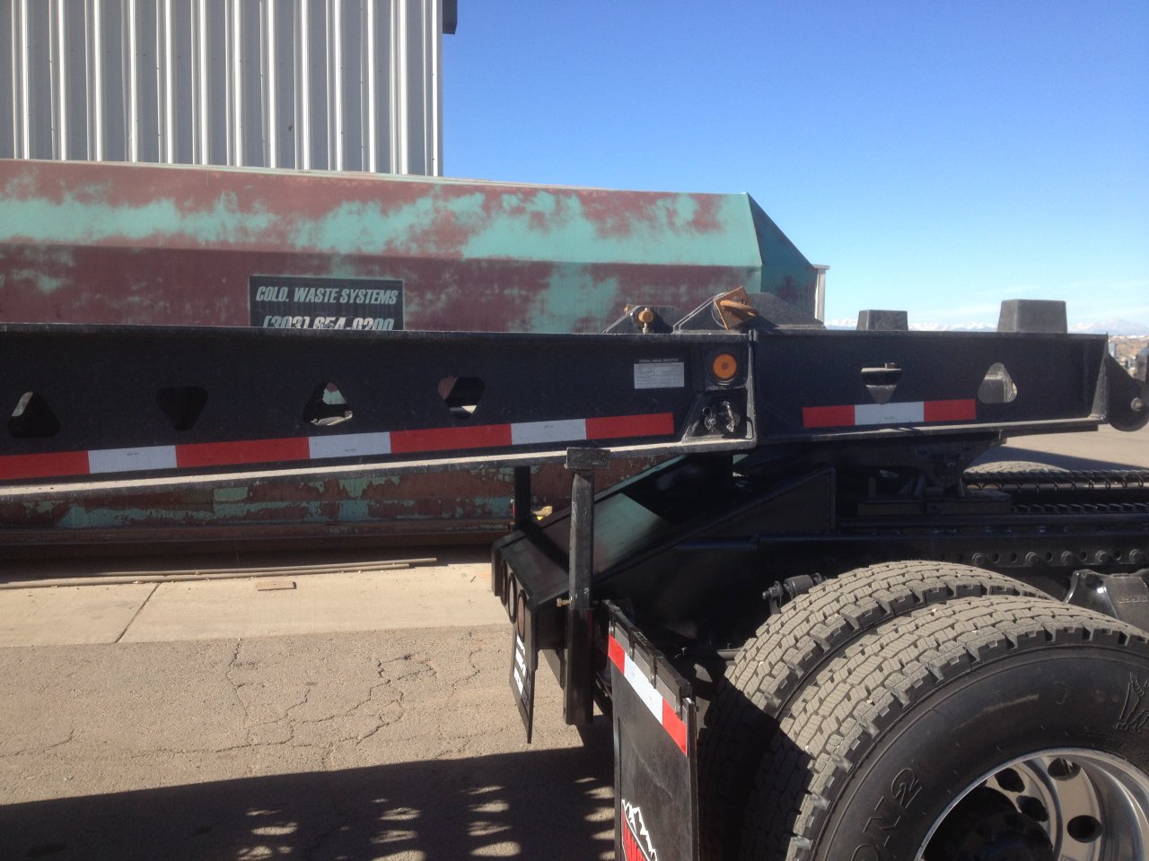

    If want to be really cool
    Have them build you some neck supports while they are at it
    Take square tubing and have them drill holes about every 2-4” and then weld flat stock on top with the outer edge rolled up. Then have them bolt/weld some large tube to the outside of the frame so the smaller tubing side up and down vertically have them drill a hole about 4” down perpendicular to the frame - then get a large hitch pin to put through the holes (these hold up the adjustable tubes) and the neck rests on the top inner tubing.
    You won’t have to use a wooden block to support the neck when detaching and WHEN you drop the neck on the ground you can use the supports to lift the neck using your air and a block on the ground.
    Hopefully you can visualize what I am describing. If I could draw it would be easier ... good luck

    4ABE531A-AA46-435B-B36D-A4EC2C8B1104.jpeg AE834D2E-CBEF-4E21-8CD9-54FDD179B22F.jpeg Here is a picture of mine when I had them
