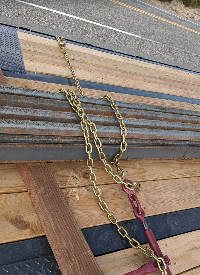

New guy here, how would you chain this?

    I see a lot of guys do that... personally I would still use two so that if one chain breaks or becomes loose, you still have one that is (hopefully) tight.

    That's only a problem if not properly done. When properly used, the only thing you'll have between two anchor points is slack chain. I used to do it a lot.

    You are right never to trust banding. But a good forklift driver could turn it for your and take it off with ease

    I would put something infront of the pallet to keep it from sliding in an emergency stop. Since it is so small and i feel like securement does not work as well the closer to the deck it gets.
    Couple pieces of dunnage will do it or a 2inch strap around bottom of pallet pulling backwards is how i would do it. Just my opinion, looks good tho.

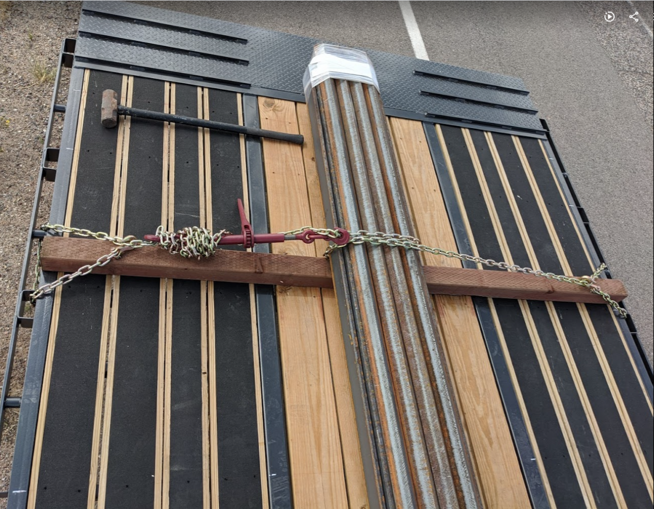

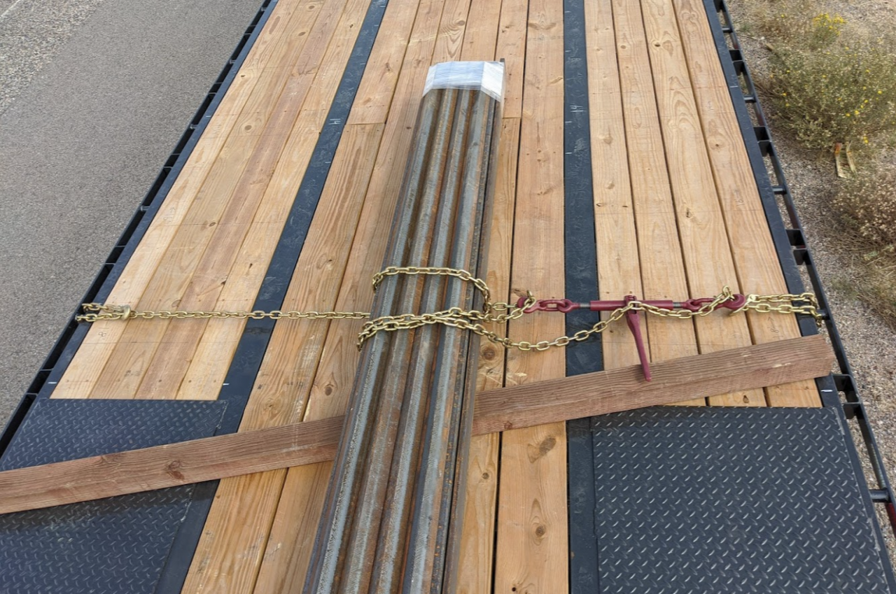

    Thank you gents, was delivered in Denver without incident. The rez roads in N.AZ are terrible! Check out the poor job I did with the long steel, and how I fixed it.
    It's obvious I mistakenly did not put downward pressure on the steel with the chains the first go around. The second seems right.

    better:

    Sometimes it works where you can both choke it and secure it with one chain/strap*, or sometimes you need to do those things separately.
    *Not suggesting using a strap in this case, but for things like pipe, etc.

    Looks pretty good to me. The only thing I think I would have done different is maybe add a strap or two to the middle of those long sticks of steel. I think the DOT likes securement every 5'.
