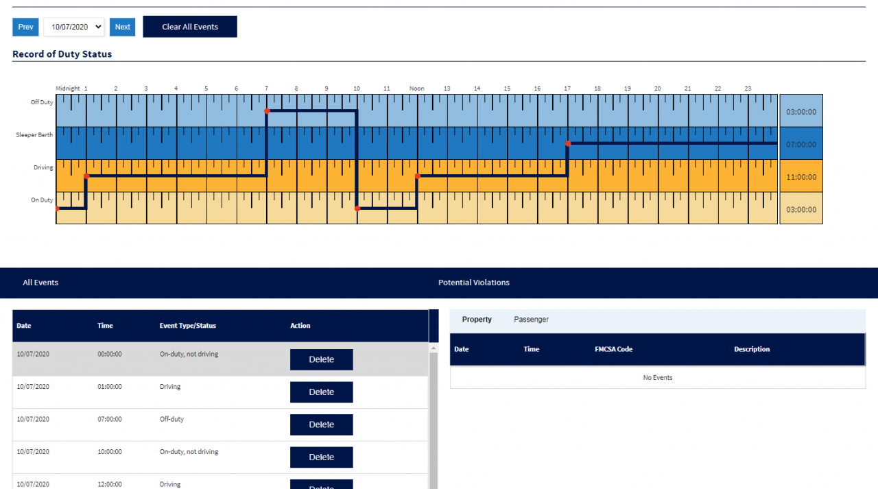

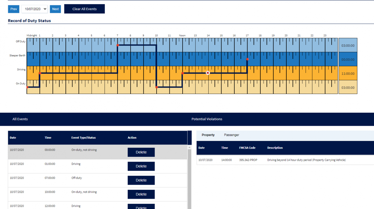

  7. cluemaster
    cluemaster Bobtail Member
    14
    10
    May 6, 2016
    If you try to reconstruct day from FMCSA fact sheet into this tool, 14 h clock violation will show up at 2pm, ( as old regulation would say) but it will disappear after you spend 7h in sleeper.
    Confusing ...
    basically you can be placed out of service after 2pm but violation will disappear after ?!
    https://csa.fmcsa.dot.gov/Documents/All_HOS_Fact_Sheets_508.pdf

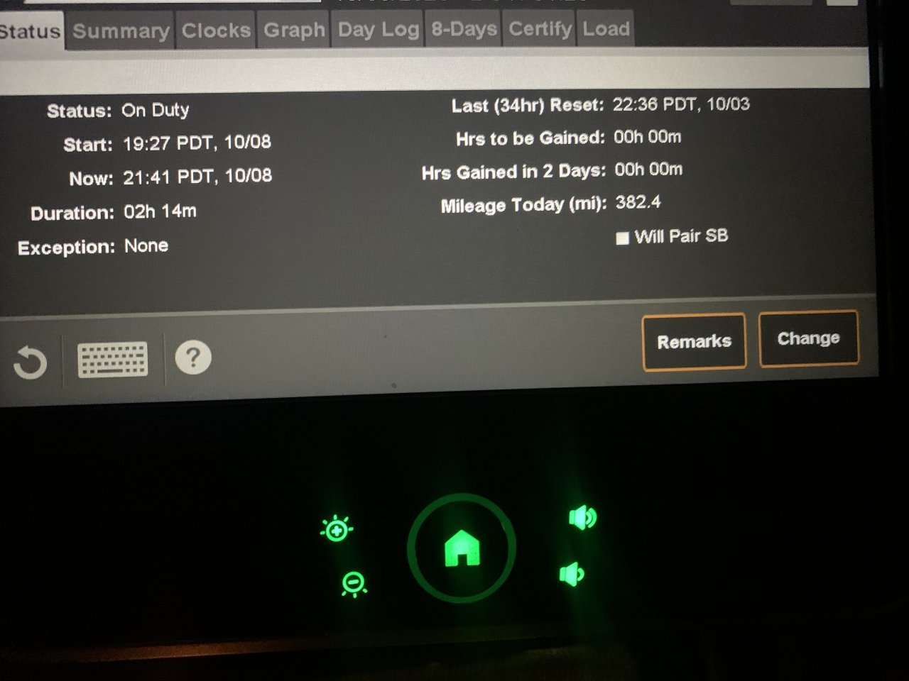

  11. Roberts450
    Roberts450 Road Train Member
    2,237
    3,635
    Feb 6, 2016
    @BeHereNow97 try using the will pair SB button and Im guessing you wont get the orange warning message. 29E4D9C4-66CF-406D-9549-F9A7ED6F39EC.jpeg
