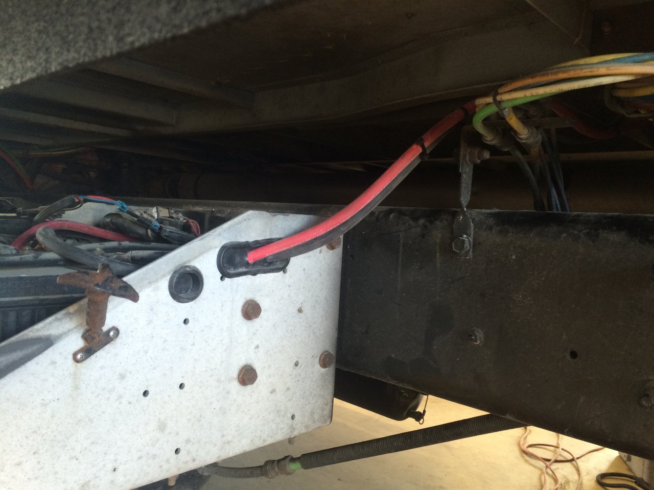

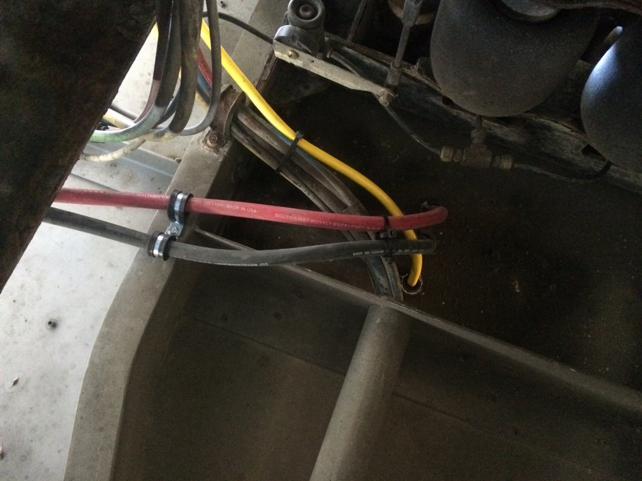

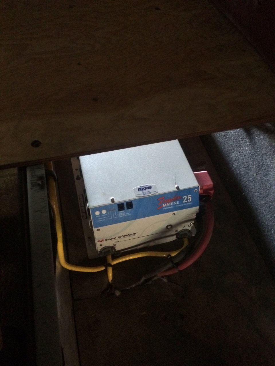

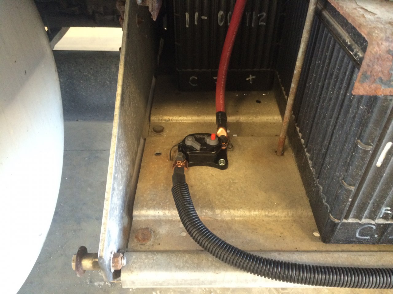

    image.jpg Started working on my home made APU today. Installed the inverter and the battery cables today. Kept getting interrupted so not nearly enough progress. Have to finish up tomarow. image.jpg image.jpg image.jpg

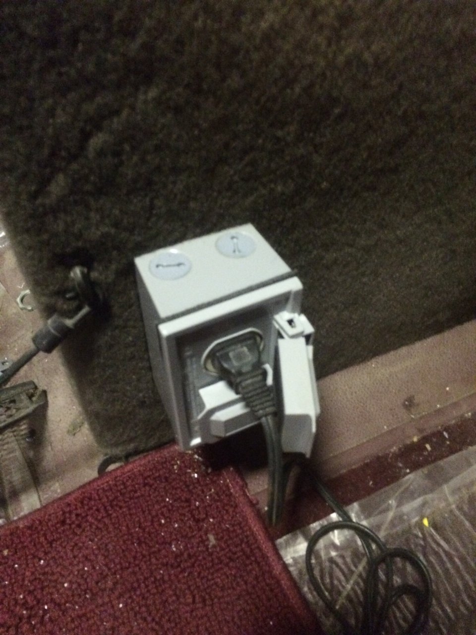

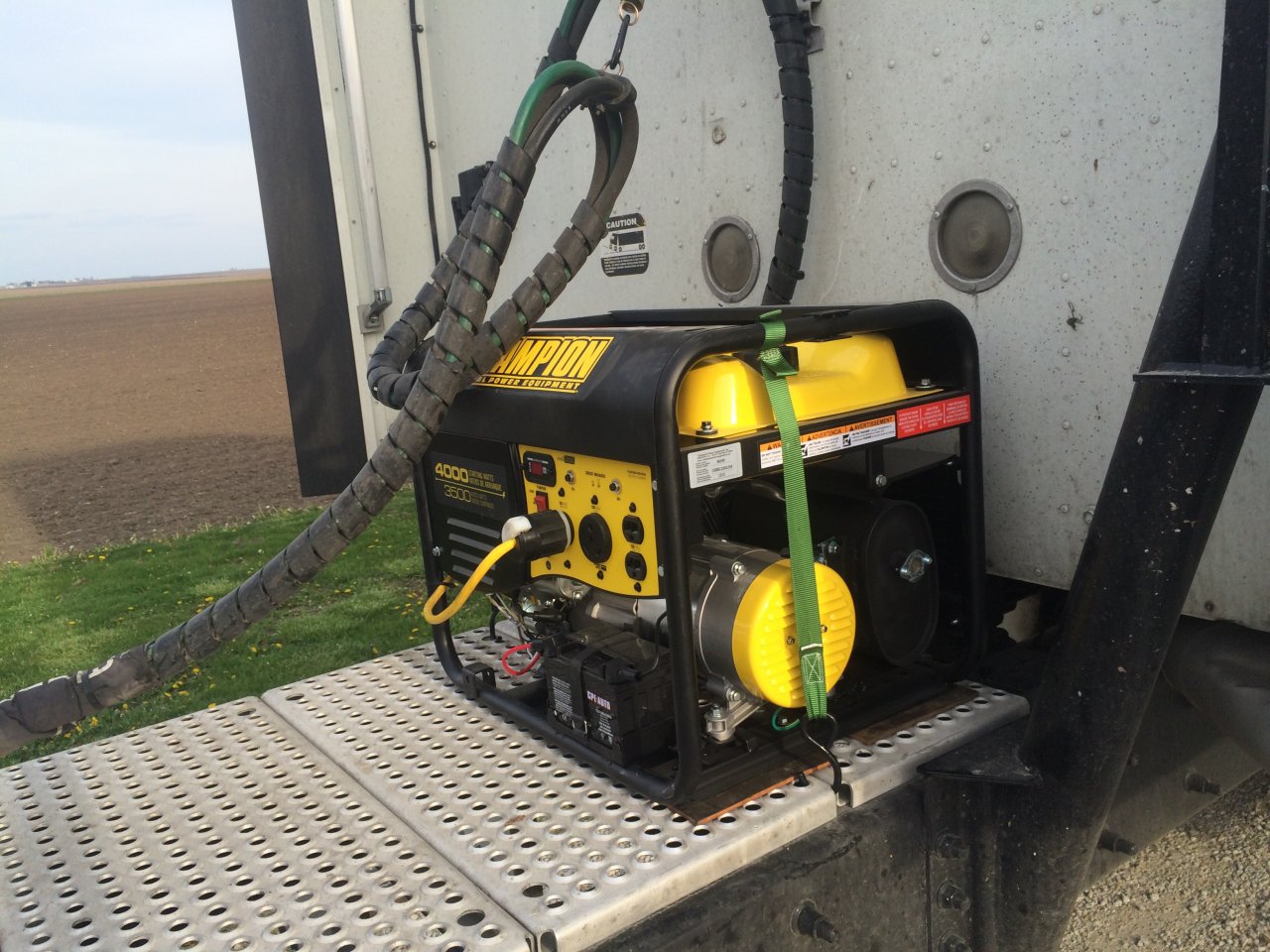

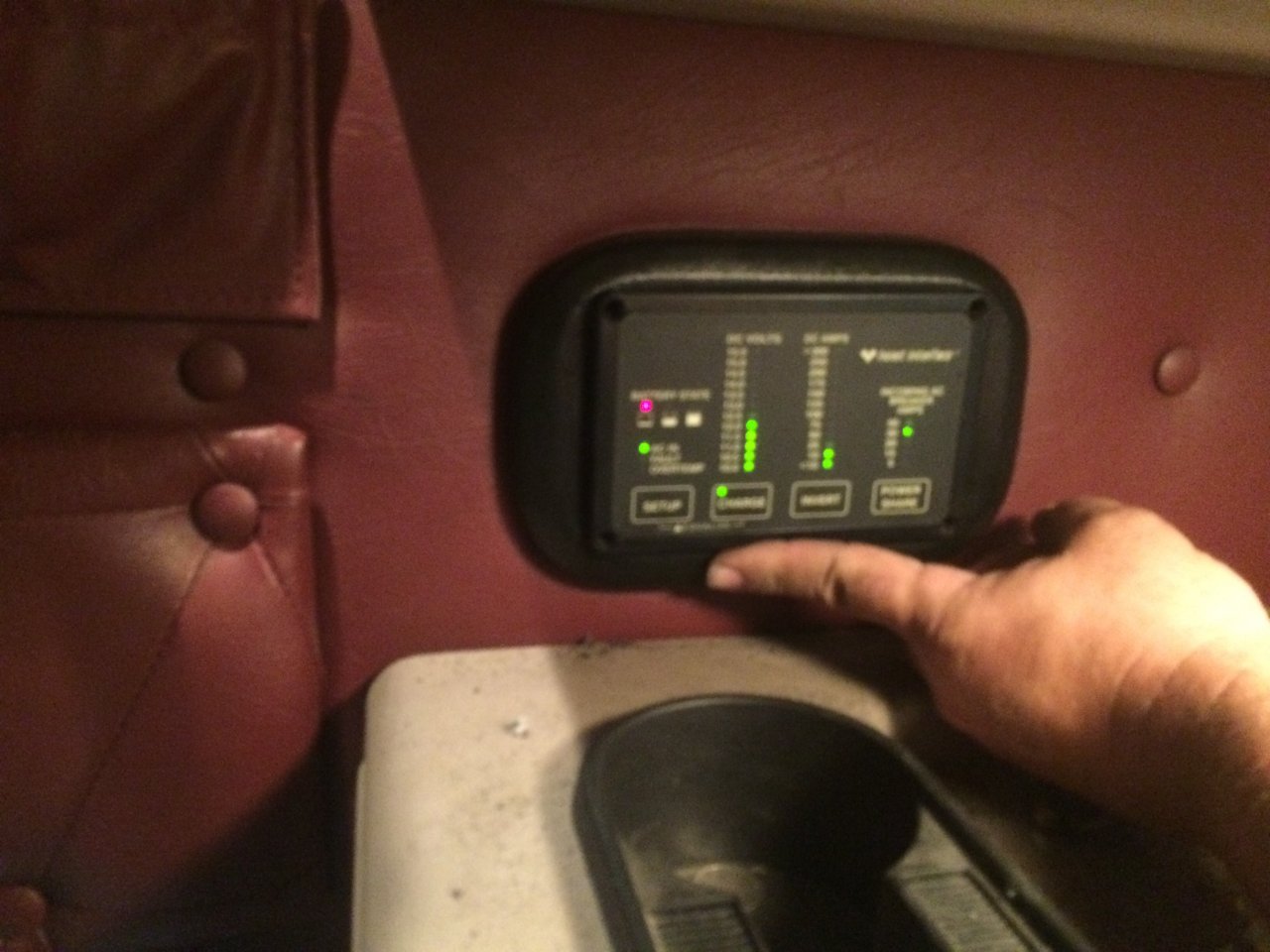

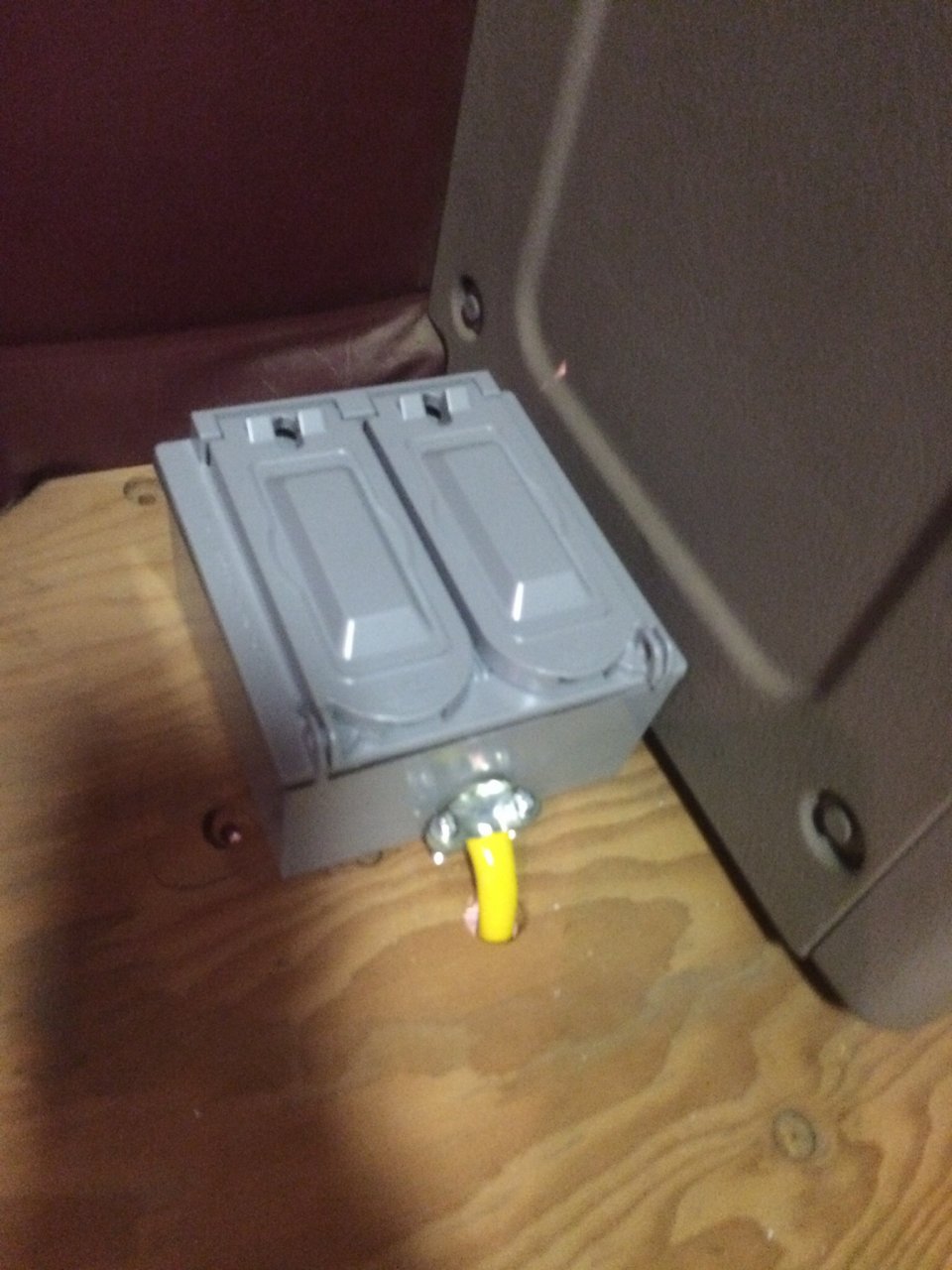

    Got her all Instaled. I need 4 screws for the control panel. I put it in where the ashtray in the sleeper was. Only had to trim just a bit and it slid right in. I want to get the generator mounted in a tool box on glides. That way I can open the doors and slide it out like a drawer to fuel and maintain. I got a room A/C unit and a small room heater. Instaled a dorm fridge and micro I had laying around. With the cab closed up I fired the gen and I would say it is quieter than the truck running. I have parked next to a few with APU's and I think it's quieter than an APU on the next truck over? I will try and park away from others or next to refers to try not to piss anyone off though. Supost to only be 68db and seems Relitivly quiet even out at the shop where there is no noise at all.
    Thanks for looking. J

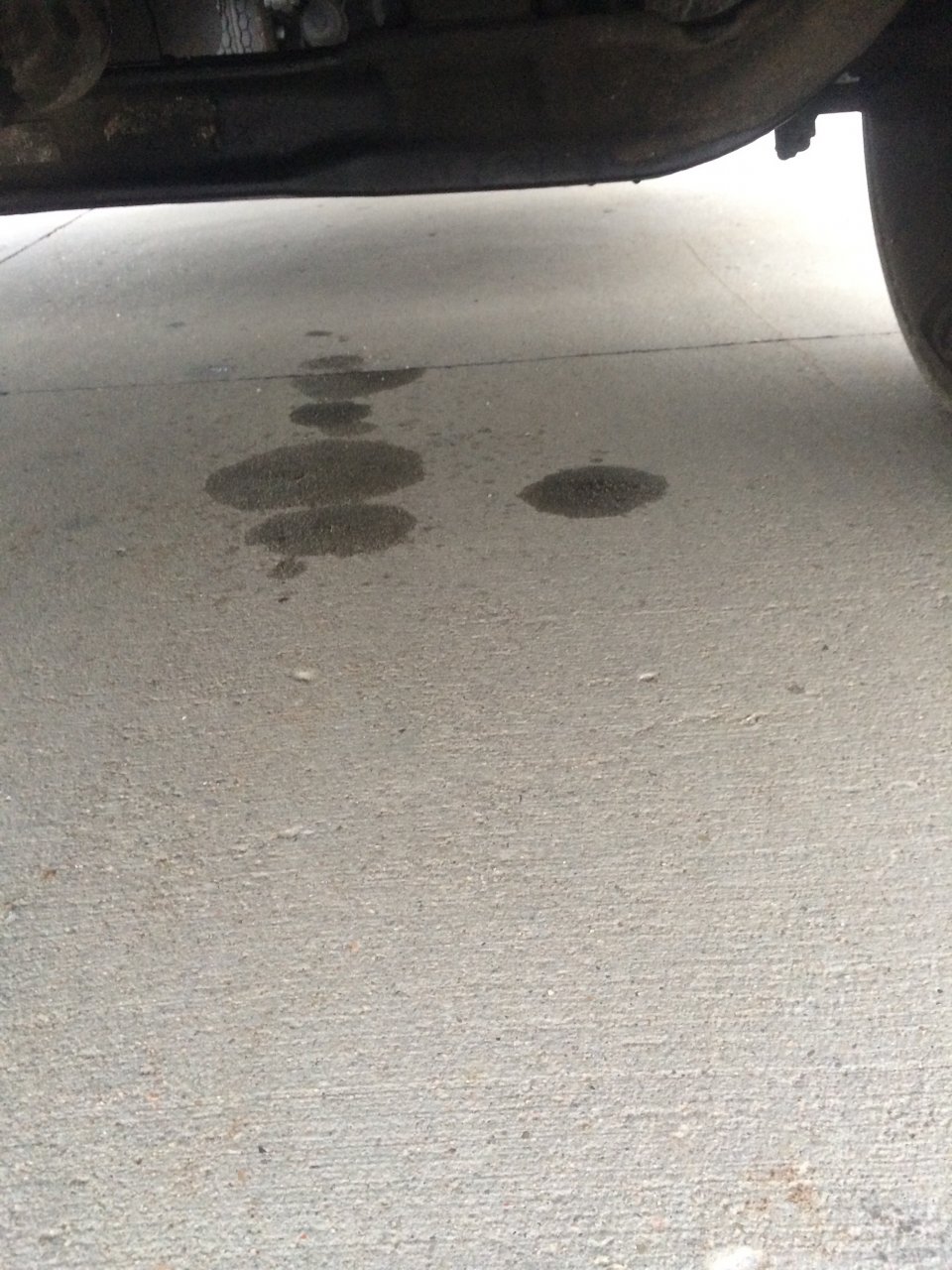

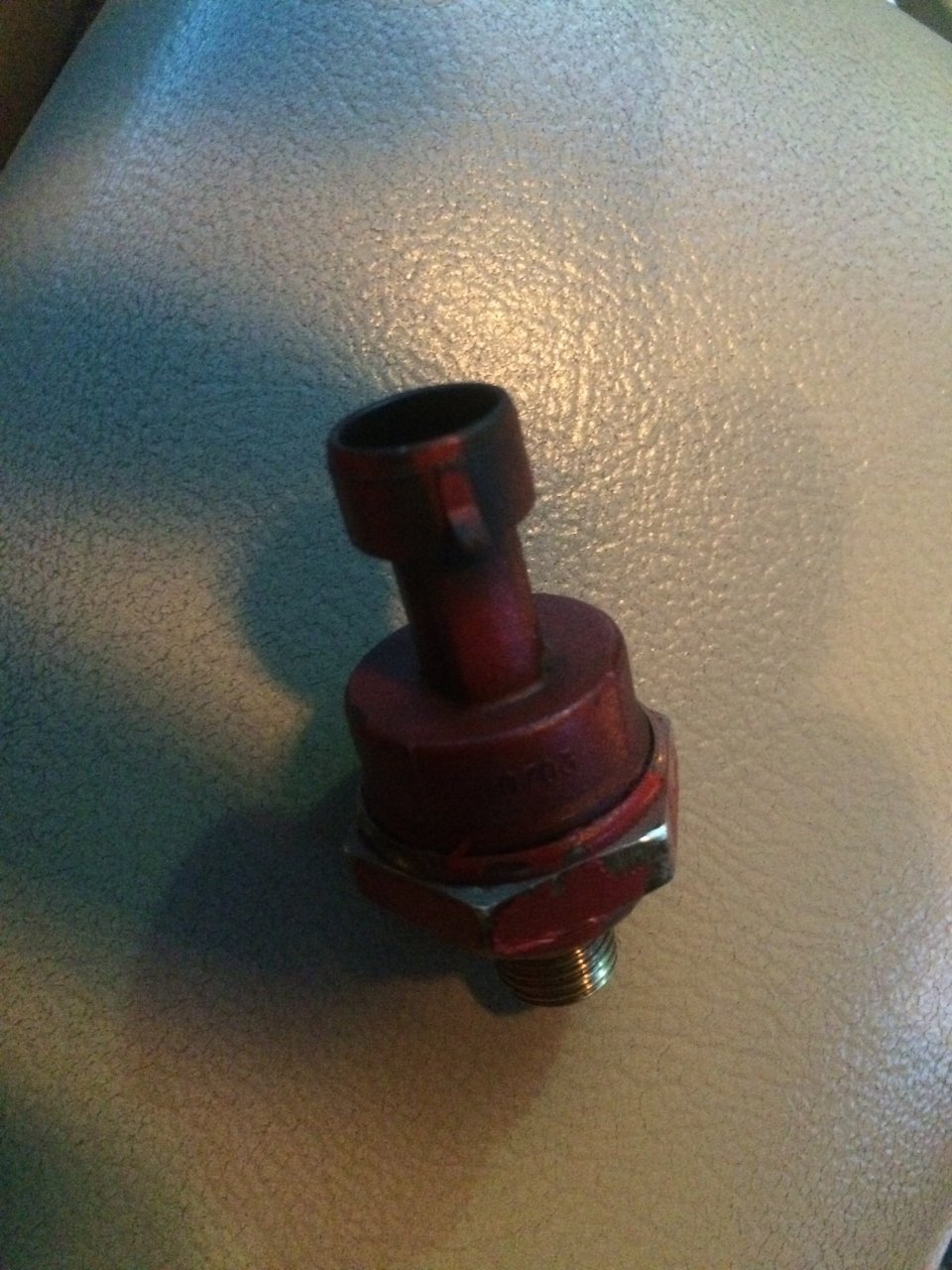

    Noticed a drip early in the week. I have been watching it but this morning it's getting bad. Took a load from Ohio to nebraska to pick up from what I thought was a good coustemer. They canceled the load on us because some one took it for $600 instead my $1000. Rate. Now nothing but crap off the board over here. Going to dead head to the barn and start looking into this. I can't really see where it's coming from unless I pull a bunch of stuff off the motor.
