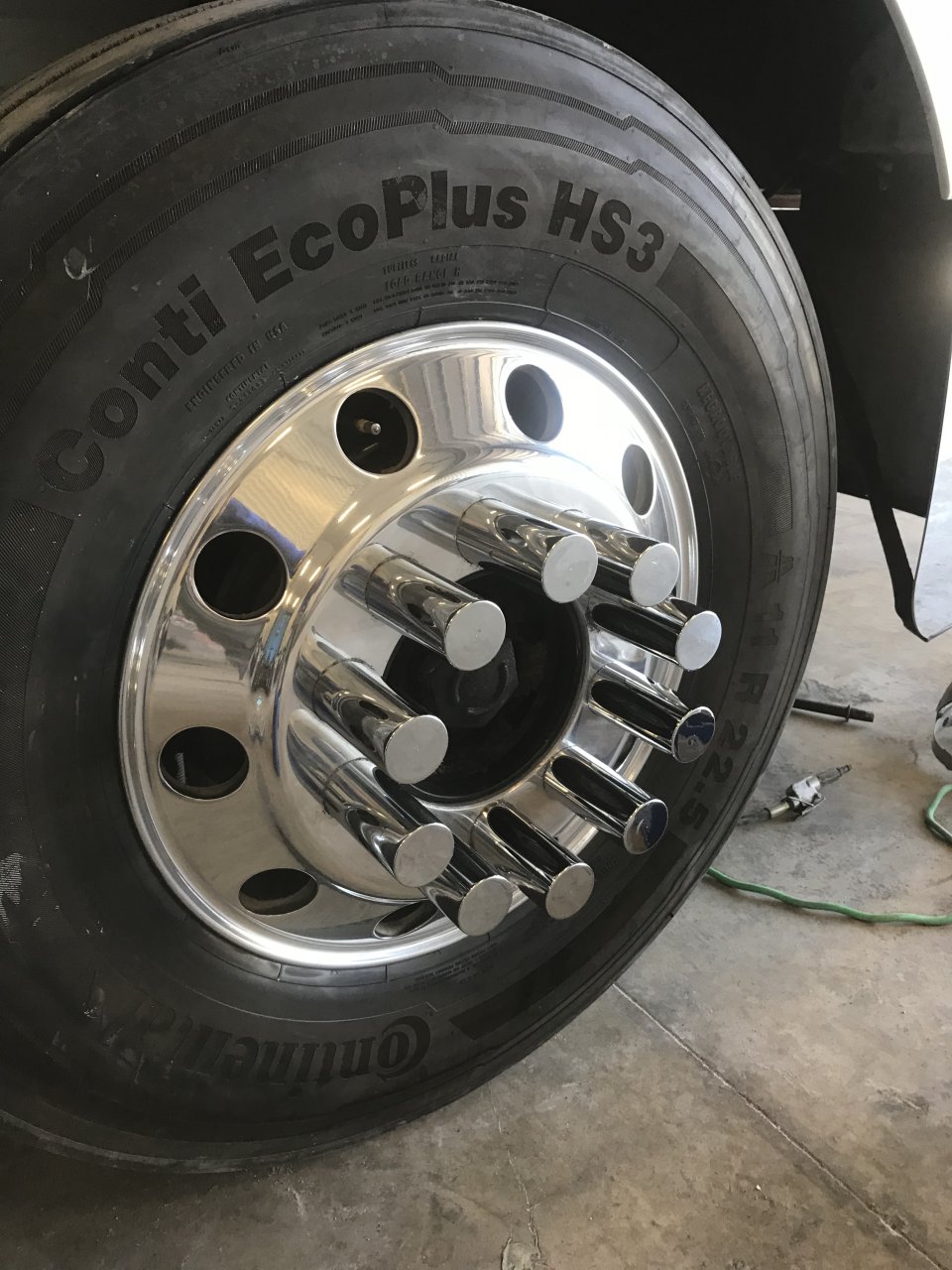

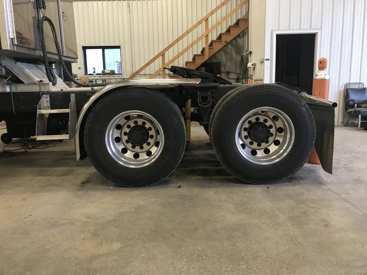

    These are some of those new wheels after a year
    Before 50C89C19-8D62-4DB0-8C7E-B6EB49A252D1.jpeg after 10 to 15 min of polishing with buffs, no sandpaper. If you zoom in you will not see any pitting. 1E6DE450-1218-4982-B560-A402661242EF.jpeg

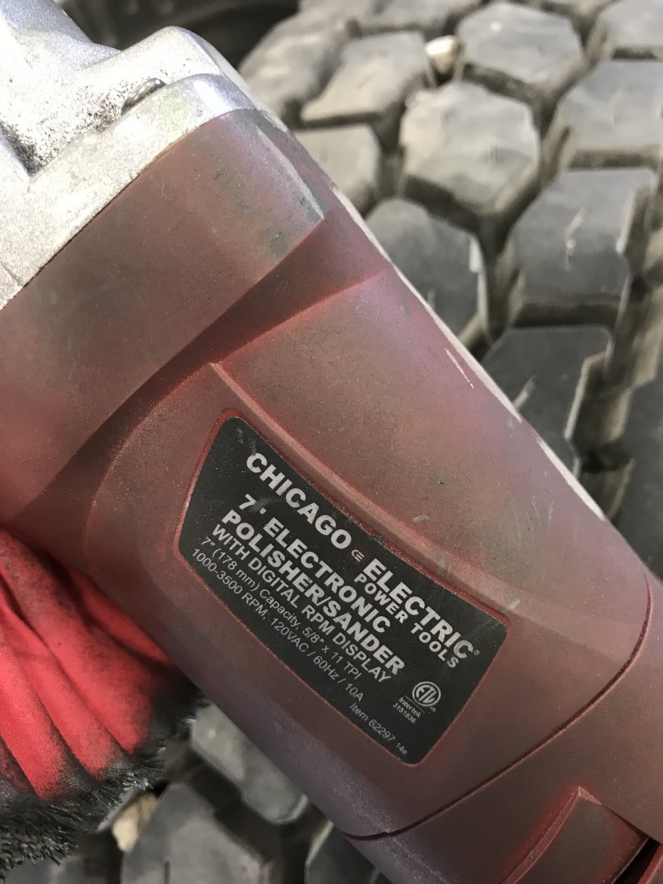

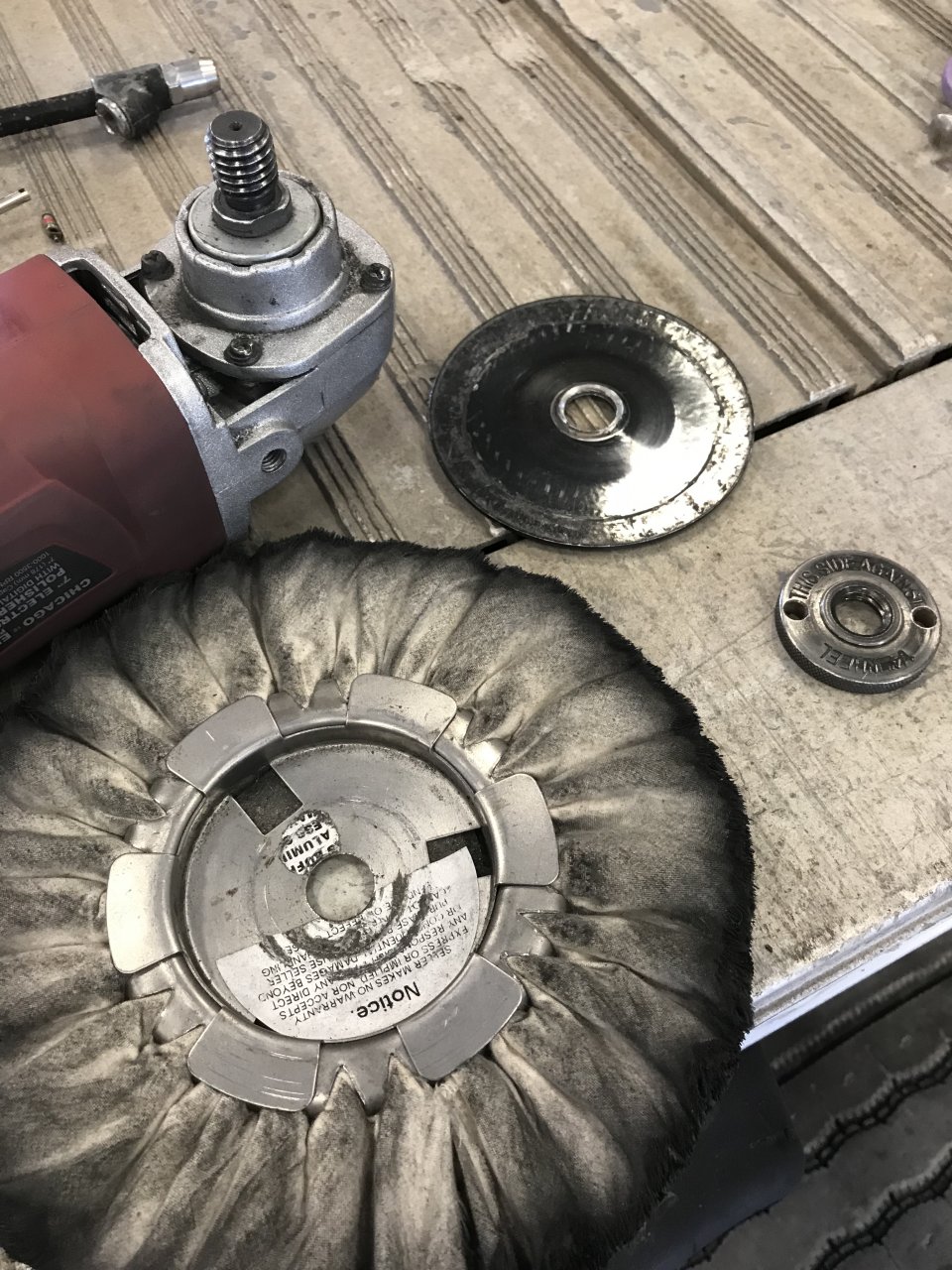

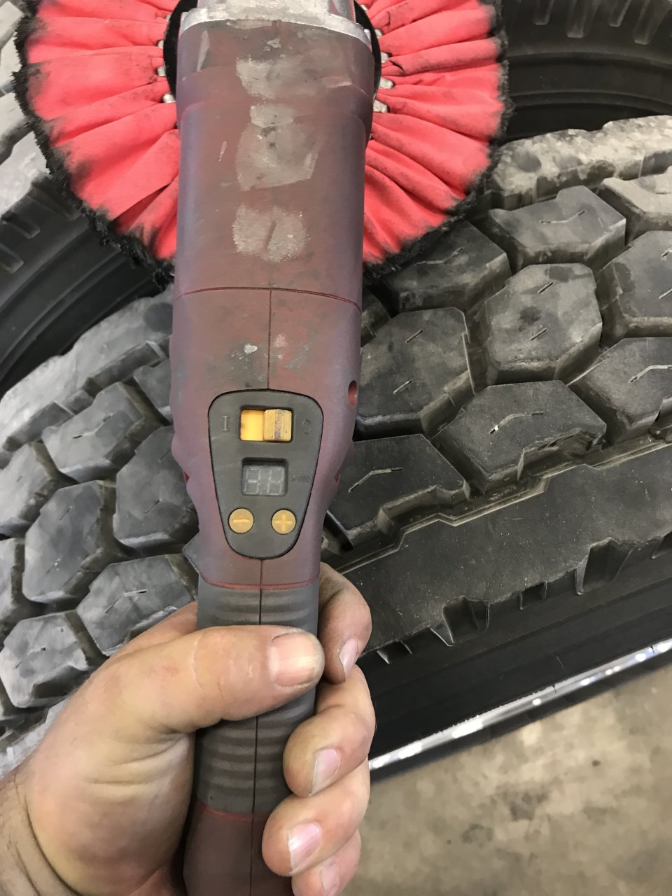

    Harbor freight buffer 50A23565-33DA-4D49-A2A3-A96EE9C7AF14.jpeg 81700E02-F6B2-4686-9068-5413644D1E90.jpeg you will need this black flange (you can get anywhere you get polishing stuff) and a nut (I use the one off me dewalt 4” grinder) The buffer doesn’t come with these items.
    I would start with a white buff. Any brand works. You don’t want a flannel. They are too soft. You want one like this with white polishing compound. You also want to get a rake to clean the wheel. ( photo later)
    This is a good way to practice your technique and can’t really do to much damage. The results will be stunning even if the wheels are nasty. 77F89C96-EB7D-4715-A1C6-A84B67D13DA9.jpeg

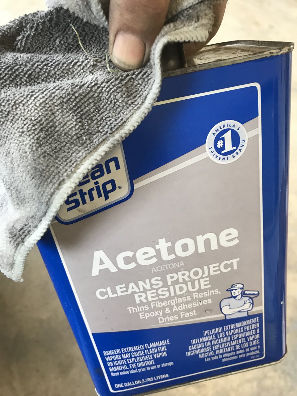

    Once your done buffing there will be compound left on the wheel. WHipe this off with acetone and a clean microfiber towel. D9EB3DA7-BCE4-48AC-B667-98AD12D0A0F6.jpeg

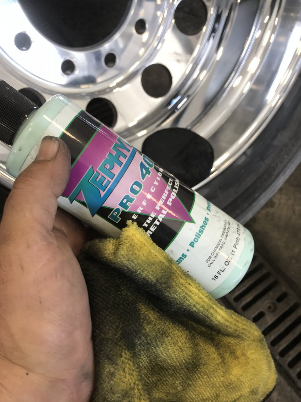

    Once the residual compound is all whipped off (there will still be some haze left) hit it with this stuff on a little hand pad then polish off by hand with a clean micro fiber towel. FBBBCD10-5DB0-4B80-84AE-75DE2BC097E8.jpeg
    This will be the best bang for the buck and a great way to bring back the luster to anything polished aluminum. You will love the results.

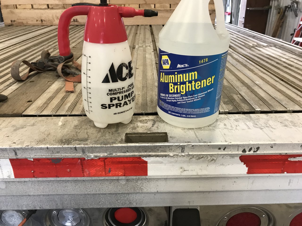

    Ok let’s get a little more serious:
    Acid clean the wheels. Don’t use any of that citrus or biodegradable crap. This stuff is serous. You may have to do them 3 or 4 times. Once you spray it on agitate it with a scotchbrite pad ( green) round and round , not in and out!!! rinse and repeat until aluminum is white with no streaks. If there is streaks keep going and scub a little harder and let it sit a little longer. The streaks are hard to sand out.

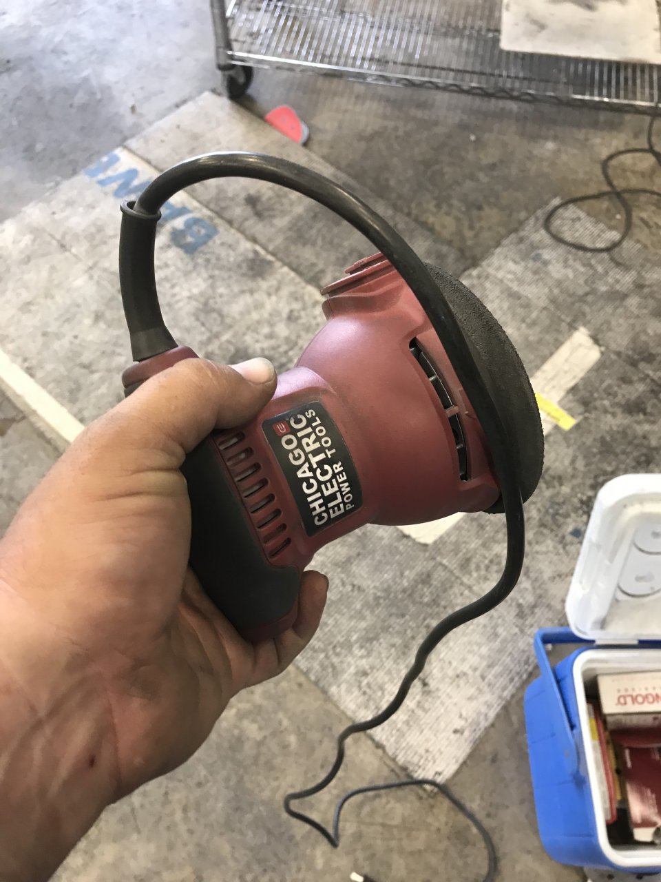

    I use a 5 in harbor freight da sander. I’ve been using it for 3 years. BD1ACA9F-EC63-4B74-8170-B19FE060BA89.jpeg

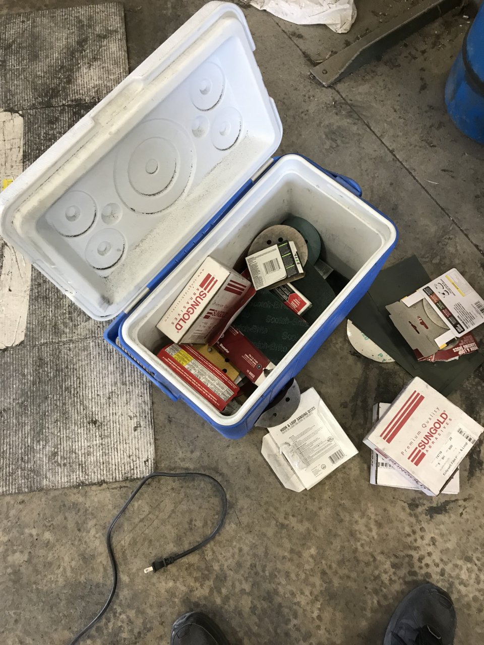

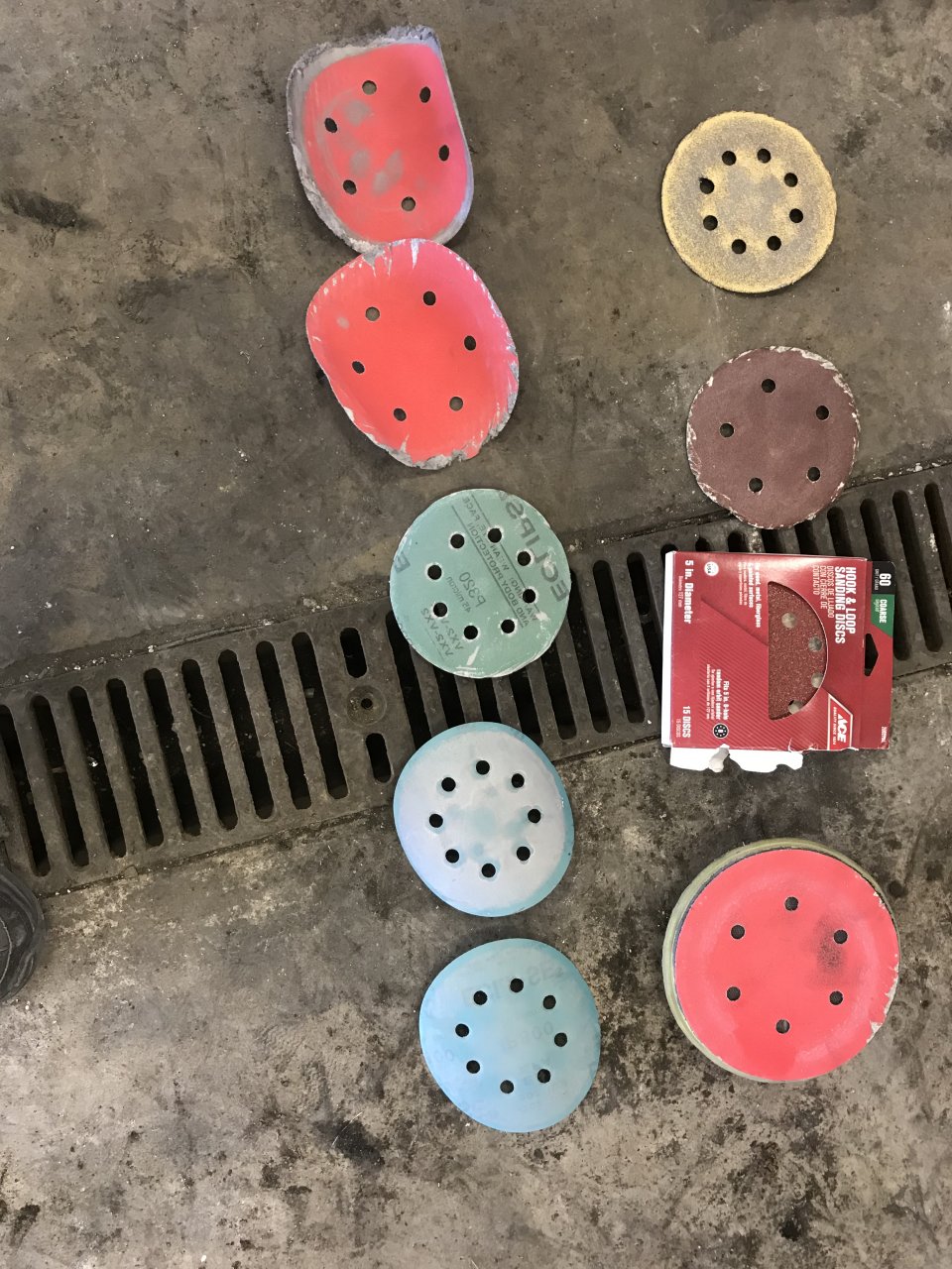

    I keep all my sandpaper in a cooler to help keep the moisture away.
    60, 80, 100, 150, 220, 320, 600 and 800. You won’t find the 320, 600 or 800 at the store. Must order on line.
    I usualy start with the 150 grit and work my way up to the 600. If you have really bad spots use the rougher stuff. You’ll see it when you are done with the 150 because you can’t sand out the pits or scratches. Don’t use anything rougher than the 150 in corners or edges. You will never get it out no matter how much you sand!!!
    The 800 was not a good purchase. You will actually be polishing once you start using the 320 and 600. The 800 would be great for a show truck but we are working on working trucks.
    Sand, sand, sand some more.
    Try not to gouge with the edge of the paper, keep the sander moving and, again try not to gouge the aluminum!!!!!
    Then sand some more and keep sanding!!!!
    The more you sand the better the polish job will be.
    Did I mention sand some more!

    I got like 70+ hours in it and I’m sore as ###& from polishing alone. For 10 wheels, 2 tanks, 2 steps, front bumper and the headache rack. I put another 15 or so hours into other stuff too. 10 days worth total.
    wish I could just wash the shine on?!?!

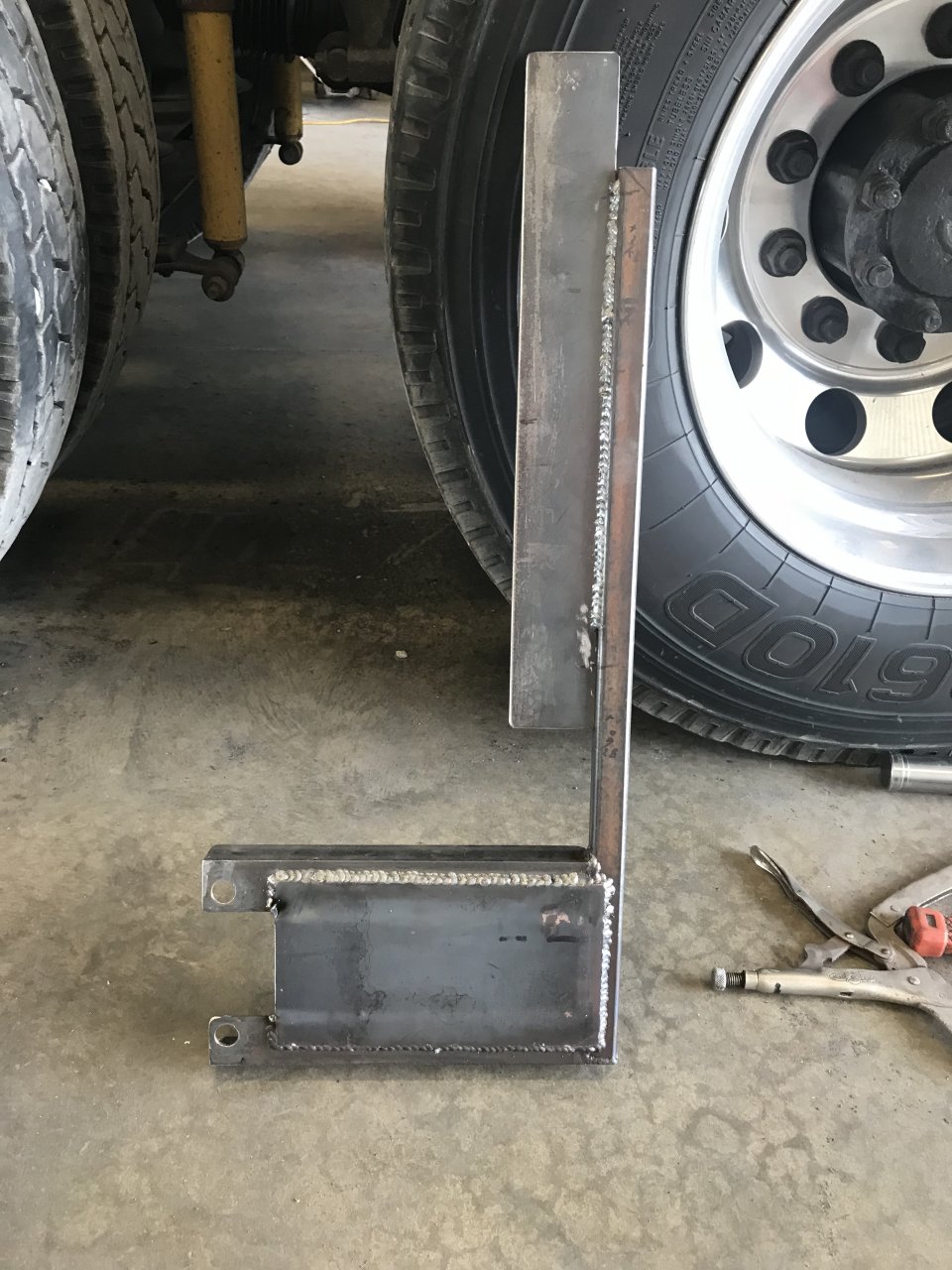

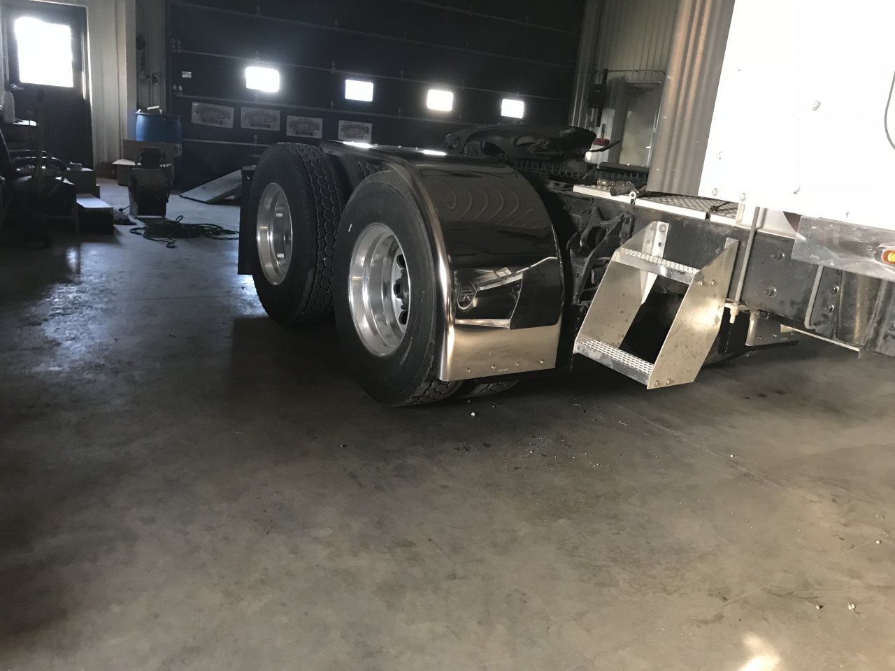

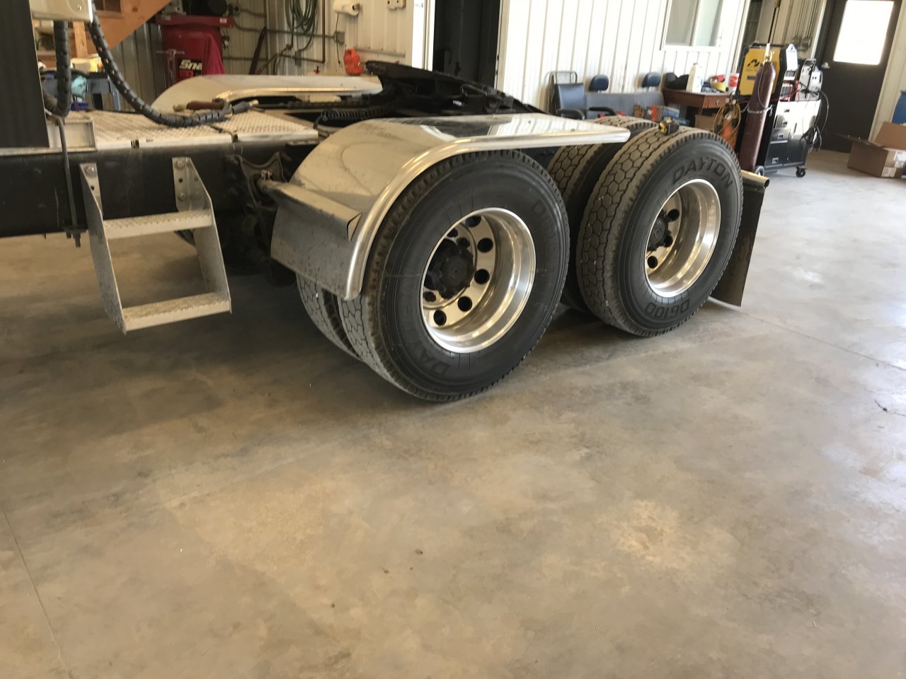

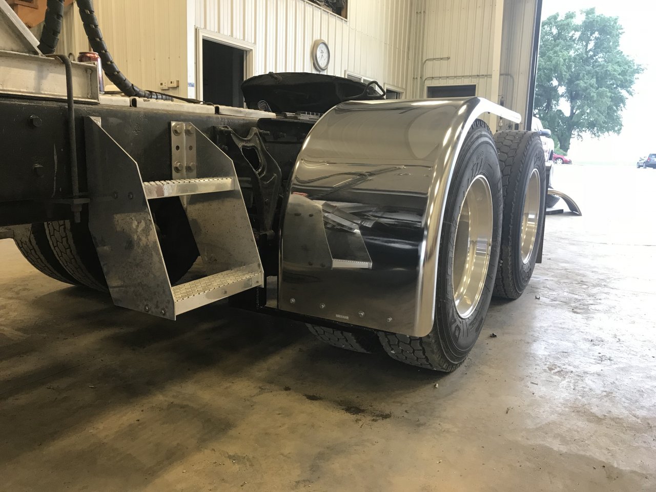

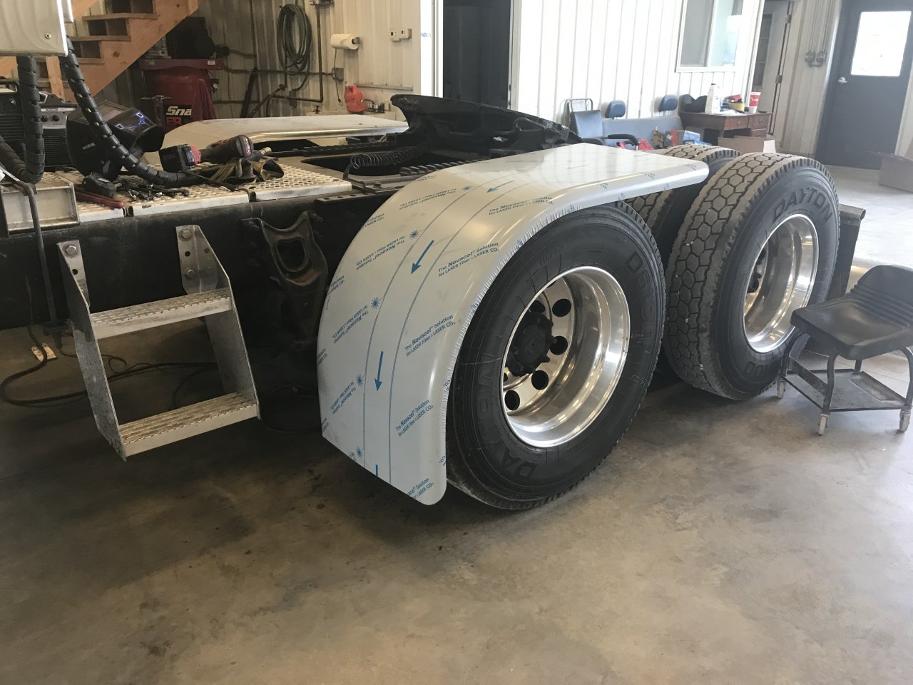

    Since I quit smoking I bought myself a present. A new set of low Ryder Hogebuilt fenders. I made my own blind mounts for fun!!( haha) A15A105F-D8E9-40CF-8623-2FDEF8AAB45D.jpeg 7C7C16E3-5EDF-4DCD-AE69-95B2180B79DA.jpeg AC77A7D5-E18F-4D7D-9DBE-5045CBB2FB4E.jpeg

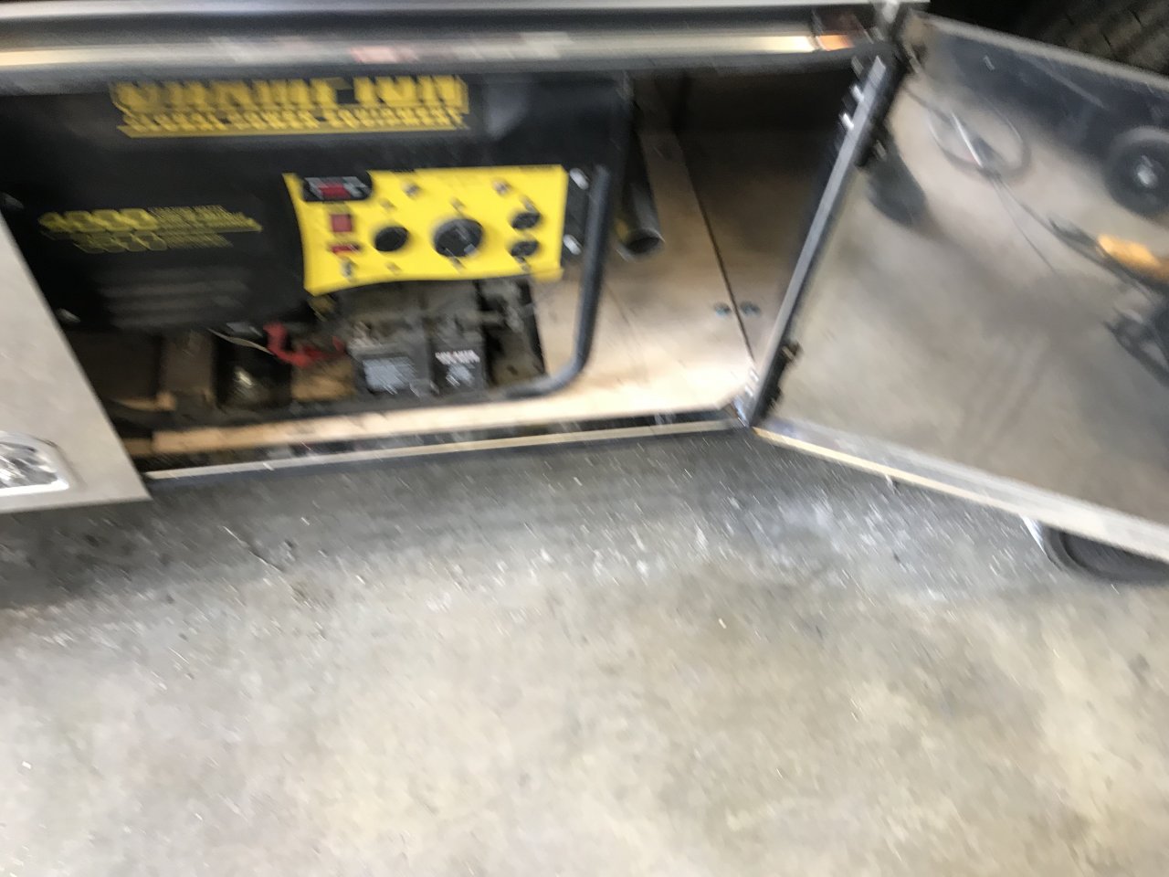

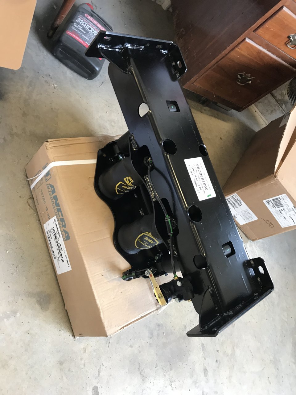

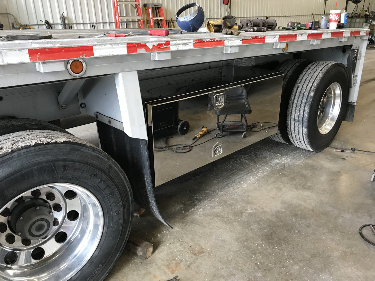

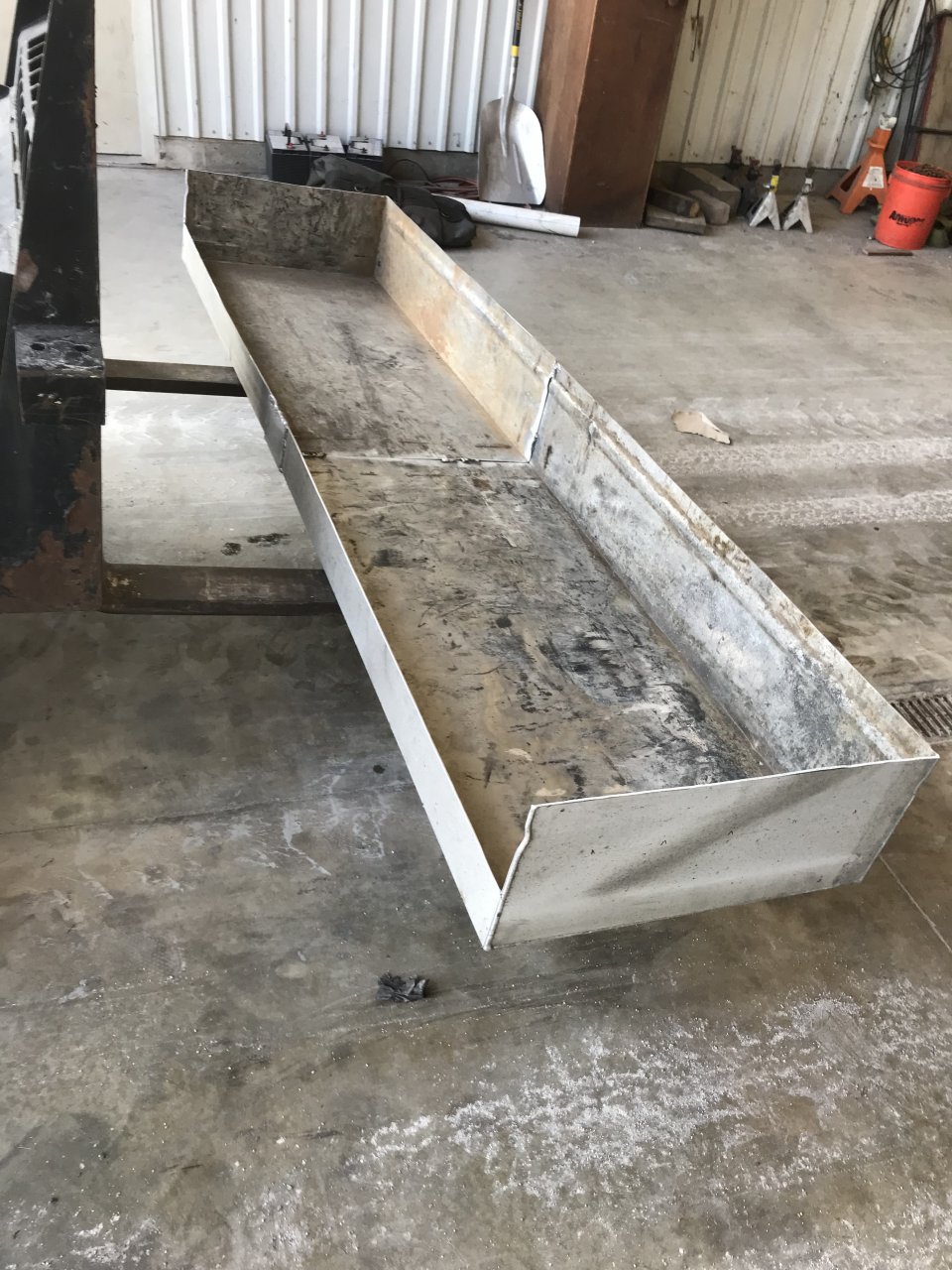

    Lost an airbag on my cab suspension. The ld unit came out as handfuls of rust. New unit showed up in 3 days as a complete unit for $750. Money well spent in my world. F11463E6-5FDF-4C0E-BE9D-4666968CFA14.jpeg Last new tool box instaled. 9C7843DF-BA47-485E-A27C-E219F242BCF9.jpeg generator installed in the new box and old box is gone. 5E15A14A-D569-4D62-9D4D-57AB330E7079.jpeg cut up two of the old boxes and made a donnage rack DB7F1E2F-E3F2-48D3-976F-76C4A7A31614.jpeg 833A1339-D625-4432-9E1C-51EE209BB1A7.jpeg
