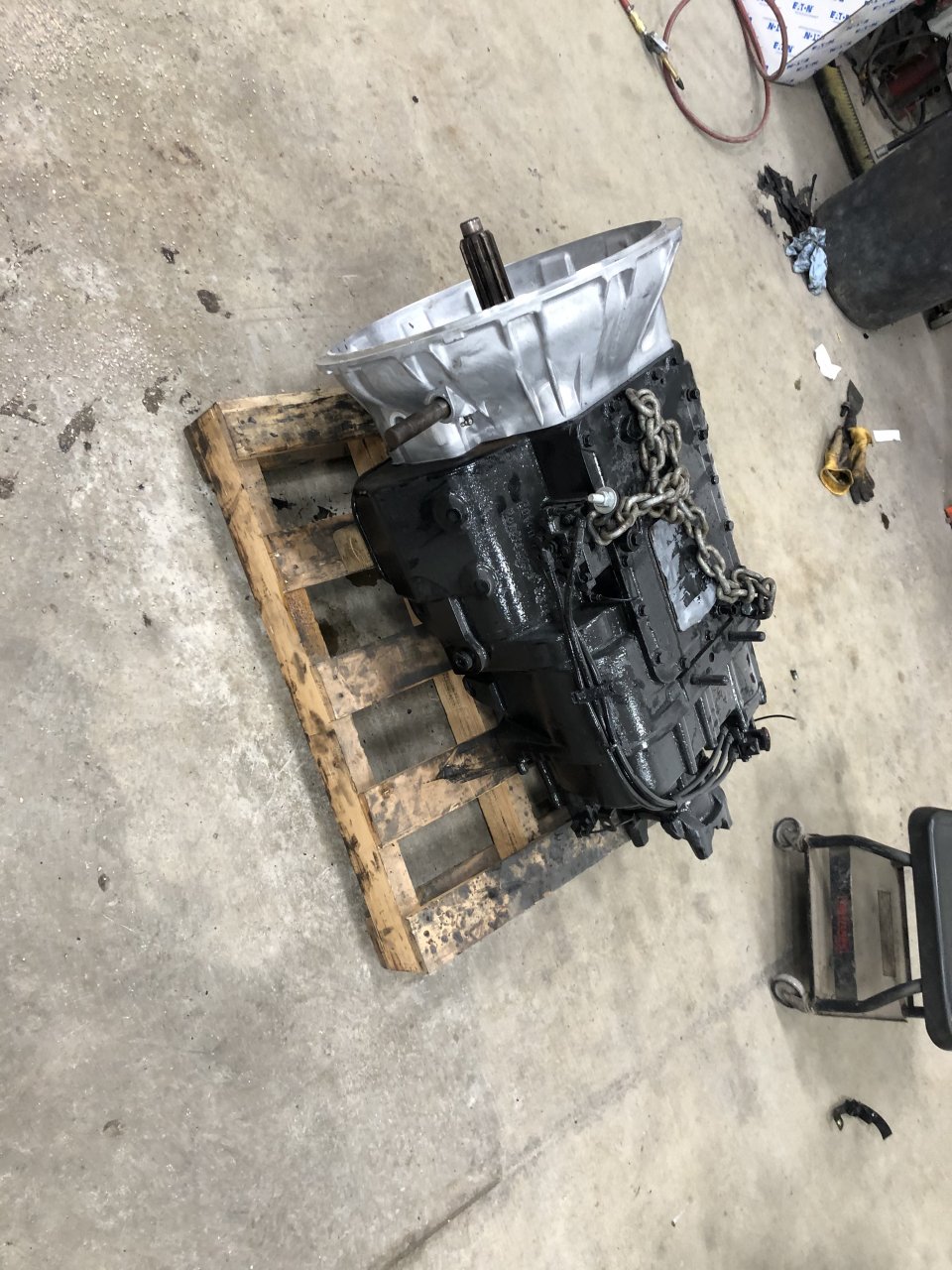

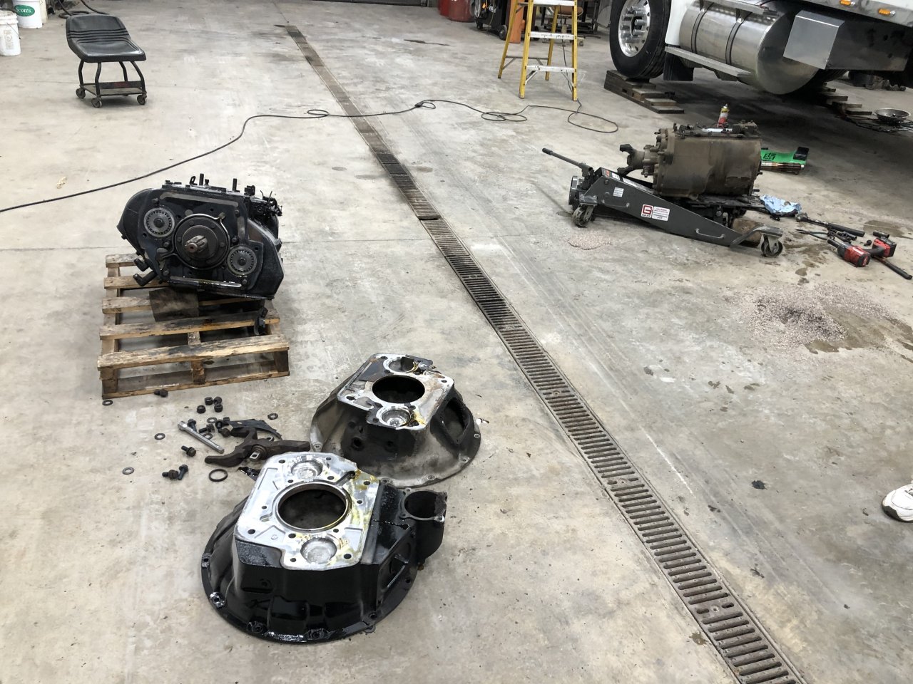

    Spent last week doing annual maintenance under the hood of the truck.
    Overhead with new valve cover gasket.
    Fresh full service including water filter
    New belts
    New front cab mounts
    New windshield fluid pump
    Full engine degreasing and pressure wash
    Now working on upgrading to a 13 speed. Had trouble with getting the correct bell housing. Got er all fixed up now. Going back in tomorrow. B0B287E5-85E3-4B29-BDCF-D112B849F613.jpeg D00AF204-1331-4D47-8E65-CC3FBD7F96D5.jpeg

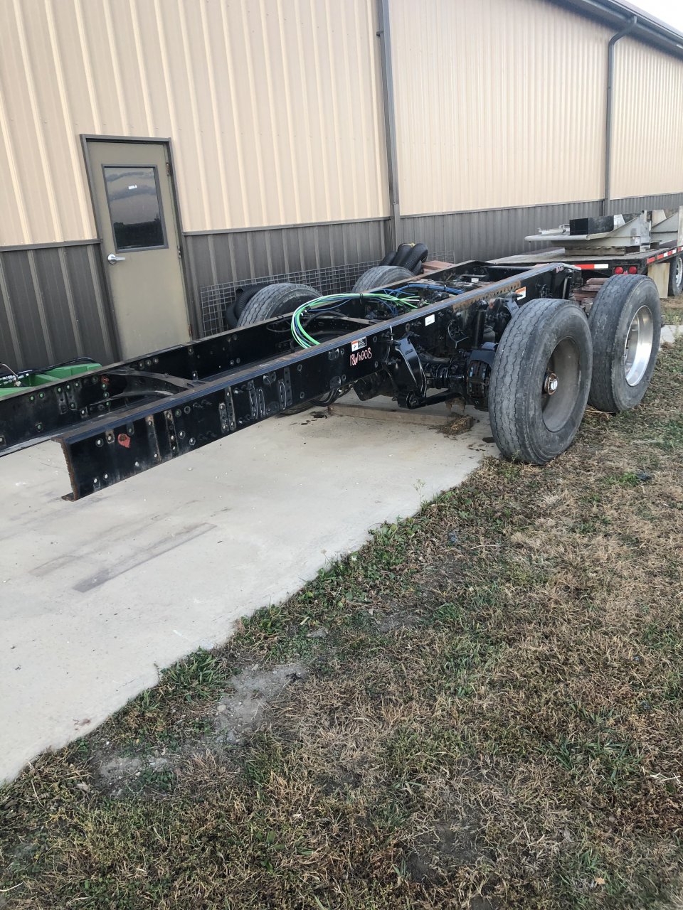

    New complete cut off with only 60k miles on it with disk brakes starts next week. 3.08 gears. Will be adding about 3’ to the length at the same time. 8461DFC3-B7F3-41F6-8A11-C054E3E8C6F2.jpeg

    Where did you get this cutoff?

    Vander Haags
    Its a Freightliner unit but the frame dementions are the same.
    I was able to get 7’ in front of the front hangers because that hadn’t cut it off yet

    What year and model Freightliner? What did something like that run you cost wise?
    I like where your going with this. I would like to add 3 feet of length to the sleeper on my 9300 , I've located a sleeper and I am a glass man so the roof is a piece of cake to me .
    Would be almost quicker for me to buy a nearly new cutoff than reseal all my 23 year old rear ends and completely replace the complete brake system and suspension.
