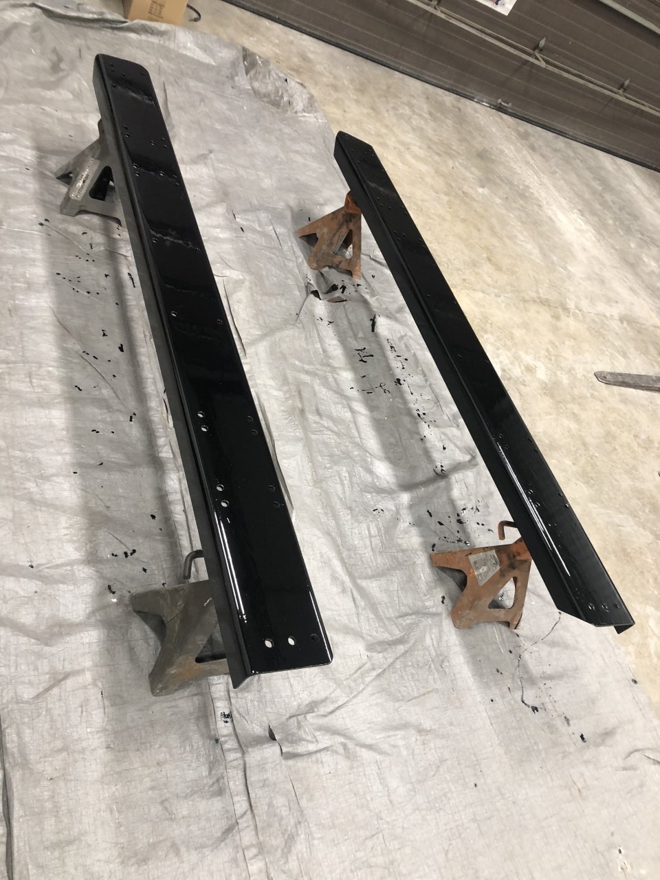

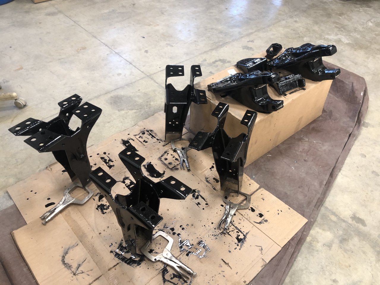

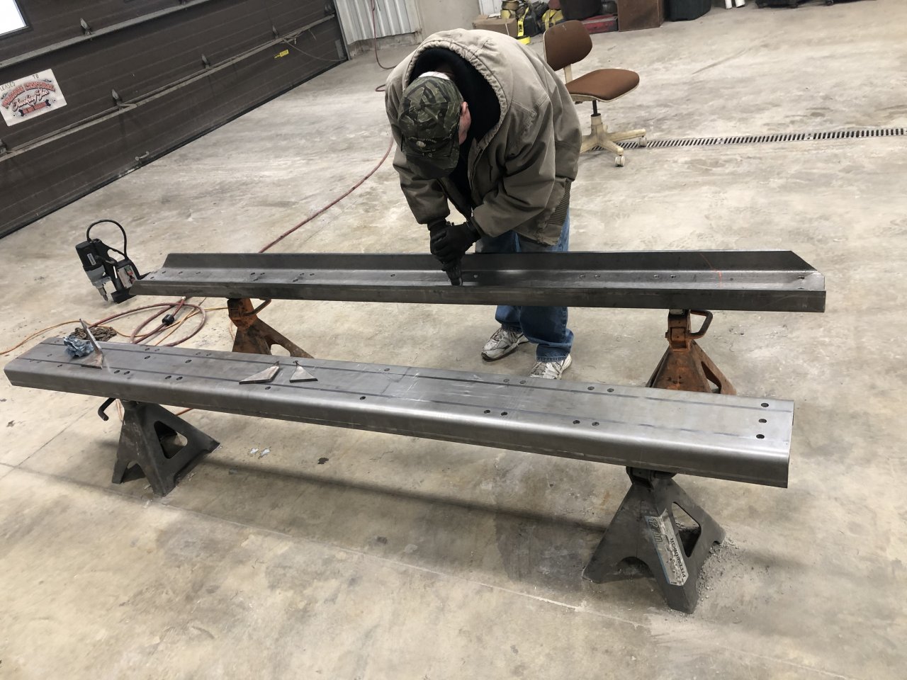

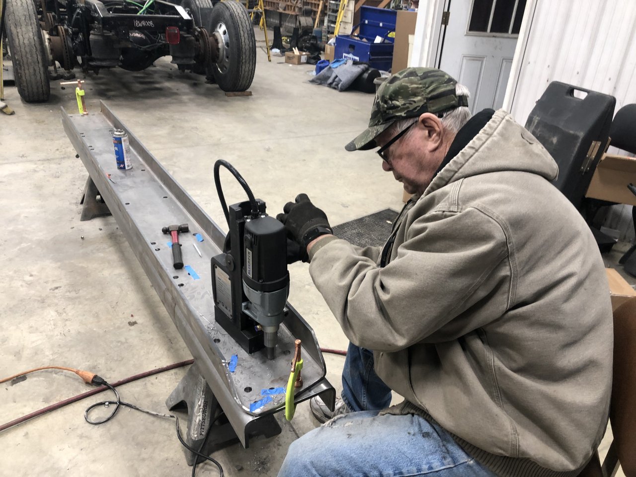

    All prepared and ready to put the liners in tomorrow. Coated with Cassis saver. I have to modify the crossmembers to account for the liners. They will be sectioned in the middle and a couple straps across the butt joint of the crossmembers. Hopefully put them back in Friday morning then figure out the driveline angles. Maybe even a test drive on Saturday if the snow holds off? 68C290A3-9FCB-4ADD-B62E-A51C1052A05B.jpeg 0058841F-17F9-41FC-B479-03CB19DE1048.jpeg

    Wow never seen liners that long it a good thing you will never worry about that frame breaking. So many think a weld and diamond plate is good enough it only a start. Great job!

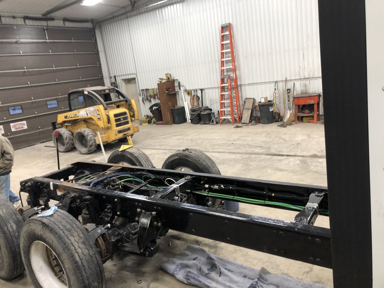

    Liners in and the crossmembers cut and the outside ends epoxied and ready to put in tomorrow. I had almost enough bolts to do the job but had to stop and pick up $90 worth. AFB393E7-0377-4F94-B639-65BB3E8A92B6.jpeg 0EA3B40D-E372-4F1B-AB7C-465F142CF23D.jpeg

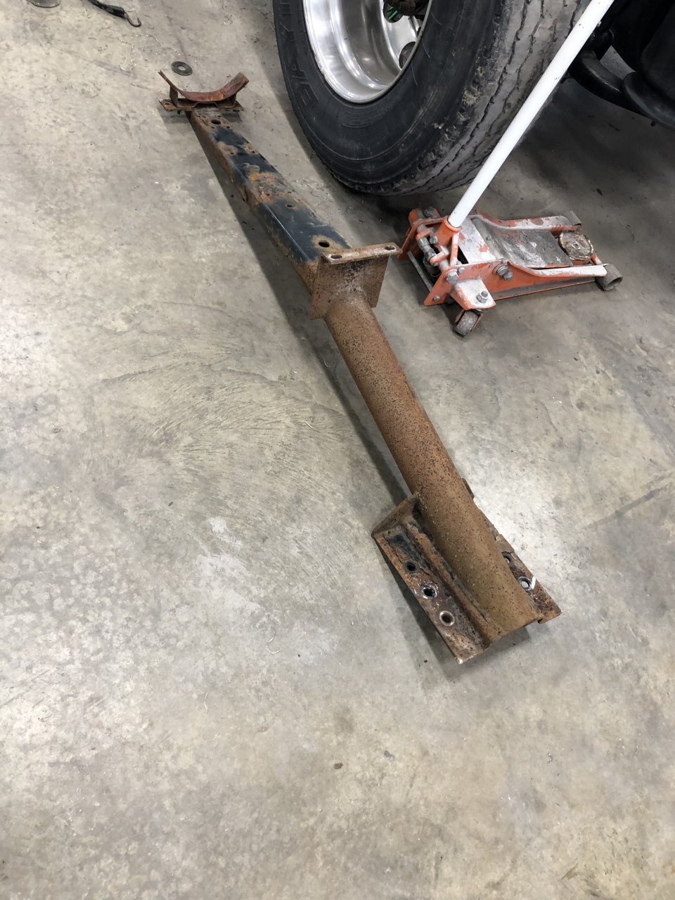

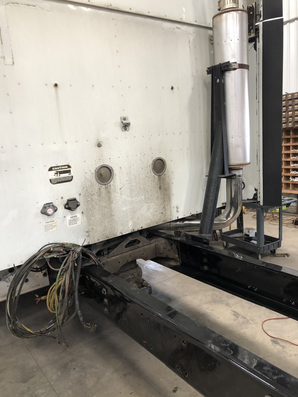

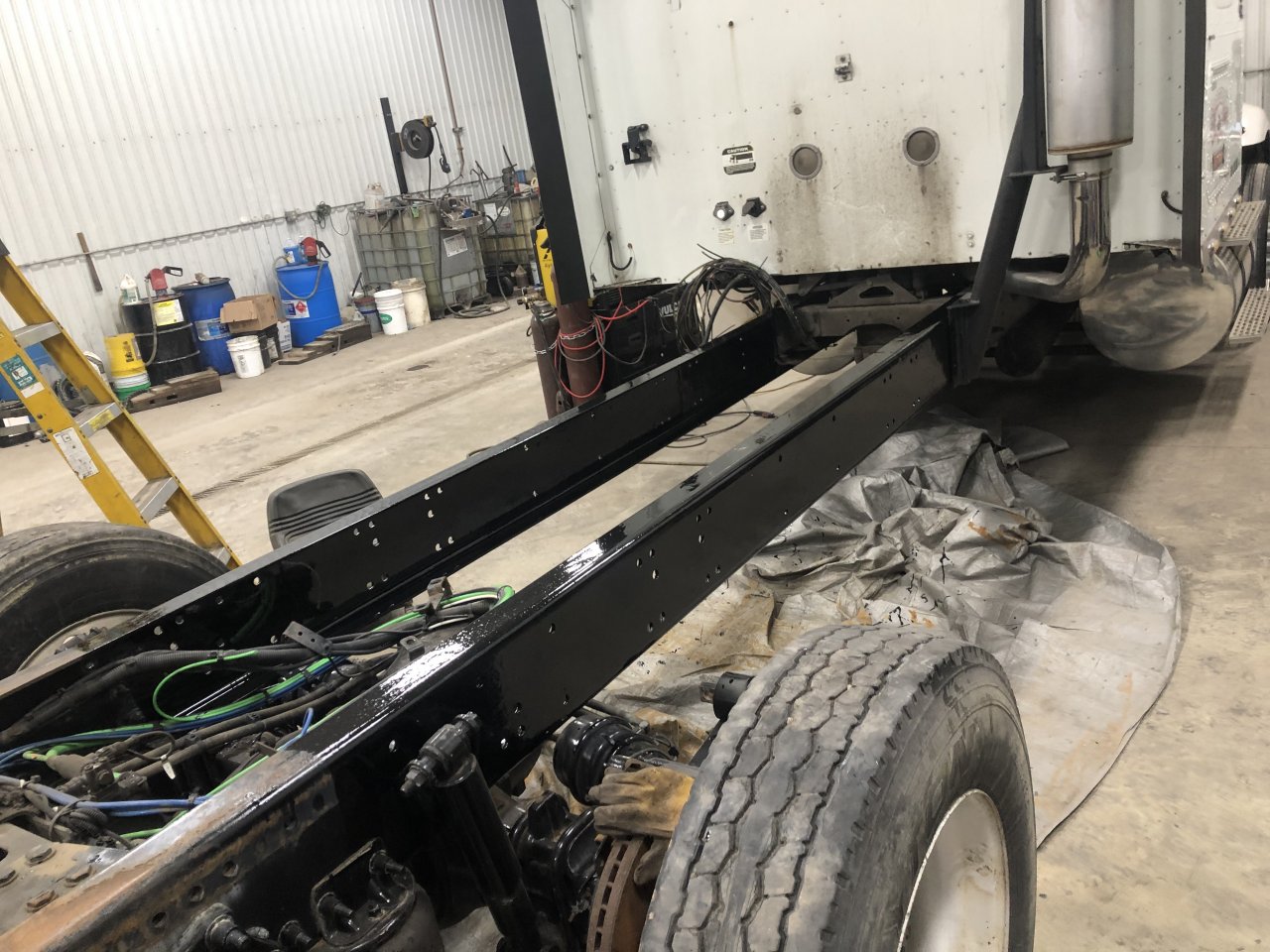

    Kinda did a lot of running around today. Picked up a second muffler bracket for the drivers side. Crossmembers are in and the front drive axle rehung. 470DE114-C19B-4E7A-BAE6-B43C1DCC8D41.jpeg AC31855B-EF83-45EA-809D-FCCA19568753.jpeg E9ED2A62-DA31-480C-B03F-058AC7972F1F.jpeg The old 3’ liner I was originally going to use didn’t fair to well against my wife. C4A186DC-44DC-48A1-B36A-0651CF2B0919.jpeg D7AB0D29-BEC0-48F5-9689-A6A69BBF0FF6.jpeg
