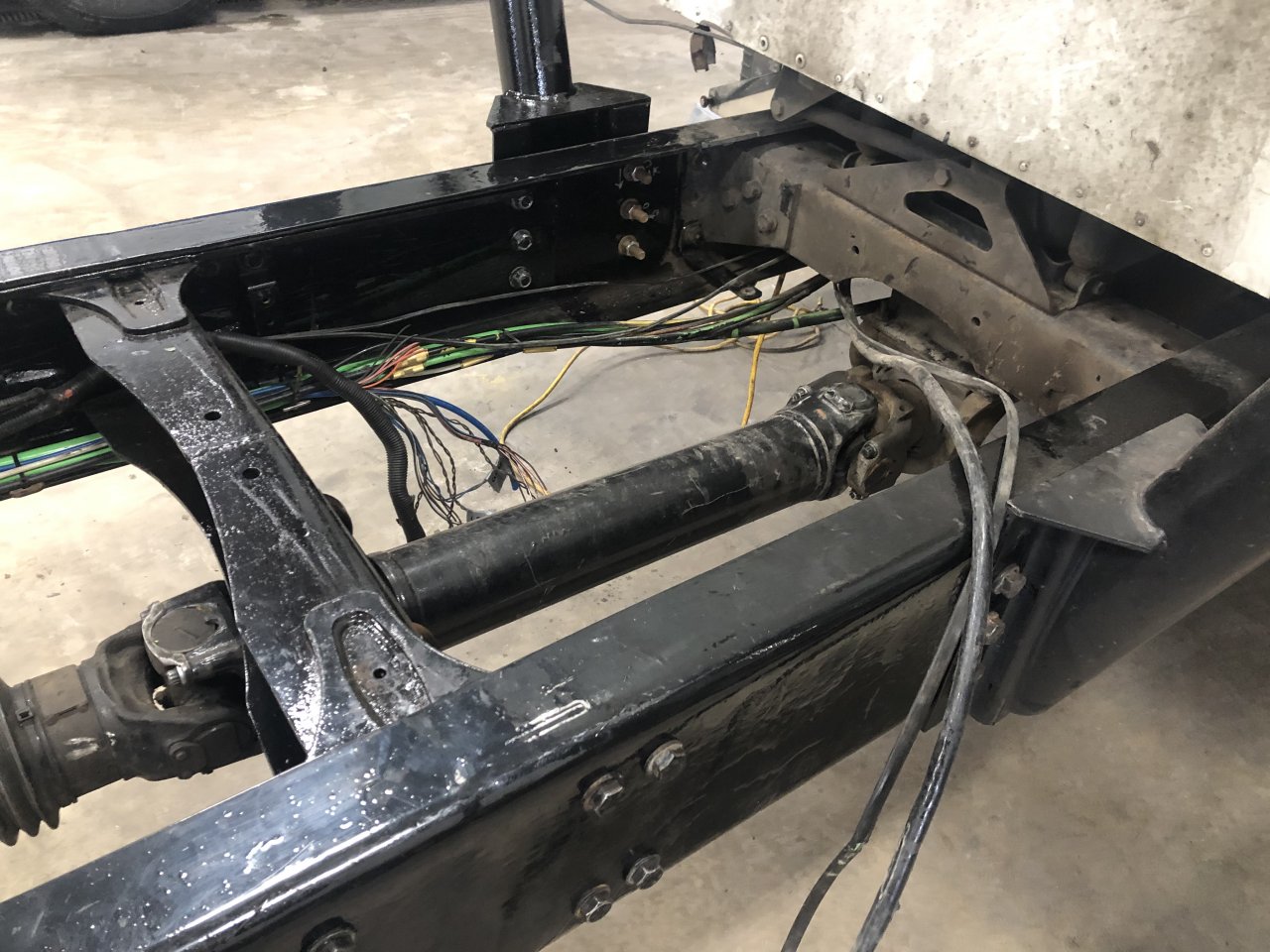

    Drive line is in. Picked up some airline fittings today. Gonna see if we can make er roll on her own tomorrow? EEB75CDA-34E3-4FCA-85BA-FB6B03263F6A.jpeg
    Ill rehang the carrier bearing in the morning. Pulled it apart to paint under it.

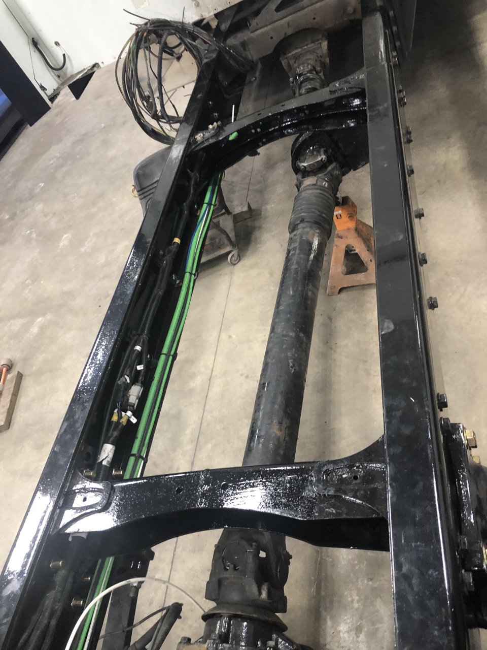

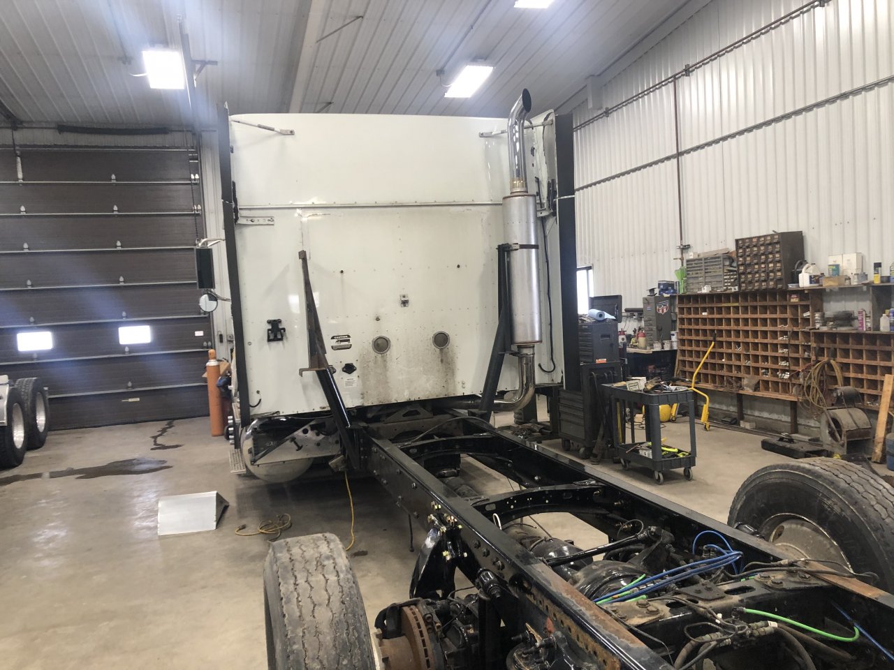

    Few more hours today installing the stack bracket and hooking up the airlines. I need to make a couple of adjustments. Traced all the wires out including the ABS system. I’ll do some soldering tomorrow. AC29EBF7-50F3-44BF-8E78-1AC5D9849DE2.jpeg 8A2CA2CE-CA62-468A-9629-2A3FD429B61B.jpeg

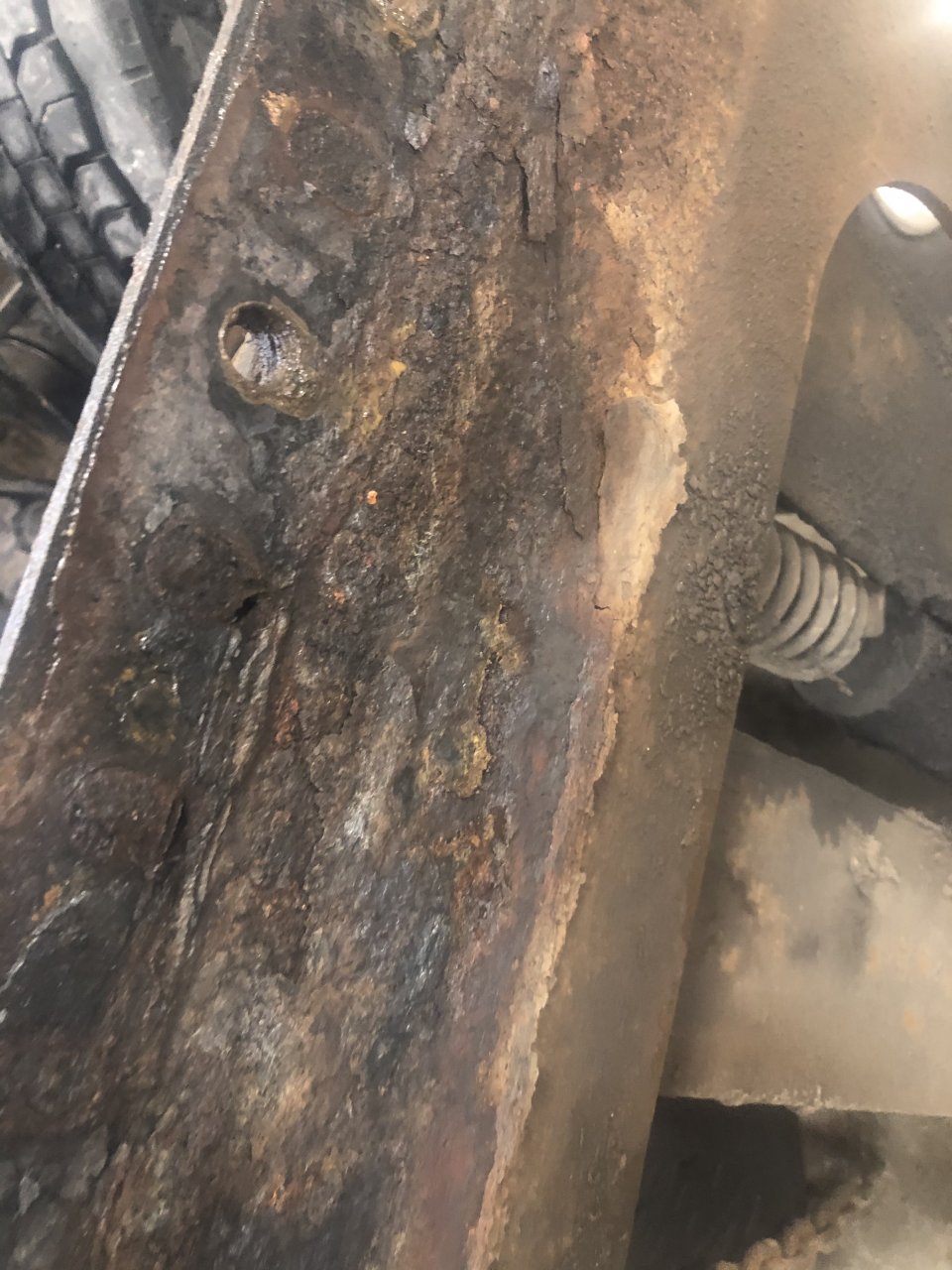

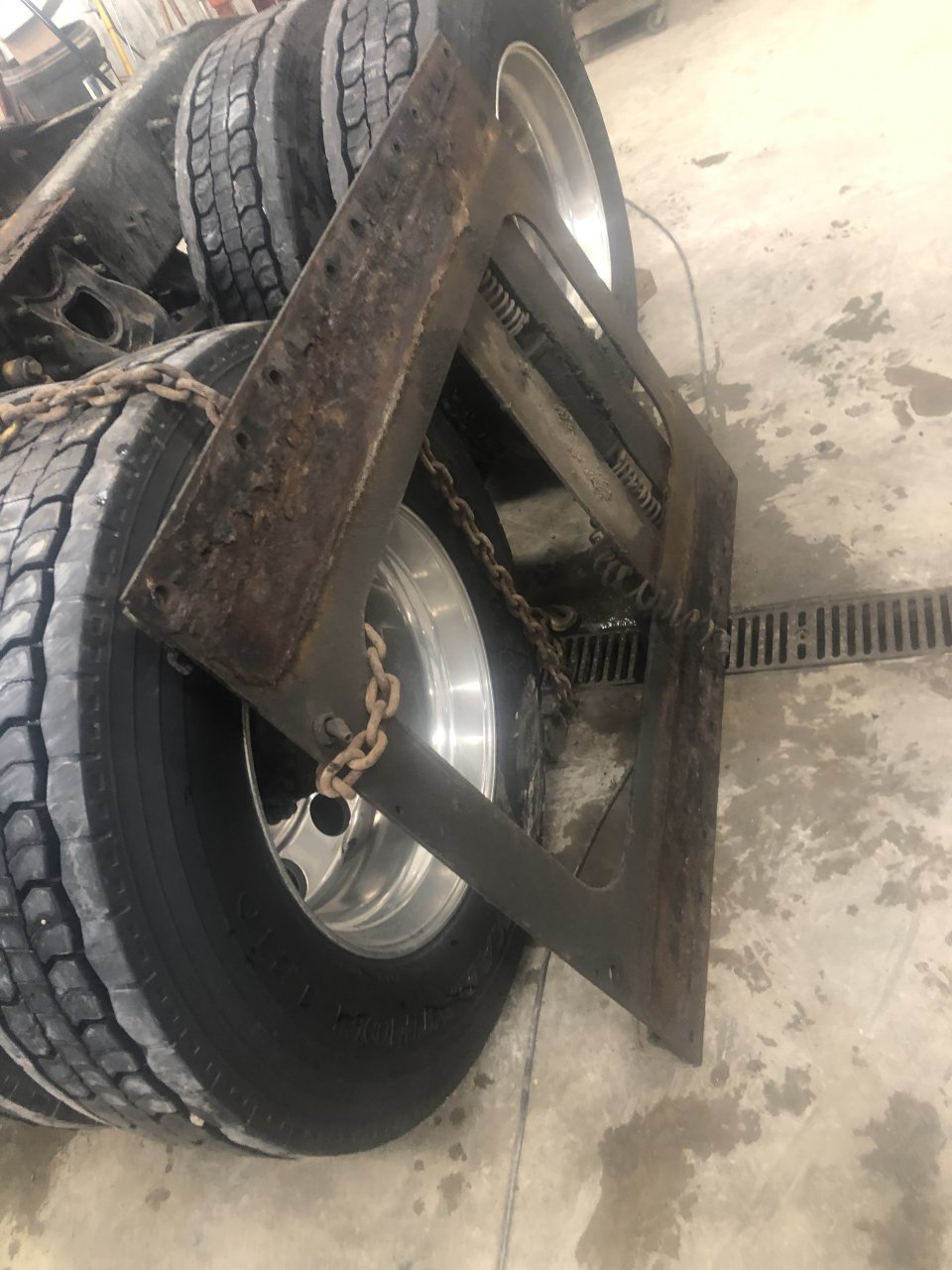

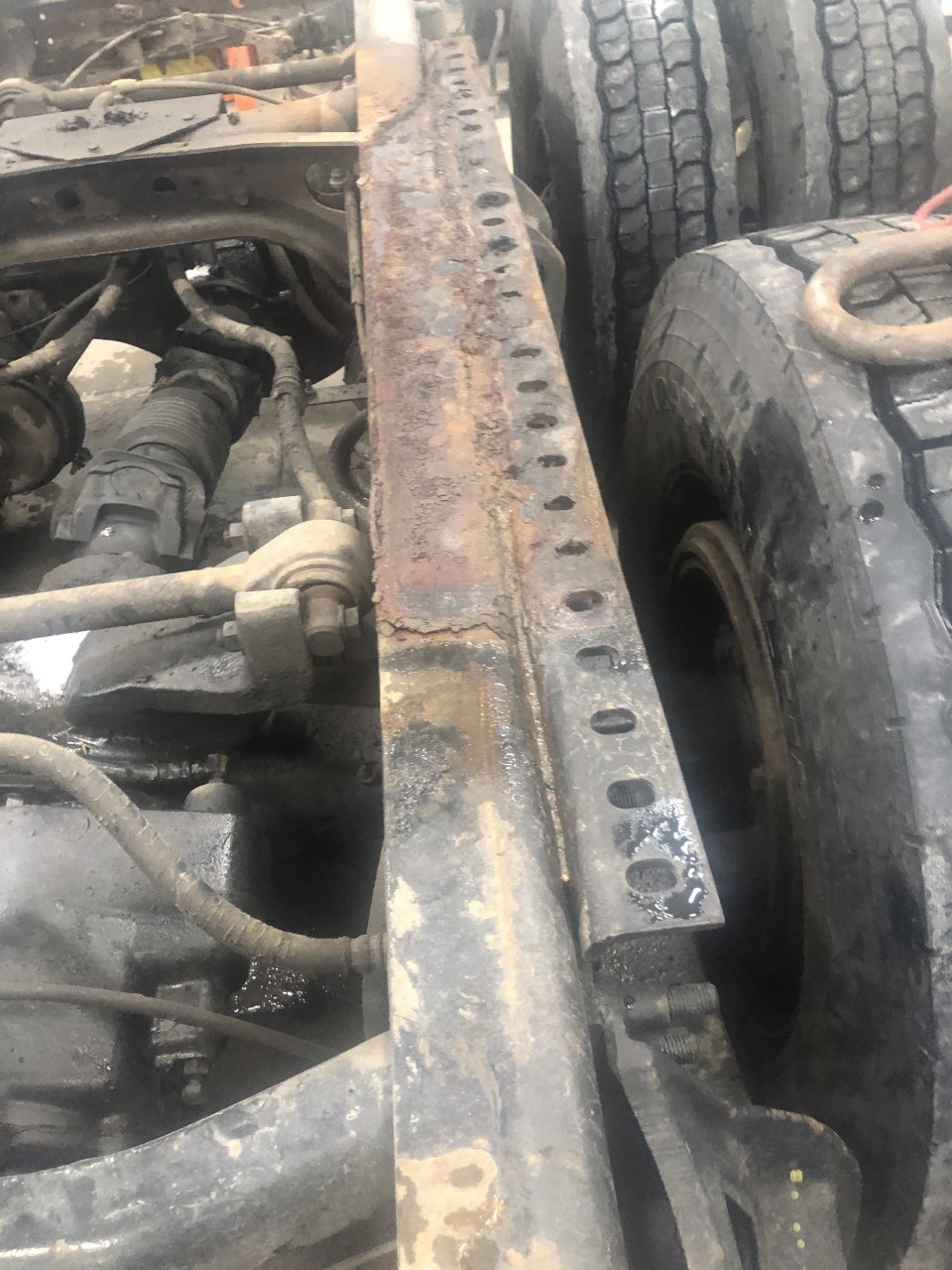

    The old rails under the slider were better than I expected but the underside of the of the slider is shot.
    New peals tool on order for the new rails. 5D6D1E30-3B40-42A8-A540-273354D7B8EC.jpeg A1C11131-48DA-4781-A7DA-7FAA97456D9C.jpeg E6505657-BF57-453C-B138-99D1863B9608.jpeg
  11. Ezrider_48501
    Ezrider_48501 Road Train Member
    3,845
    5,135
    Apr 2, 2011
    bismarck, nd
